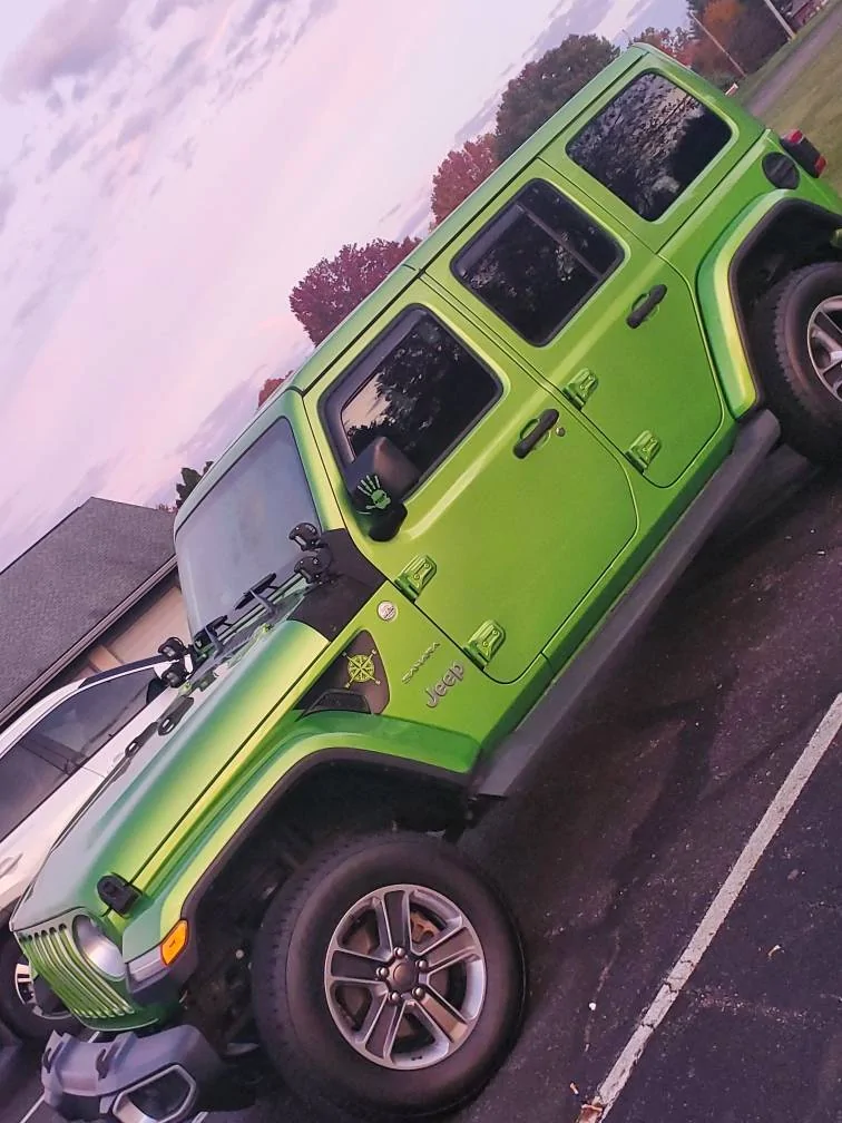

Thanks for all the info you provided there.
2019 Jeep Wrangler Sahara
60k miles ( first issue when purchased was at 47k)
They are just stock Sahara 255/70/18 Rims/AT Tires. Nothing aggressive or big. Completely stock. The Jeep is 100% stock other than the very small lift/dual stabilizer. That lift is actually barely noticeable. Thats, why I was shocked when I was told it even had them in it. So, its not like we have a monster lift with 35s or bigger on it.
The dual steering stabilizer is a Rough Country Dual kit.
We just put this on because it was an inexpensive part to put on and the fix that happened when the dealer replaced it the first time with one. We were hoping for a similar result.
Control arms are stock.
The Jeep actually handles incredibly, other than the intermittent episodes it gets over bumps. No veering, hard to handle, straight down the road like you would expect.
Thankfully enough, I'm mechanically capable from that stand point. I just don't wrench as often as I used to, and as I get older, its much easier to pay the man than do it myself. Lol. Also, thankfully, we don't have a lot invested in Labor costs.... its the darn parts are so expensive. haha.
I did read somewhere, where someone said the farther you deviate from stock, the harder it is going to be to find the issue. Thats why we haven't done anything excessive for that reason. Made sense I guess.
The pic is merely to show the tires don't look small with that lift on it.
Again, Thanks for all the help. Just trying to narrow down possibilities.... Without breaking the bank some more chasing what feels to be a ghost. This is fixable right? 🤦‍♂️
