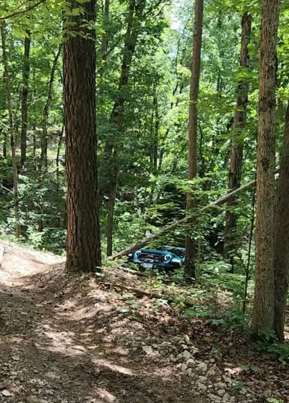

Without lockers 3.45 gears and 285s, in ruts, and with a rock on the right i couldn't get over this is how I got stuck. Hard to see how steep it was but it was a pretty steep hill. Excited to see how it performs now on 37s with 4.56s and lockers.

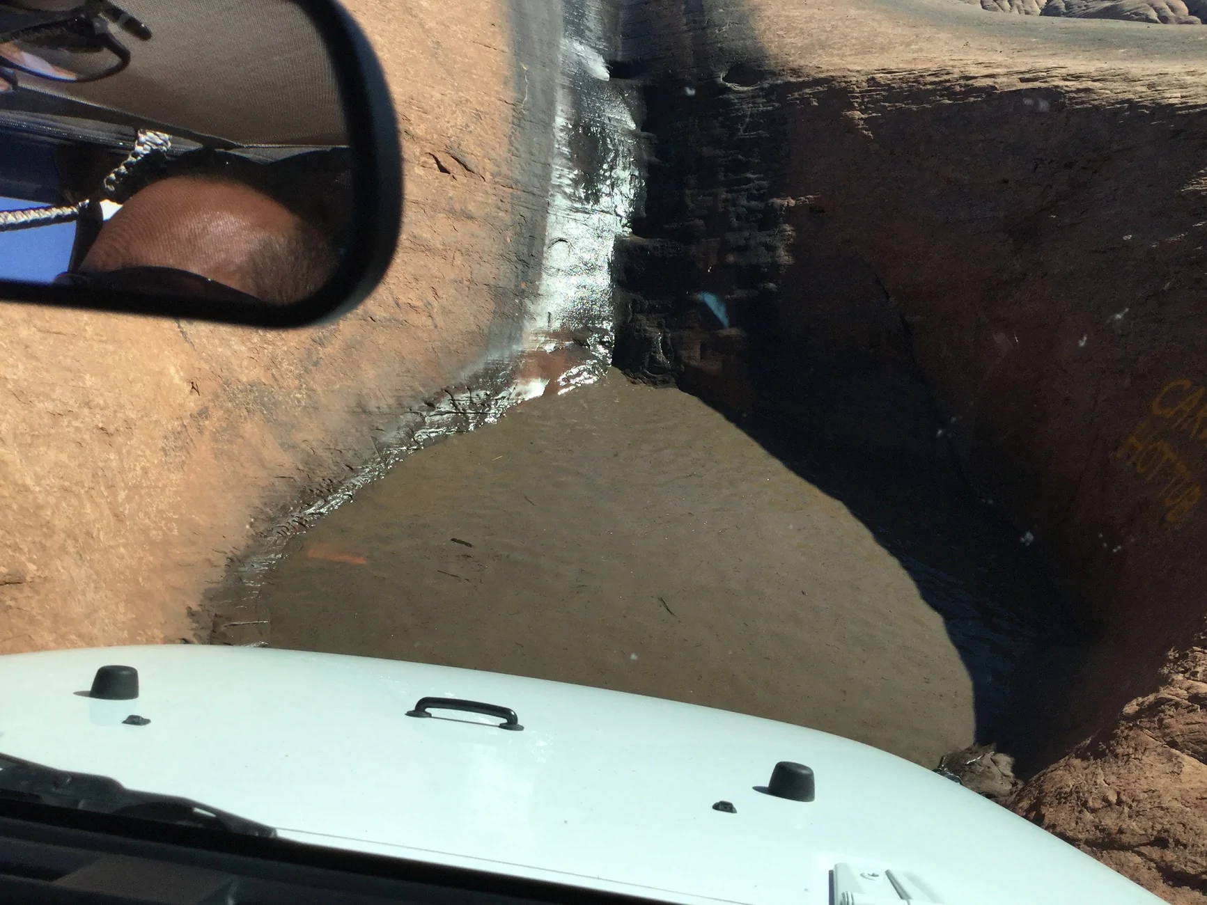

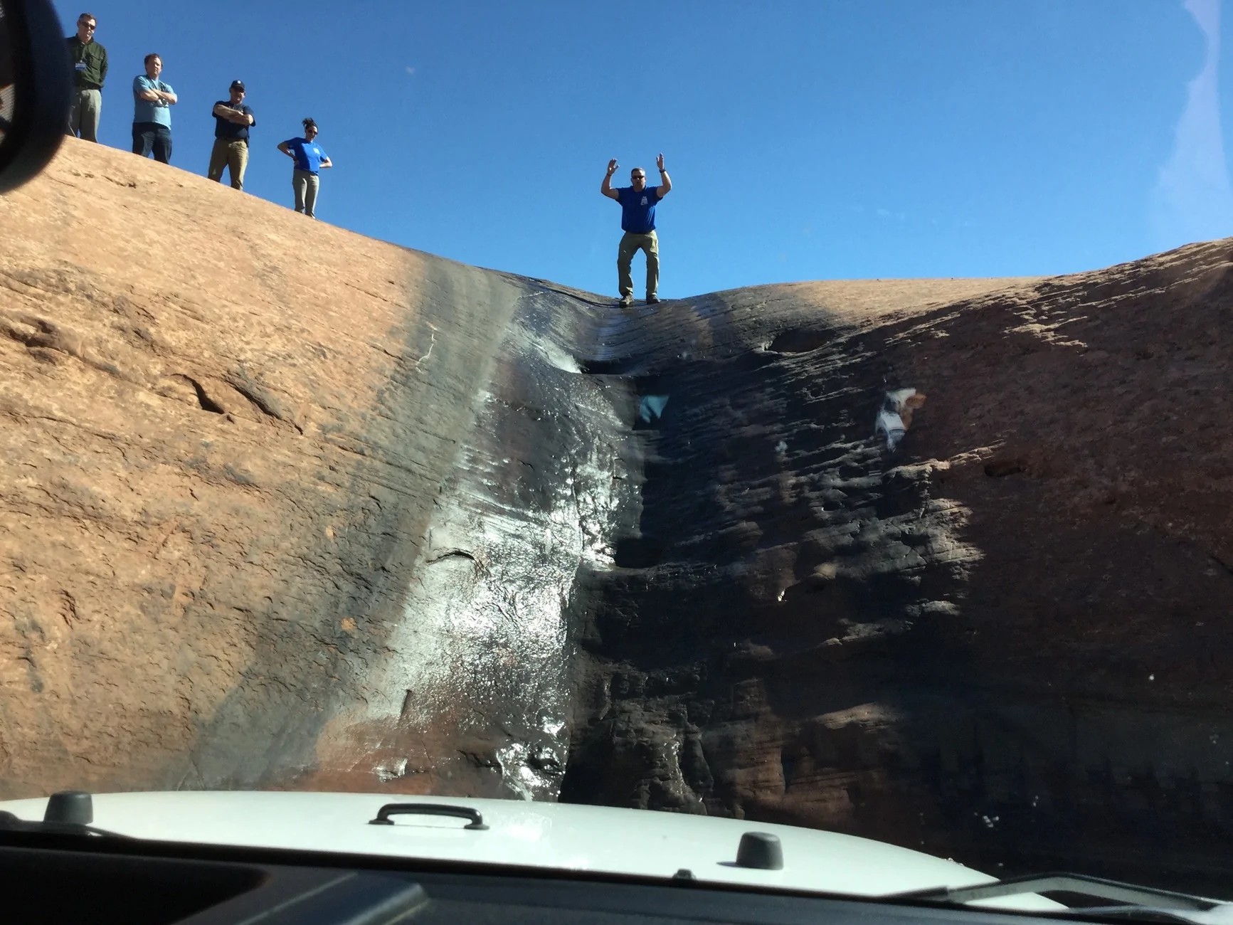

This was driving out of one of the hot tubs in MOAB years ago. Only had rear locker but no locker jeeps drove out just fine

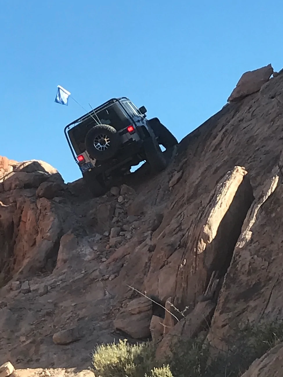

This is in logandale trails outside of Vegas. No lockers needed. I even saw a Tacoma make this hill (little bit of drama and scraping but drove out the other end).
Hit the trails with a club or friends to learn what you machine can do. They are impressively capable.

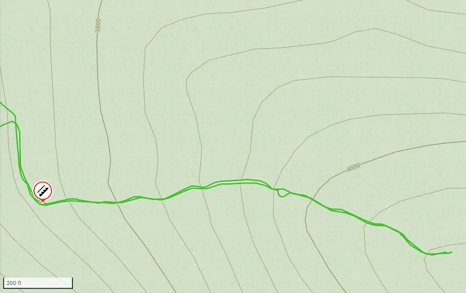

Really depends on the traction surface. Moab and Sand Hallow have very steep climbs that are easy. Attached is a track of one of the steepest forest trails I've done. It's approximately 1000 ft long with almost 300-foot elevation gain.

I get it but I don't completely agree with you. On a perfectly flat steep surface, I would agree. But in the real world we climb bumpy surfaces that might cause the suspension to unload causing loss of traction on a tire. With open diffs, the transfer of torque to the spinning tire would immediately cause loss of momentum and probably a failed climb.
Yep this is what kept happening to me on the hill in my photo. There was a rock jetting out from the right and you had to bounce over it but every time I hit it my drive wheels would come off the ground and as soon as the jeep settled back down itd just spin in the loose dirt. I would have kept trying but after two times my six year old was pretty terrified so we conceded and winched up over to where the hill tapers off and its easy to just drive the trail again.
