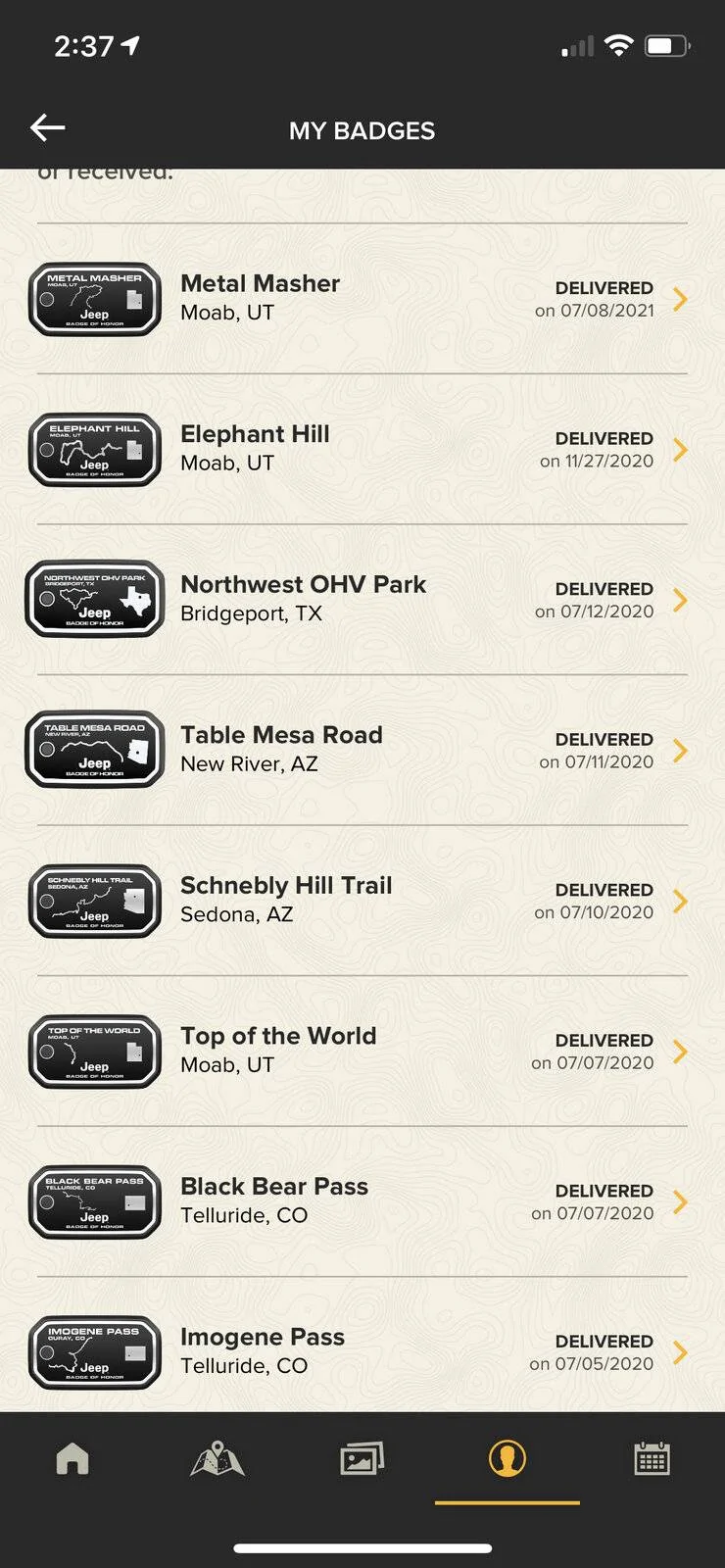

Excellent.
I guess the Rubicon Trail and Black Bear Pass are next. Remember to post pictures.
LOL black bear pass isnt even hard. Gold Mountain is way harder. The Rubicon trail is totally doable, just too long for me rnow.
Seriously dude stop posting crap you dont know. Go out wheeling.
