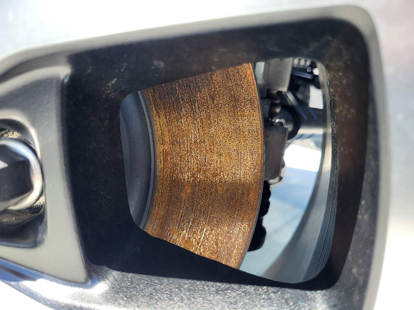

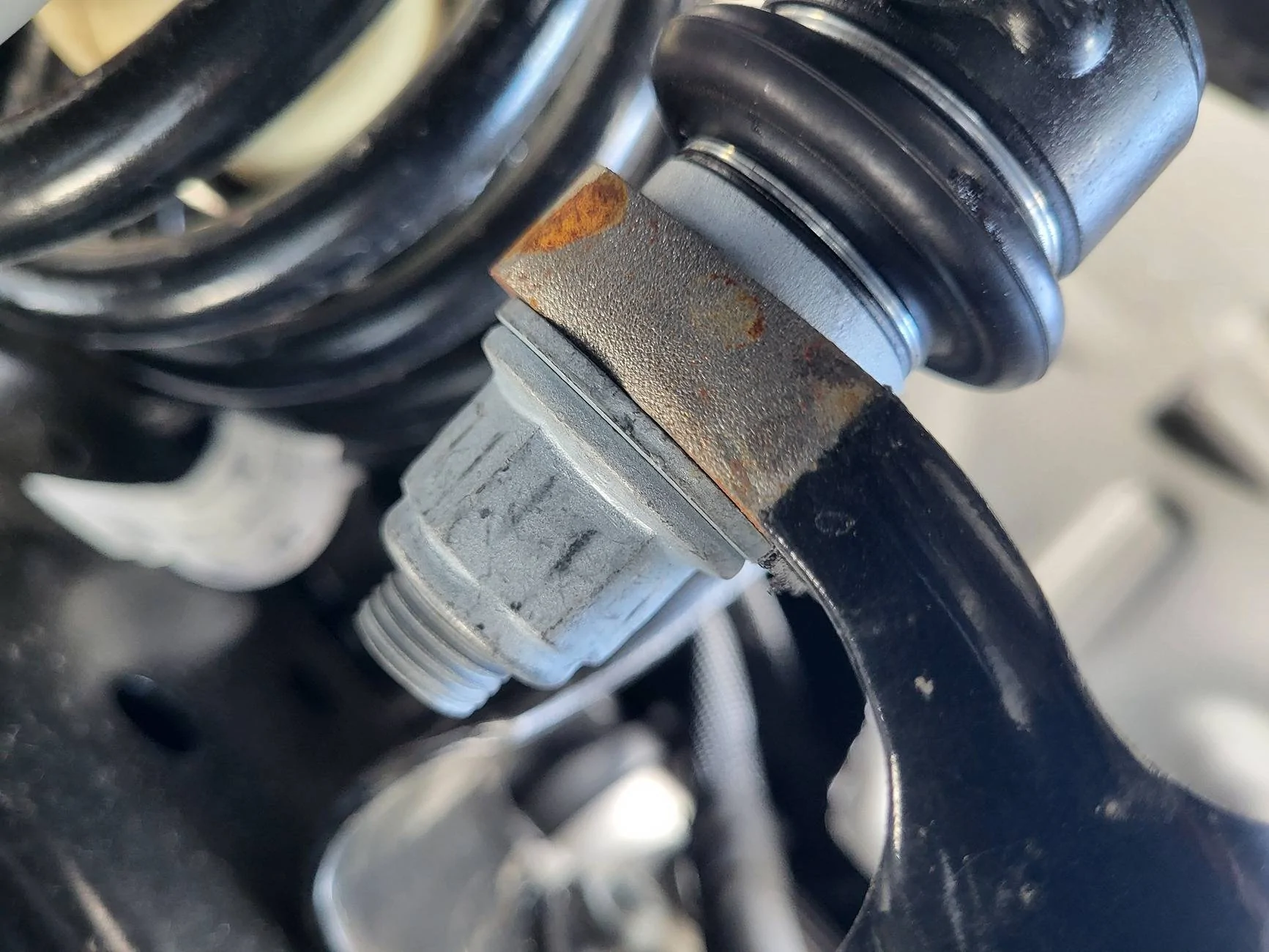

I'm narrowing my shopping down to a few 2025 Wranglers right now. One of the Wranglers I looked at had more surface rust than the others. Here's what I noticed:

I looked at some other Wranglers and hardly saw any rust at all in these same spots, so I thought I'd ask.

I wouldn't worry about flash rust on rotors, as pictured, because it will dissipate or disappear after the first proper drive.
As for rust on other parts of the vehicle's underside, that could be an indicator of how long it's been sitting on the dealer's lot. I'd have to see it, and make a judgement call.

It all looks superficial in the pics. Easily fixed by using the brakes or a quick rub with a wire brush and applying some Fluid Film to anything metal. I recommend that regardless of condition. I've gone 4 years on heavily salted roads and a bunch of visits to the Bonneville Salt Flats and I'm surprised how rust free it is down there. Fluid Film works.
It does indicate a possible indirect problem though. To get that amount of superficial rust it likely sat on the dealer lot for a long time. That's really hard on the batteries and significantly shortens their lifespan.

normal..back in 2012 or so I contacted Dana Spicer about the amount of rust on my new JK Dana 44's and they said that was by design and it was actually surface rust that prevented deeper rust...

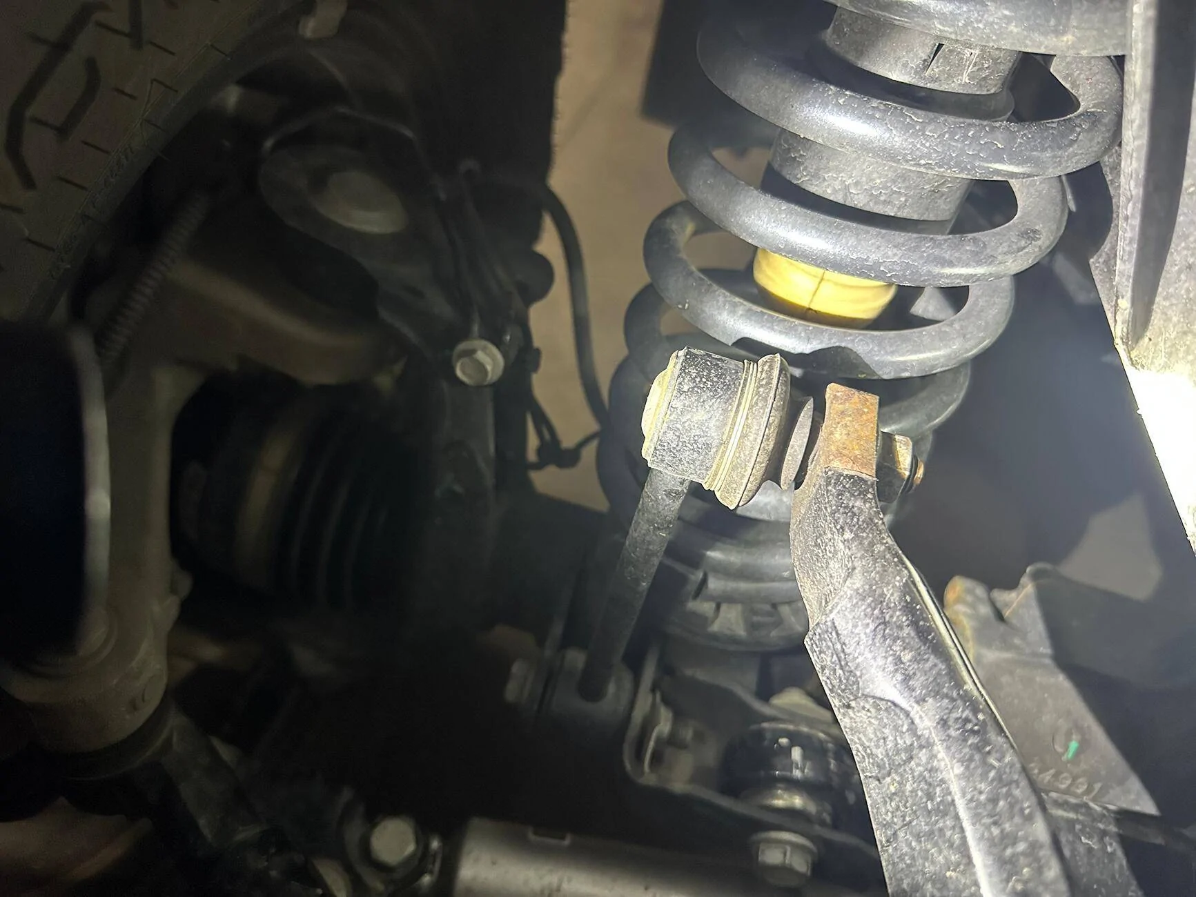

yes I believe them. reputable company..and every single new rubicon i have looked at has rust on the undersides especially the ends of the front swaybar links. my buddy and I both have Jan build dates mine the 17th his the 18th we both picked them up in Feb as they were unloaded at the dealership and both were the same..look at how the ends are on the rubicon and tell me that is not going to rust in a day...they have a defined line where there is no coating..
