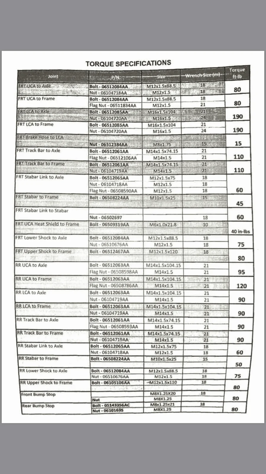

Just to make sure, you tighten to 100 ft lbs instead of 190 that is called by Jeep right? I think that's what it says in the attachment.
Jeep Wrangler JL Steering wheel  play..how much is "normal" 654CFAED-591F-45B6-9EE4-8AE810C65706
Im not sure what torque I put on those bolts. Its gotta be past 100. I loosened them so that the tension would free up and allow for slight movement forward and backwards. I have noticed though that after doing so I can hear the control arms clicking when I go over bumps. I have been meaning to have them tightened down more then I can with brute force. I just have not done it yet because it doesnt bother me enough to go out of my way and I also plan on moving to adjustable control arms sooner then later anyways.
