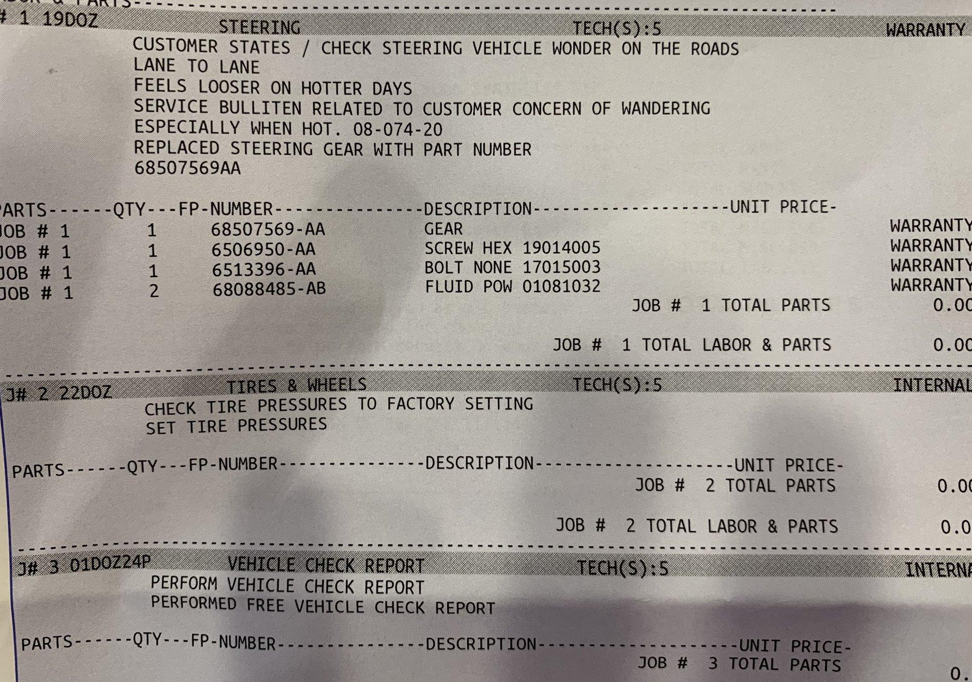

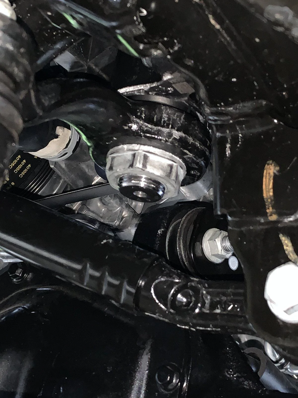

Ok, got my ‘20 JLU back today after getting the new steering gear... this is the way it is supposed to drive. Jeep follows the road, drives different than IFS, as expected. But it is 100% better than it was when we drove it off the lot. Believe it or not, when we turn the wheel, the Jeep turns. And funny enough, when we don’t turn the wheel, the Jeep doesn’t turn! Looking forward to many happy years behind the wheel and not swerving into oncoming traffic. (Really hard to get pics of this part)
