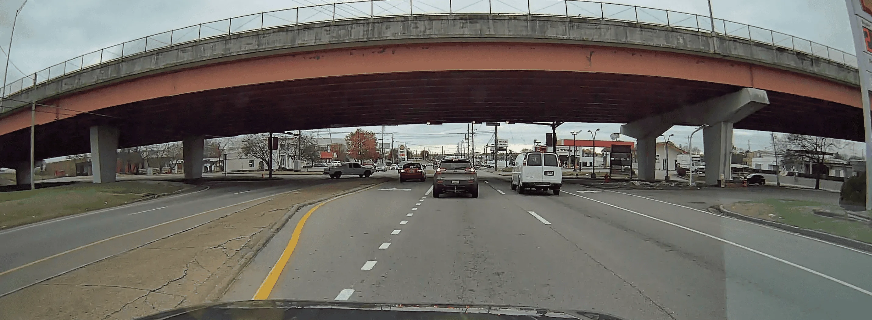

Look at that corrosion on the bridge - the Jeep AI is warning you to start taking a different route!

Every day when I go under this specific bridge (in either direction), the dash turns red, Brake! flashes and it beeps. Today however, the Jeep locked up the brakes for me. Almost got hit as a result, wasn't that thrilled with the experience, and the guy behind me had some choice gestures to share (which I don't blame him at all).
Does anyone know what the Jeep uses to make the decision that you are about to hit something? And does anyone see anything about this particular bridge that would set it off? The system does work, it has beeped when I'm using the adaptive cruise control and people decide to change lanes for no reason. But it has never actually stopped the vehicle. And it beeps every time I go under this bridge.
Now I'm scared of it, can it just lock up the brakes going down the highway because it sees a bird it doesn't like or something?
Thanks!
-Byron

Yes, it's always that spot. Either North or Southbound lanes both trigger it. It's never gone off anywhere else that wasn't justified. That's why I was thinking it could be something in or part of the bridge. Good point with the reflections though, I've never been through there at night.
My GMC truck does the same occasionally when sunlight reflects off a car in front of me, seems to be when cresting a hill mostly.
Hard to replicate consistently.
