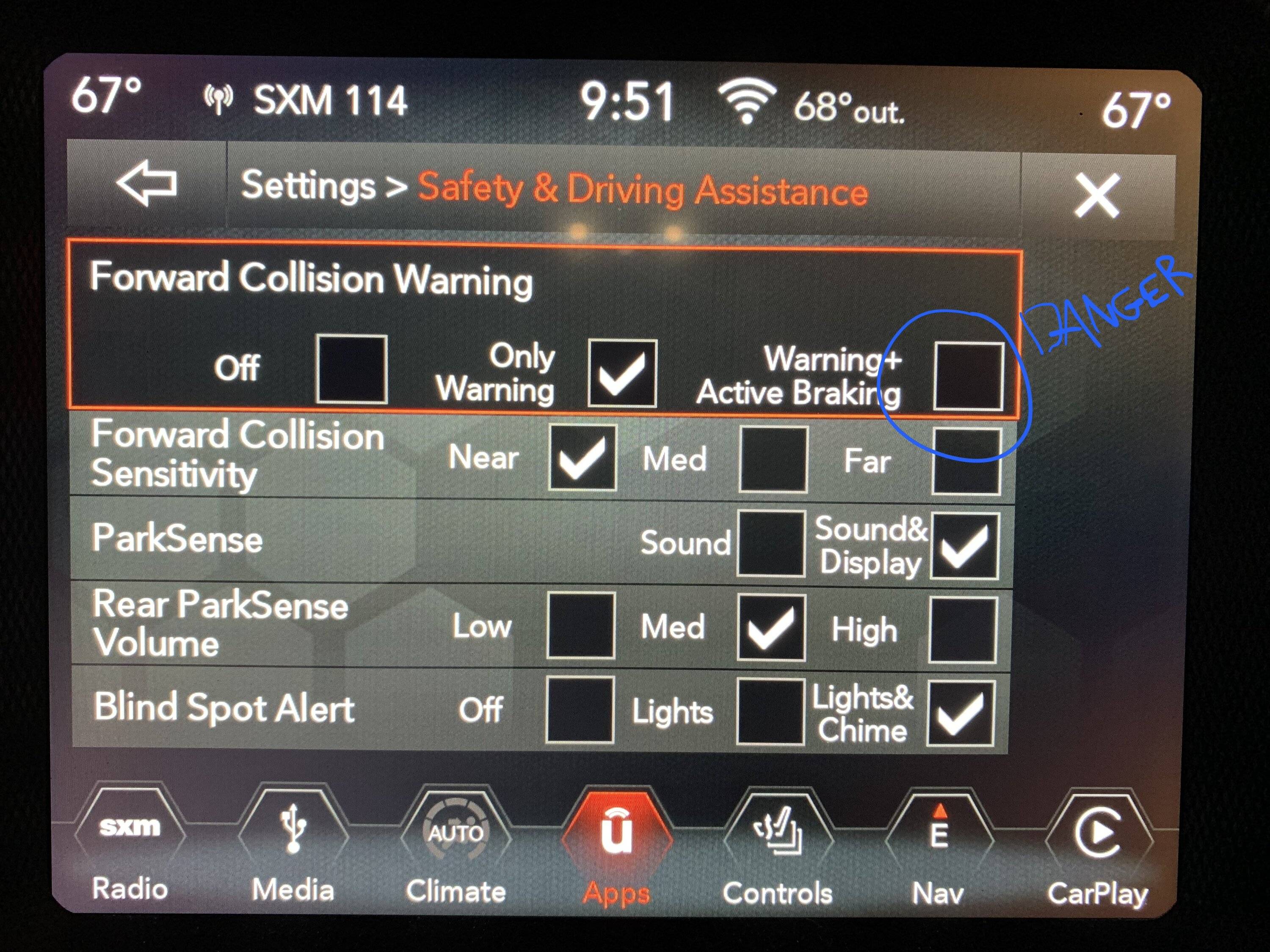

Yes! you can adjust it through UConnect, which I didn't know until just now. You can adjust sensitivity, turn it all the way off or just set it to beep without applying the brakes. I'm excited because this thing is dangerous!
Can you please tell me/us what settings you found this feature set at, before you change the settings for it?
Also, if you keep that video on youtube, may I suggest adding remarks there to say what year and trim you have, the fact that it was stock, and what the option and settings were that caused the braking, and what you did that fixed it? That's so guys like me who stumble upon such "silent" videos (and there are many of them on YT) can read and learn.
Absolutely! In Apps, Settings, Safety & Driving Assistance on the UConnect. I have the 8.4" but I would think the other ones are similar. It's Forward Collision Warning and Sensitivity. I just found these settings thanks to @Mx5red and adjusted but haven't tested them yet.
I'm not here to tell people what to do with their own vehicles, but I would encourage everyone to look into this thing and make an educated choice. Yeah it might stop you from running into someone else. Or just pay attention to where you're going, turn this death trap off and keep yourself from getting rear-ended. Just want you to see what happens. Beep then total lockup. @Vinman had them lock up at speed, I was just going about 10. Crazy.
