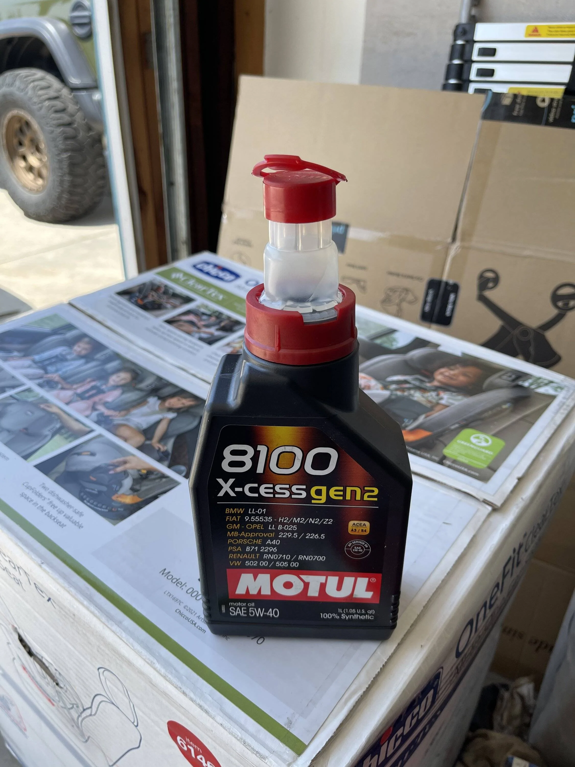

Nope. Done with that bullshit.
Before using Hot Shots, I tried Archoil. I switched to Hot Shots for some reason, I don't remember.
But, I kept the Archoil bottle because it has a long neck and is a squeeze/graduated bottle so I can measure out how much I need.
I just refill this bottle with Hot Shots and keep it in a zip lock bag in the rear storage.
It hasn't leaked in the 1-1/2 years I've had it.
You can find many additive products with bottles like this.

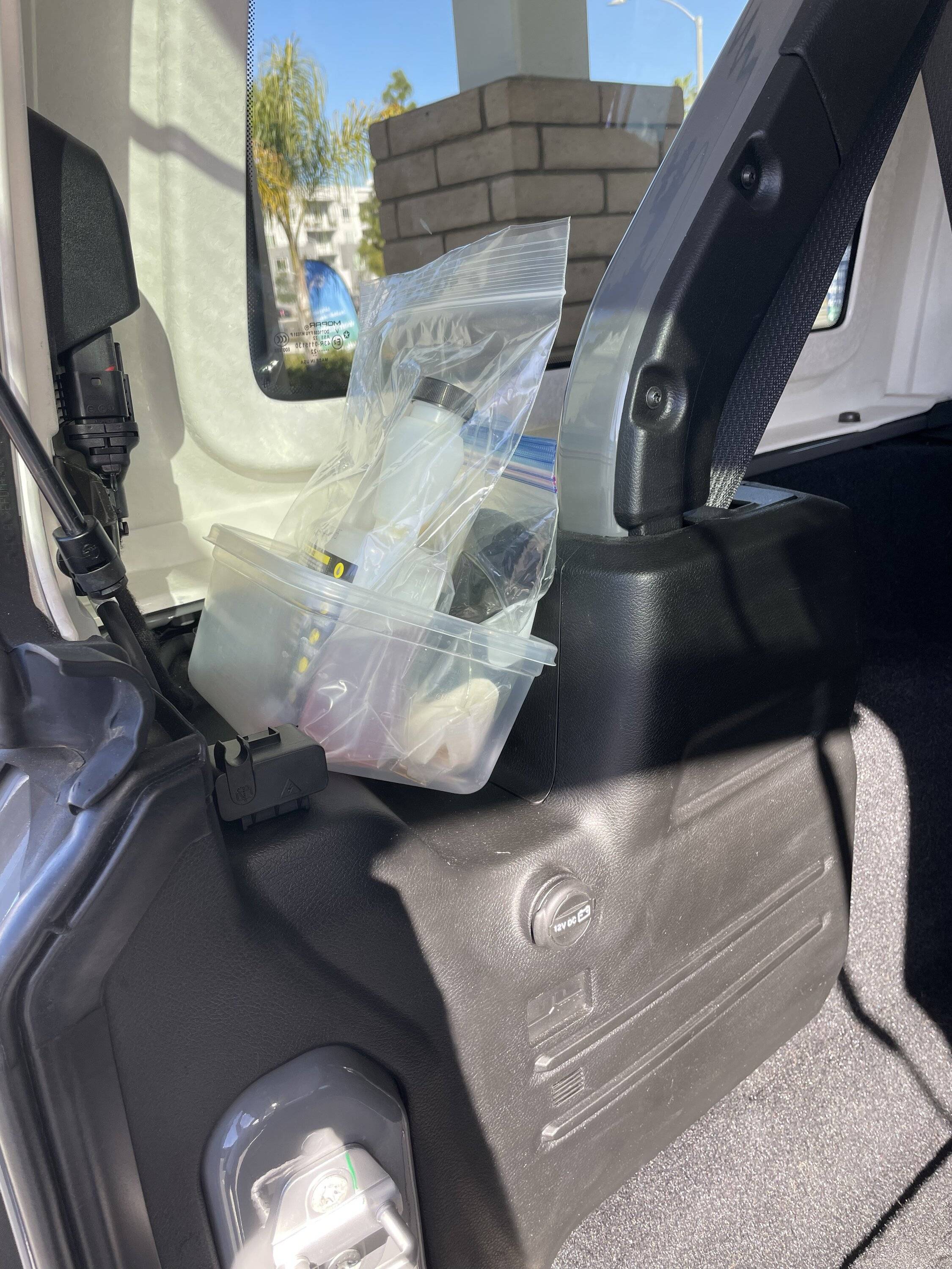

I like it. I just did ziplocks in a ziplock Tupperware. It also fits nicely here so it’s upright. But I have hard top always on.

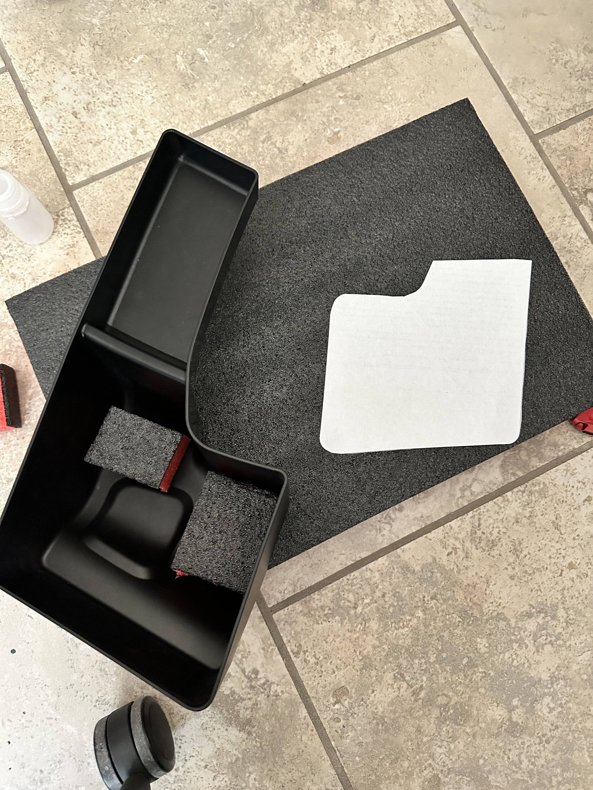

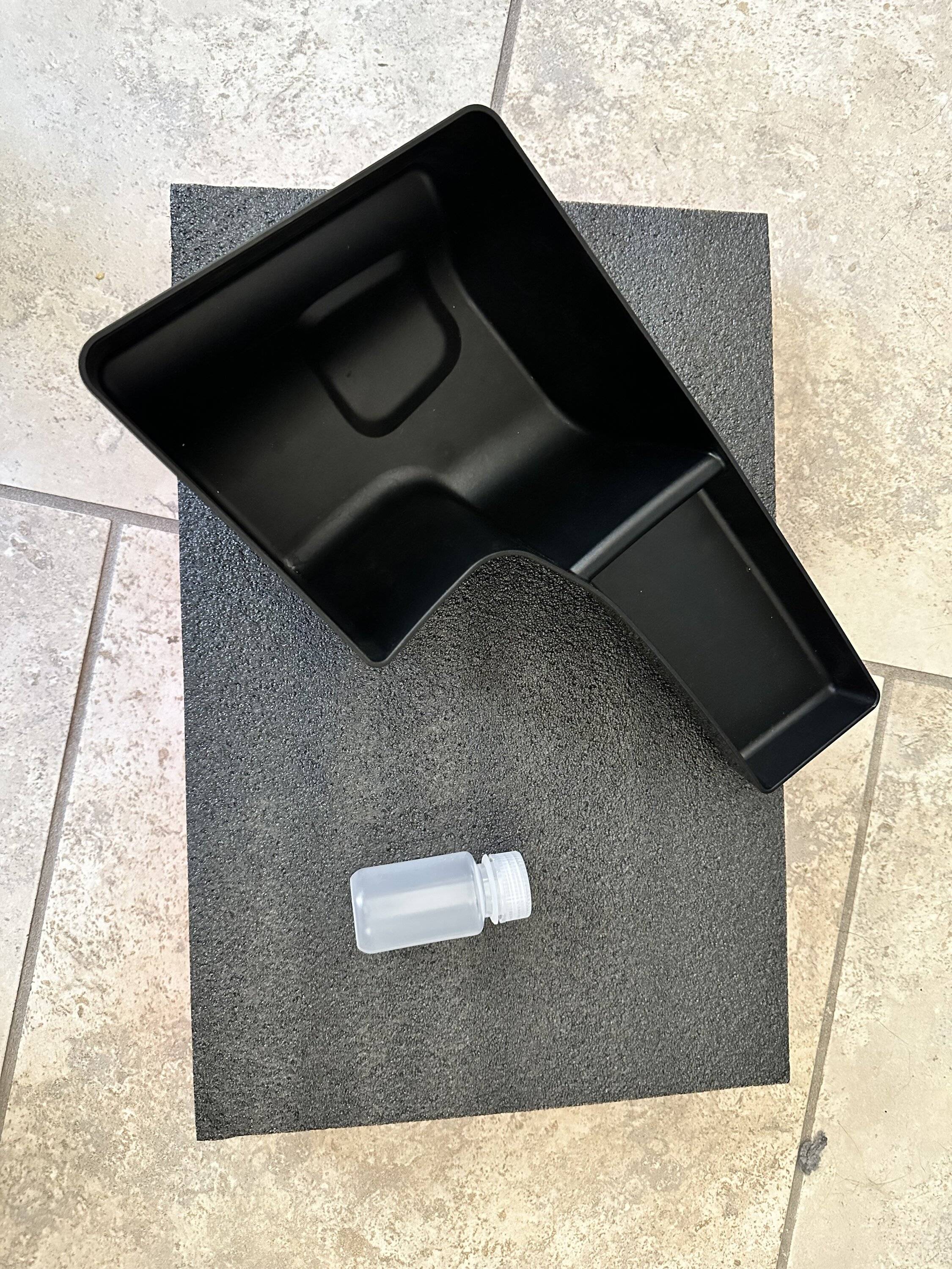

Created my own little storage box with plastic bins, toolbox foam and laboratory grade reagent bottles.
Bottles
https://www.amazon.com/dp/B00ES3THJK?psc=1&ref=ppx_yo2ov_dt_b_product_details
Bin
https://www.amazon.com/dp/B08N13BWJ1?psc=1&ref=ppx_yo2ov_dt_b_product_details
Toolbox Foam
https://www.amazon.com/dp/B09J5FX5VQ?psc=1&ref=ppx_yo2ov_dt_b_product_details
Jeep Wrangler JL Hot Shots EDT leaky bottle solution IMG_1674
Jeep Wrangler JL Hot Shots EDT leaky bottle solution IMG_1675
I cut a couple of small blocks to space the shadow box foam to the top of the bin. I attached these using 3M automotive tape. I created a paper template for the area of the bin I wanted to fill.

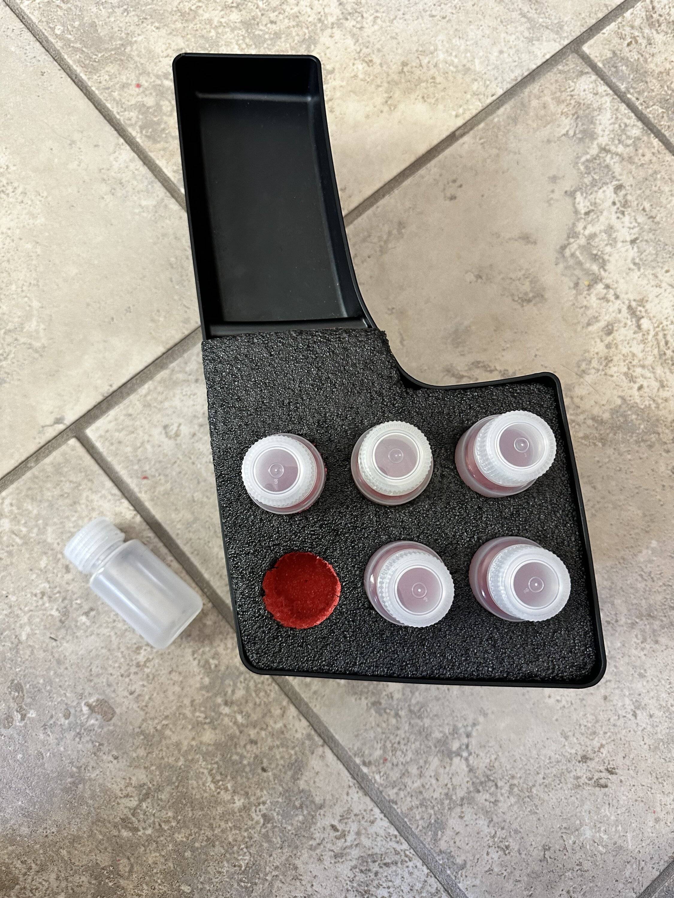

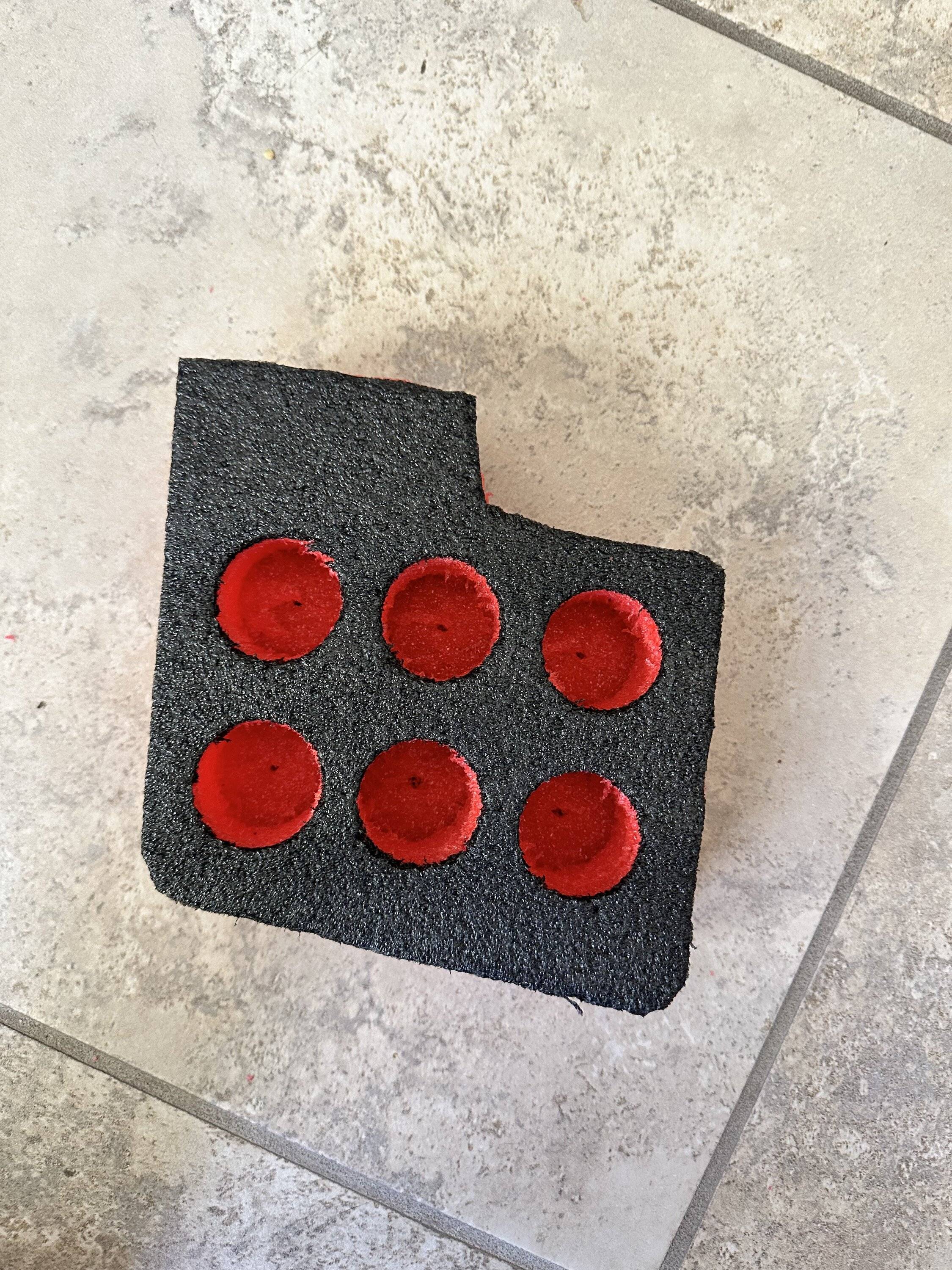

I used a sharp razor blade to cut out of the foam (you could use a hot knife if you have one, I don't). I used a 1.5 inch hole saw to cut the holes. I drilled these out on concerted to I wouldn't go all the way through. I wanted to make sure there was a base for the bottles to sit flush on. You'll want to make sure to clean out the holes as you go because the foam pieces build up and clog up the bit.
Jeep Wrangler JL Hot Shots EDT leaky bottle solution IMG_1679

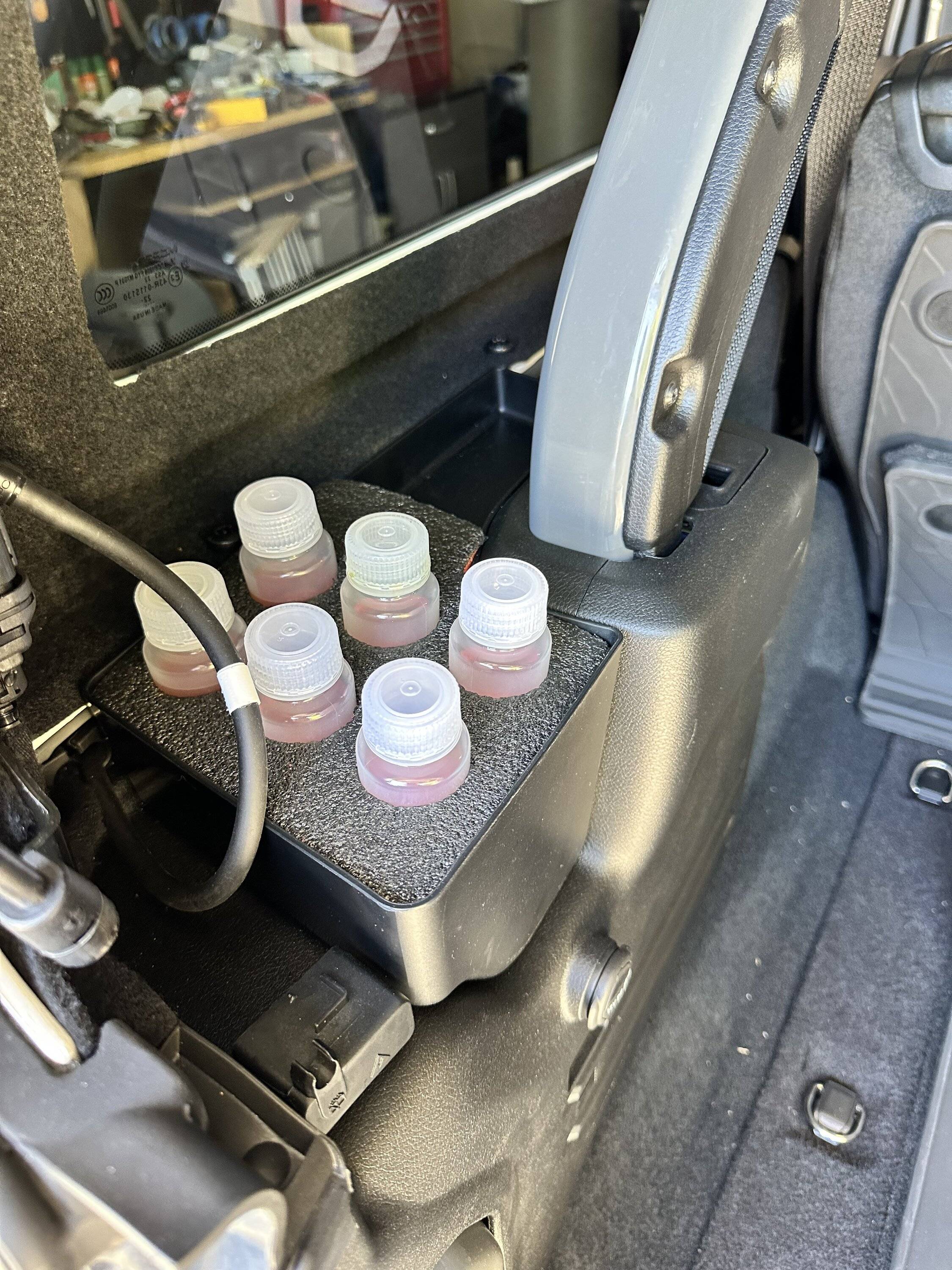

I installed the foam into the bin. Because of the way I cut it the compression of the foam is more than adequate to hold it into the bin.
These are 4oz. bottles so I fill each halfway full. I have some alcohol wipes in the storage tub and wipe them down after use to (hopefully) keep the smell out of the cargo area.
I just installed this today so the jury is out on longevity of the bottles and the foam but I'll see how this setup holds up. I hate the stupid leaky EDT bottle like the rest of you!

Wow! That’s an amazing setup!
