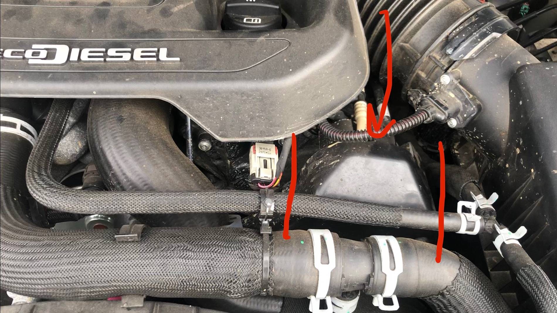

So I also had this issue, as of right now after clearing the code and been driving it just shy of 50 miles about an hour ride, mixed some minor highway in there for a bit of about 70/75 mph driving and so far code has not come back on yet! I use hotshot and first thing I did was refill (as suggested) at half thank cause I might of been putting in too much and the mixture might of not been right, then replaced both air and fuel filters. The only issue I’m concerned with is that the code was due to the fuel pump maybe bout to fail?? I’ve been keeping an eye on it and it seems to be very hot to the touch, there is a plastic cover on around it and you can’t really keep your hand on there long cause it’s that hot, is this normal?? I’ve read of people reporting clicking or ticking sound etc as potential sign of issues but it sounds normal just extremely hot to the touch
