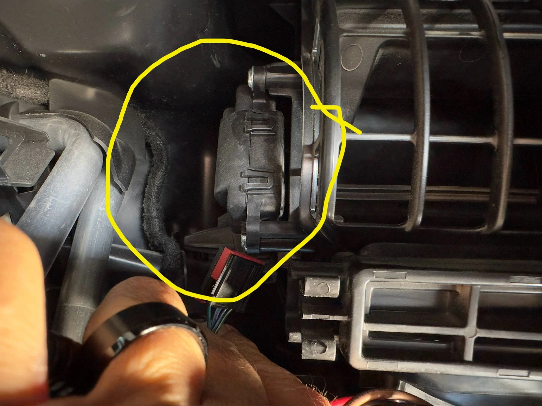

It’s not hard to get to, right behind the glovebox it’s the connector that you can see on the left side. I can get a pic if you want.
Yes, if you don't mind, please post a picture so everyone knows where to find this. My AC is ice cold but that could change I would like to know where it is too. Thank you, my friend.
it’s a small 5 wire plug on the left side of this plastic grid/mesh. Connected at the bottom.
