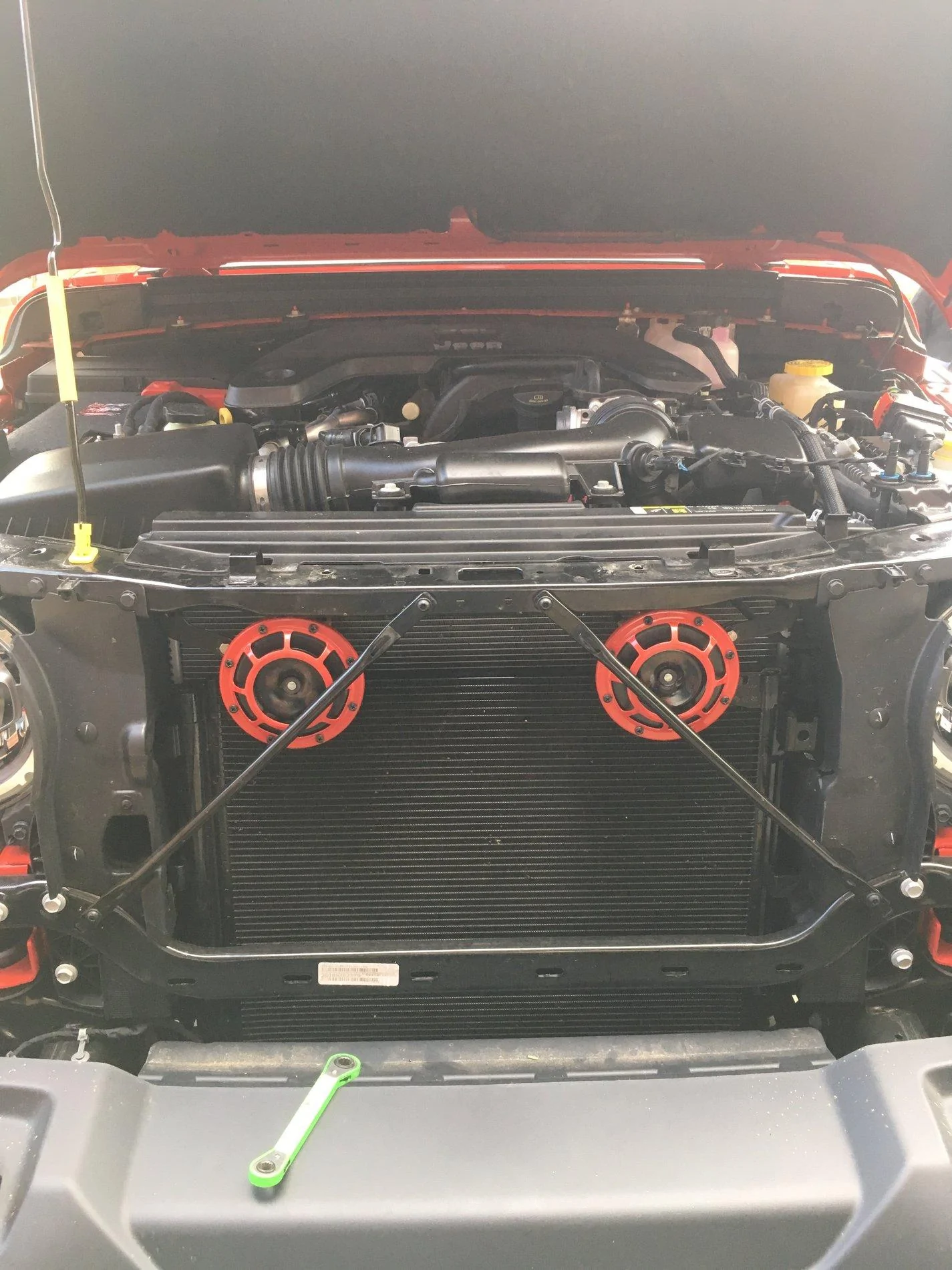

Might be able to gain adequate access by just tipping the grill forward, but at that point it's basically removed anyway.
It's six or eight push-in clips along the top of the grill that you remove, give the top of the grill a tug forward to disengage it. Disconnect the camera cable and camera washer line (if so equipped) and then just lift the grill out. It has tabs along the bottom that just press into some slots.

We’re replacing my horns now! Can’t figure out how to completely disconnect the oem horn? The red button isn’t enough to fully remove it. We’ll likely cut the wire and then splice in the new one.
