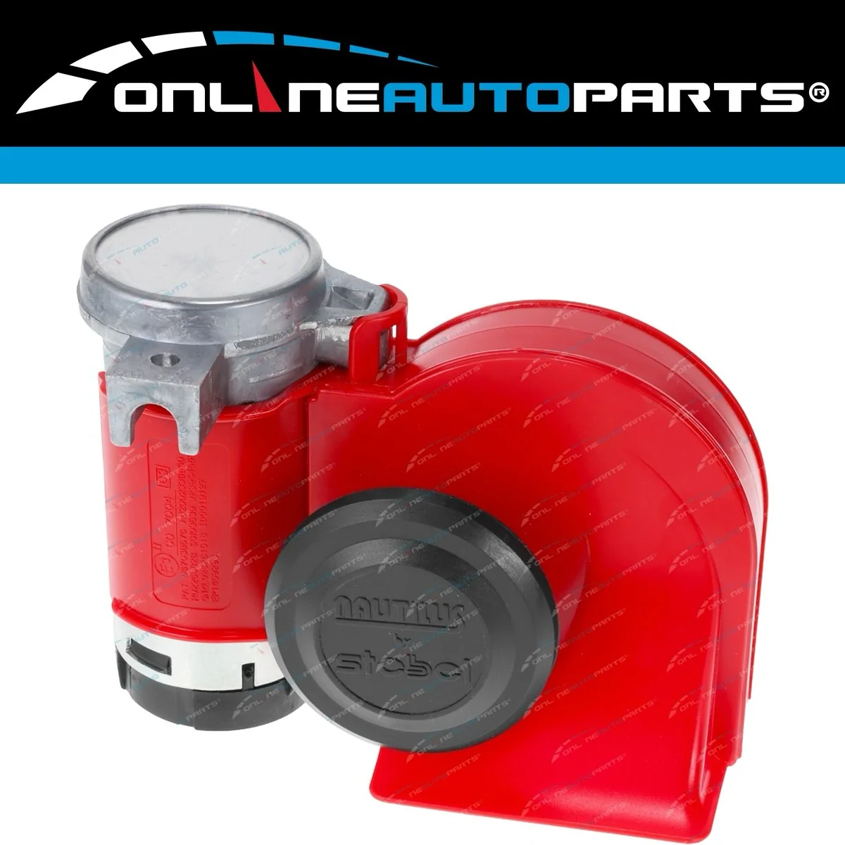

The OP asked for a plug-and-play recommendation.
While train horns and the Stebel compact air horn are loud, they also draw a lot of current. They require thicker gauge wiring harnesses, with relays, to power them safely. Connecting such horns directly to the thin OEM horn wires will melt them, sooner rather than later.

I had a compact Stebel Nautilus air horn on a now-sold motorcycle. While the installation required a spendy relay harness and a pinch of fabrication, the effort was indeed worth it. That horn was used to wake up several inattentive drivers during its tenure on the bike.
That horn wasn't the panacea that I was expecting, though. Its sheer volume would cause some of the offending drivers to look around, but not at me. They must have thought that such a sound couldn't have come from a motorcycle. That was an interesting side effect.
