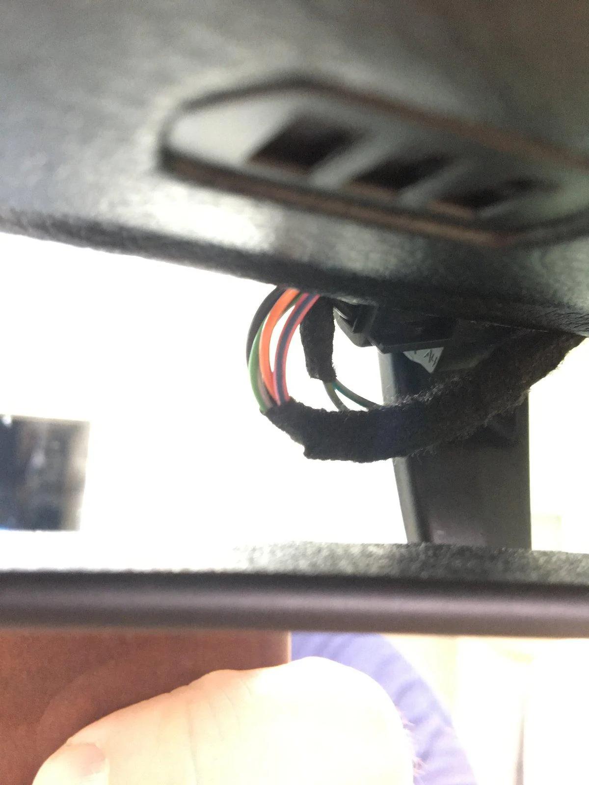

Hello all. First post here with my 3 day old JL 2 door. I have the Sport S with technology and Safety packages but NO homelink buttons. I appear to have the homelink button wires (I think), but I am not sure where they end. I pulled the above door panel off as well as unfastened the above the windshield one as seen in the photo. As you can see, there are these wires directly above the mirror. Does anyone know what they are for and if they could be tapped into for a radar detector or camera?
