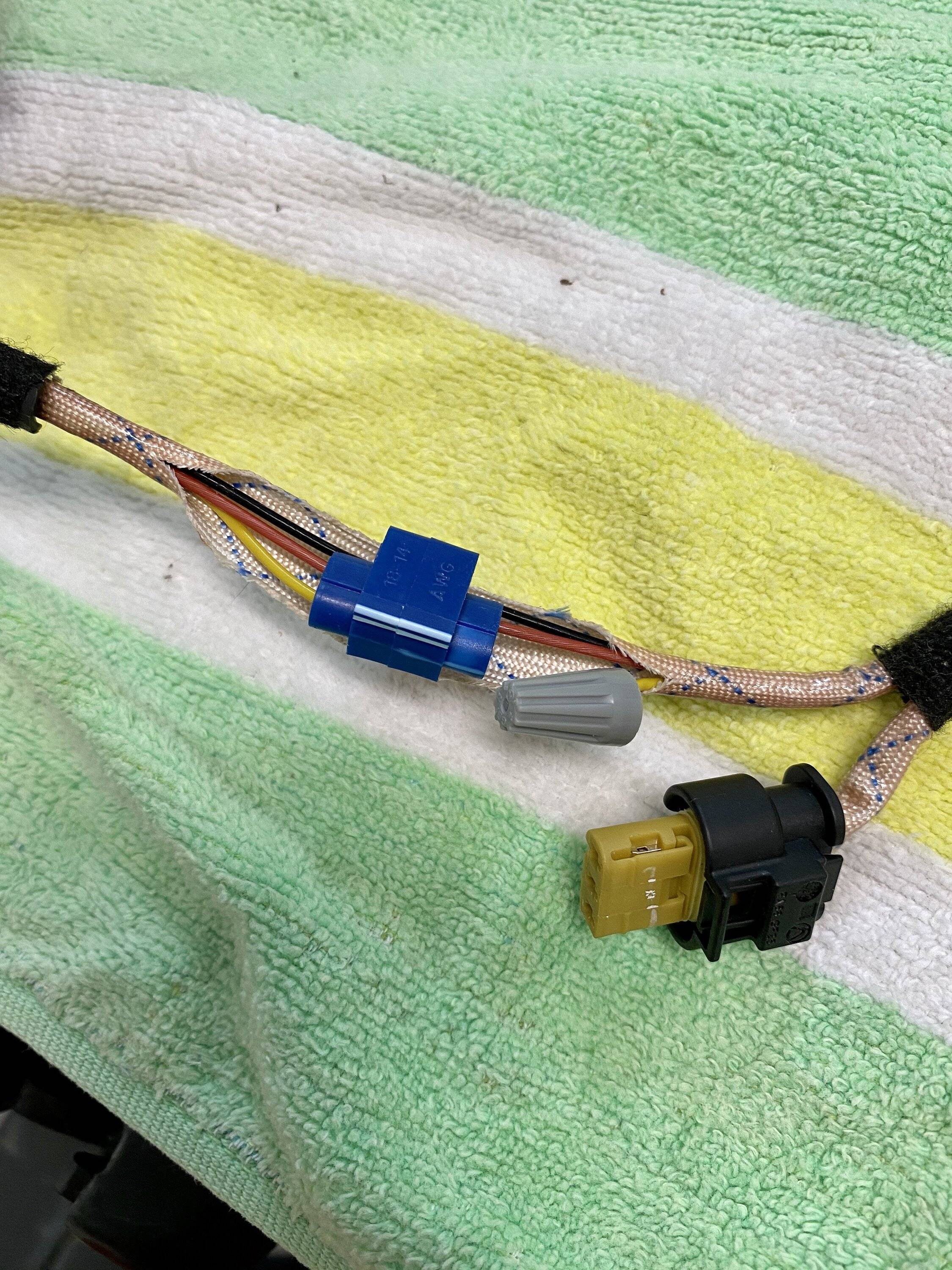

Make sure the yellow is capped off going to the plug on the Jeep. Yellow is pulling power from red wire and only goes to the visor. You do not want it feeding power back to plug. Like this pic

i looked at the plug it did even have the yellow just the red and black that was with my jeep the visor had the three wires y r blk i cut the yellow and soldered it to the red and taped it up but oem plug on my jeep only had red and blk
You should be fine then. Do the reset on the Homelink then set to your garage. I don’t remember the reset procedure, sorry
