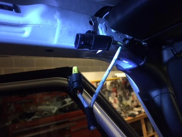

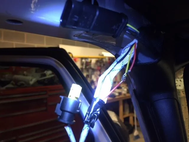

But, I hate the fact that the ignition has to be on to operate the Homelink garage door opener.
Being that I will never park my Jeep right outside of my garage I rewired it to always be on.
Pretty simple and reversible 5 minute fix with the yellow wire military spliced into the red wire on the visor. You have to clip the yellow wire and attach the visor end to the red wire. This splice is reversible and very secure. Insulate the unsused yellow end and rewrap with tape.
The crazy part is many years ago I did just the opposite fix so no one could use the opener with the key off, for security reasons.
