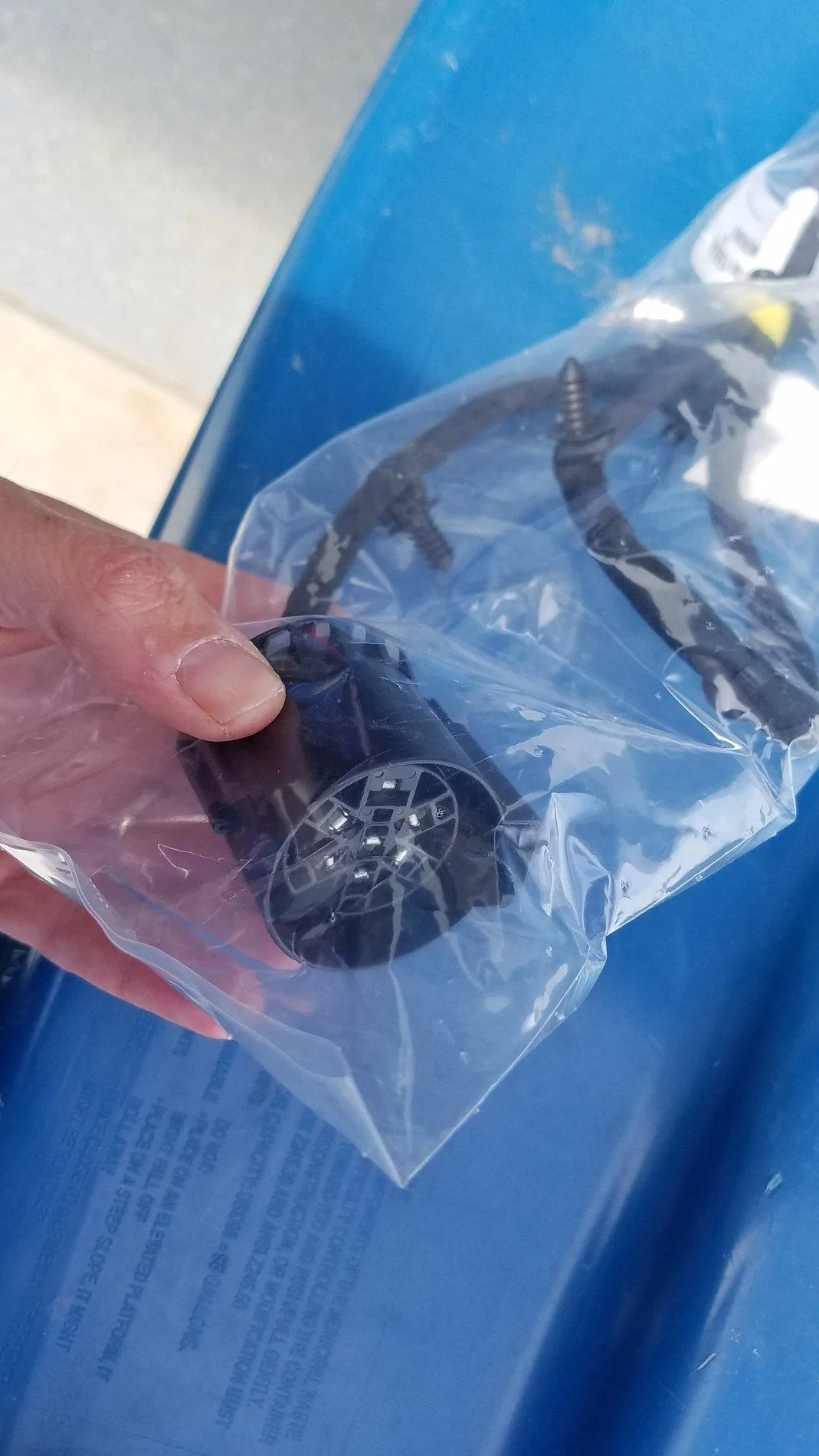

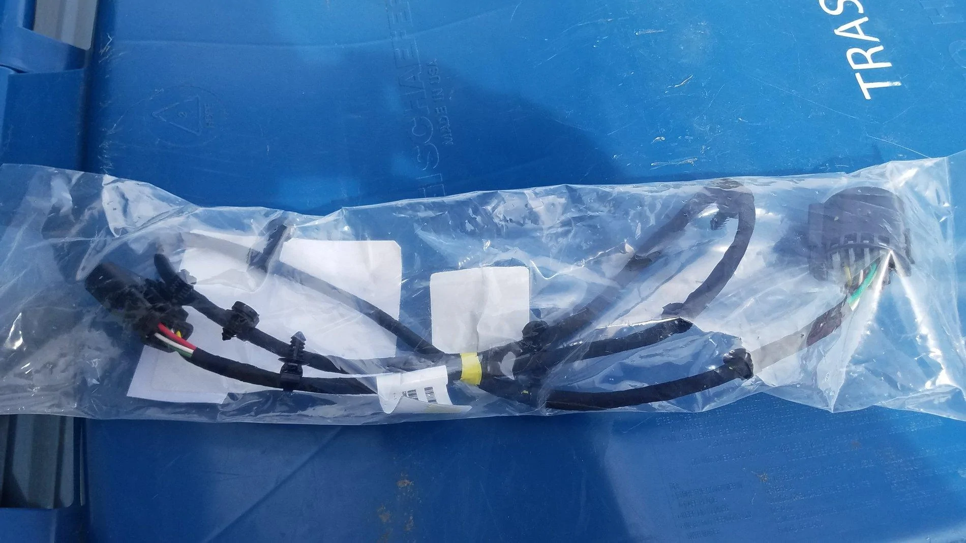

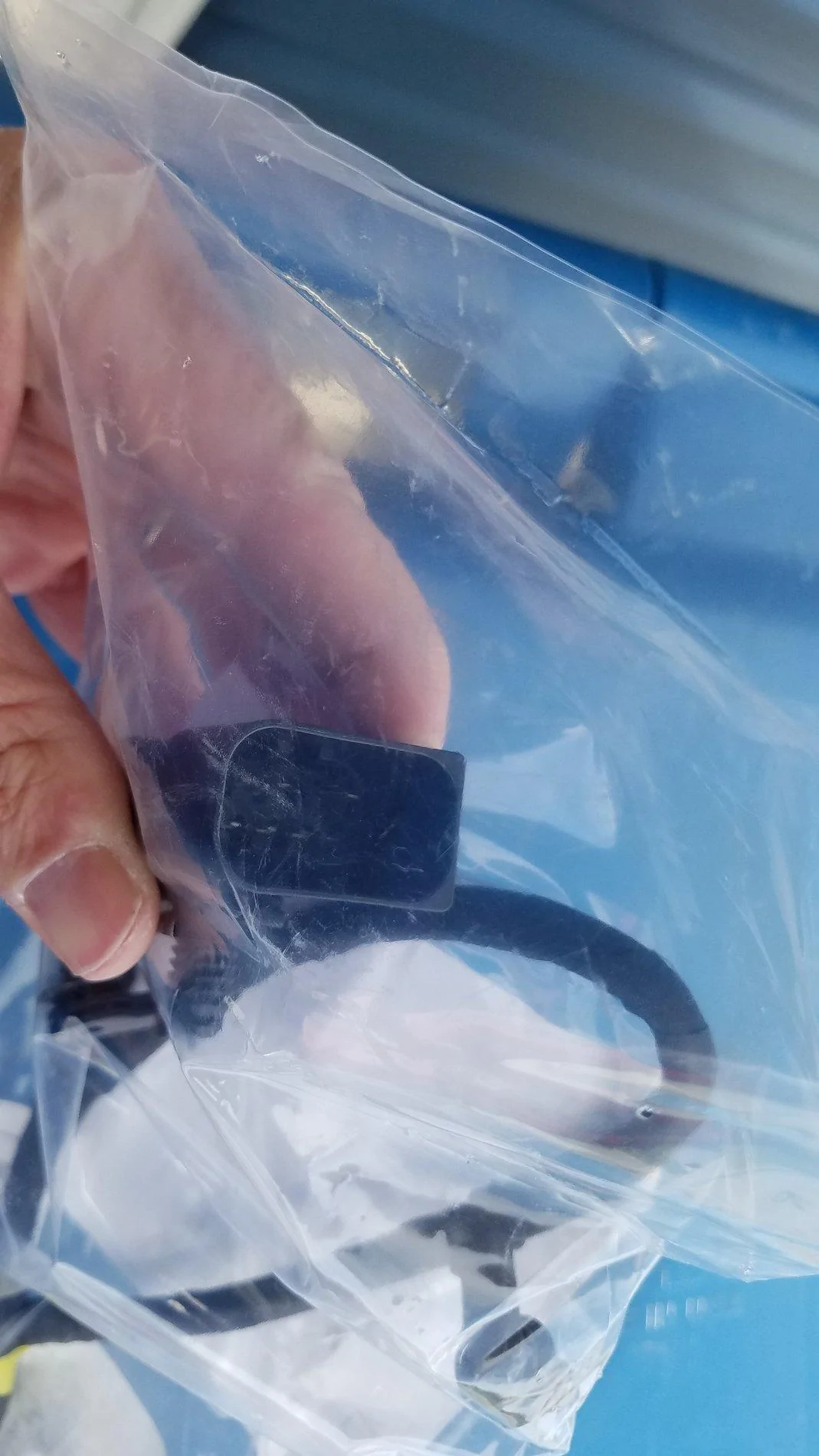

Just wanted to share that I ordered this part # and it is not what I expected. It's got a harness on one end that looks like it would plug into pre-existing wiring inside the Jeep, and the other end is made for a connection to a 7-pin harness for RV towing. It does not allow for plug and play hookup to use a 4-pin adapter. In fact, I'm seriously doubting it'll do anything at all for Jeeps with no factory tow wiring.
Oh well, at least it was just $35 wasted.
i couldn't agree more. did the same thing and I am having another issue with a Mopar online vendor. no images of product... no sale...
