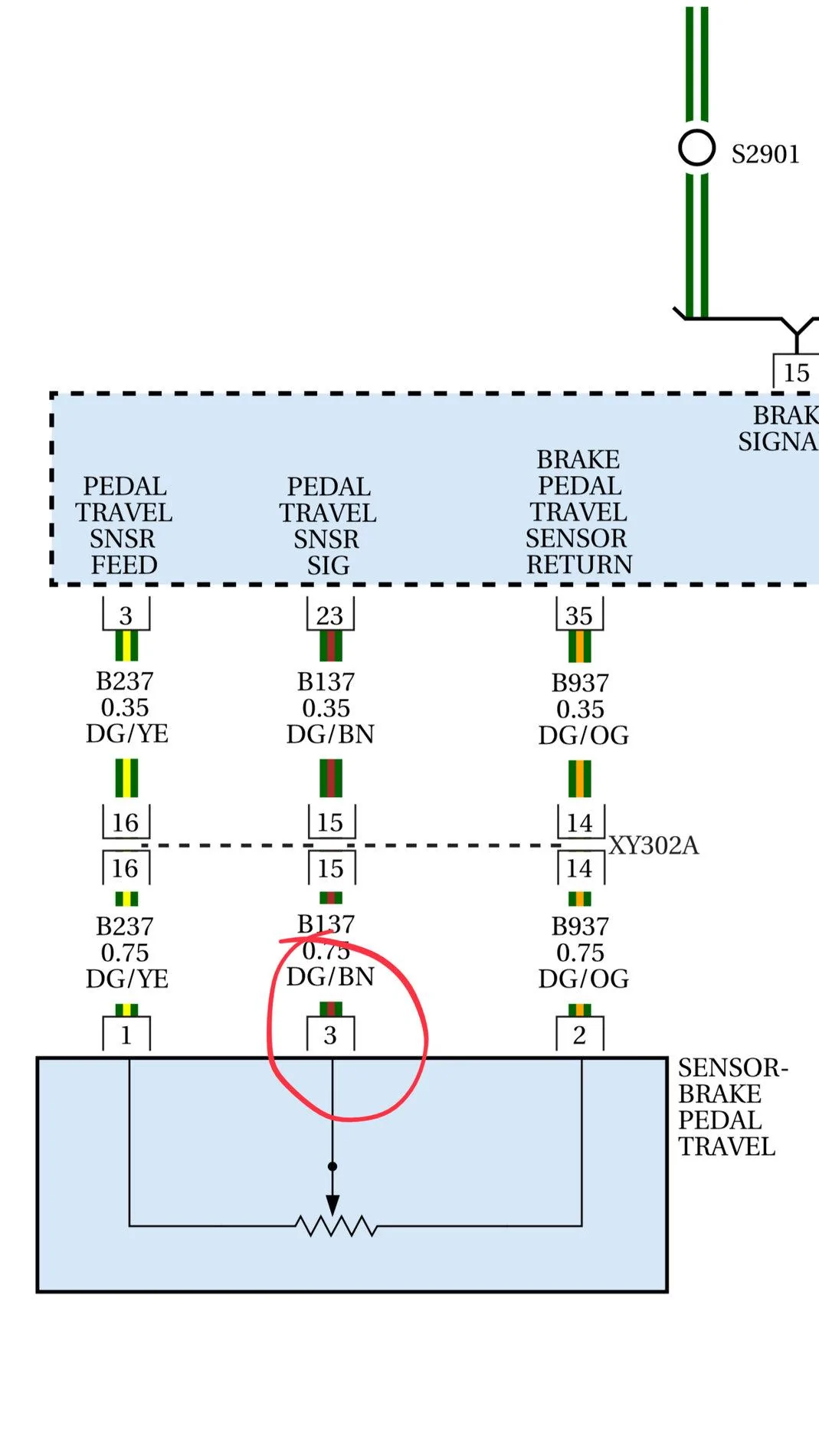

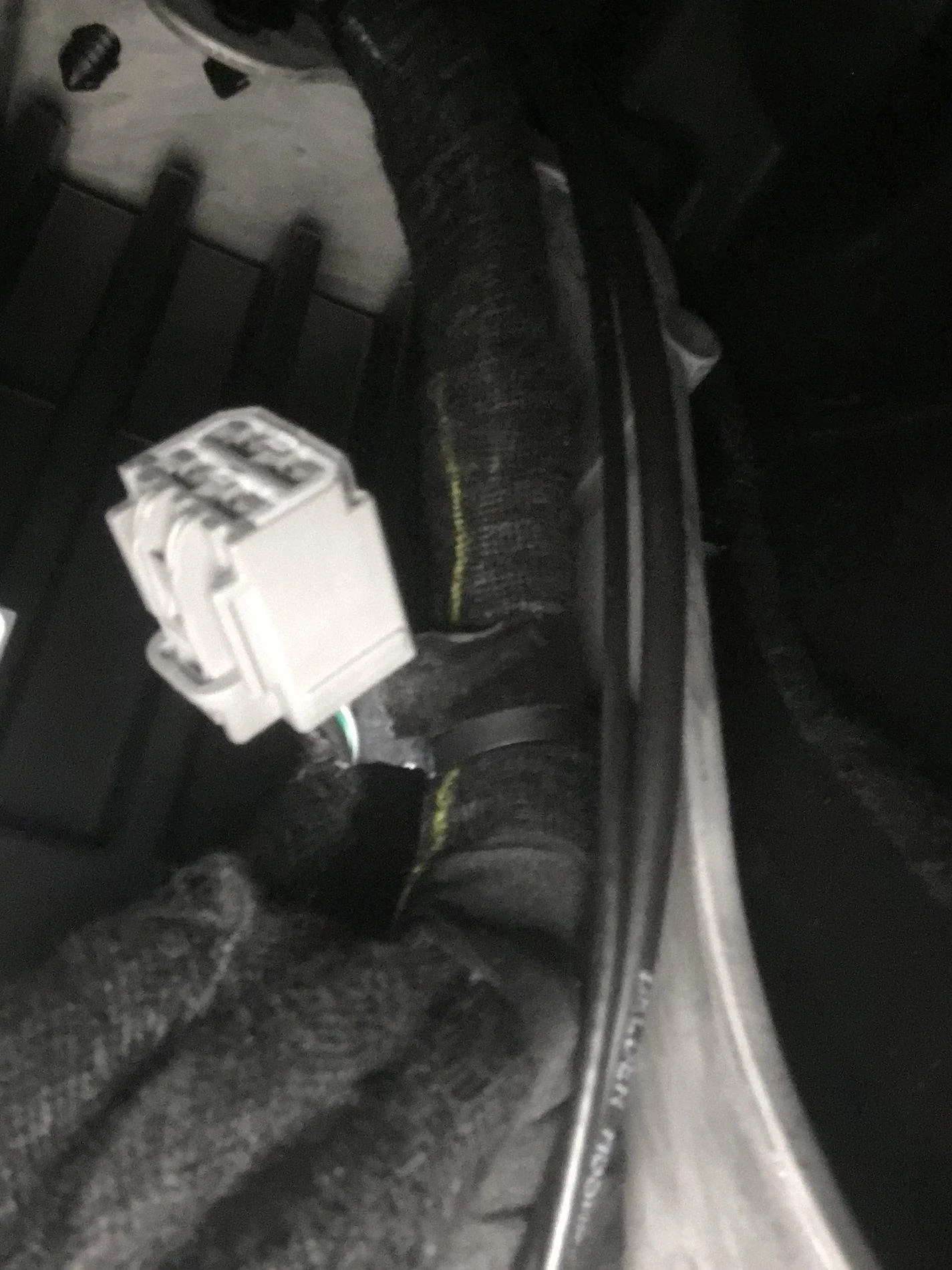

I just looked under the dash on the driver side and didn't find an empty plug. Doesn't mean it isn't there, just means I couldn't get my hand/arm positioned to find it with all the panels attached. Someone must have a service manual that would show the entire wire harness run.
I have a controller connection on driver side

Hi KCulp,
Did you successfully install Tekonsha 118782 on your 2018 Sahara JL? I am looking into installing this but according to e-trailer it will not work with a Sahara or Rubicon.
I posted my original post here
but no luck in getting a response back.

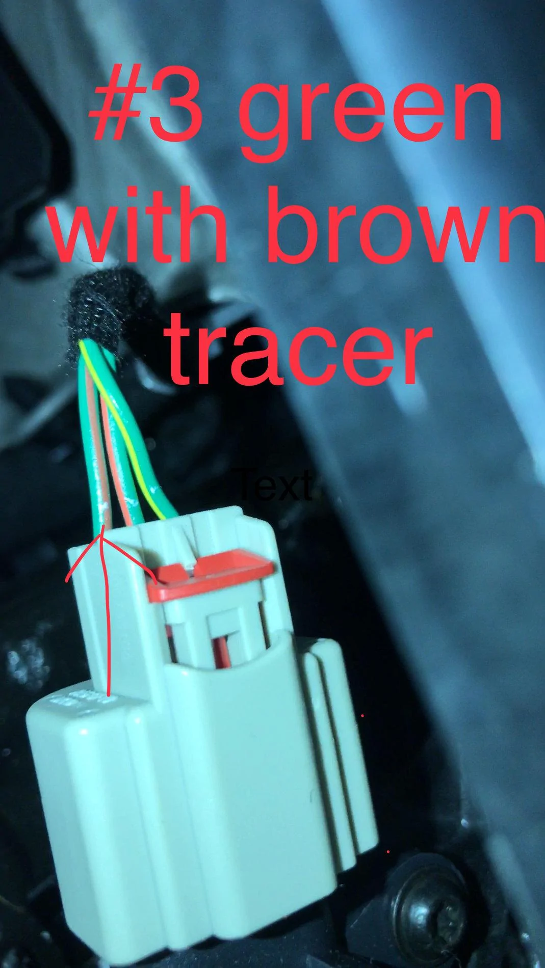

I installed, but have not tested it yet. Someone else had installed it and said it worked, which is why I chose the Tekonsha. They had the towing package and found a compatible harness. I hard wired mine since I installed my own “tow package”.
I’ll update once I test it out with my trailer.
mergedown
Jason
Feb 11, 2018
209
140
Columbus, OH
2018 JLU Sahara
Tested and not working. Brakes work with the manual override, but not with the brake pedal.
