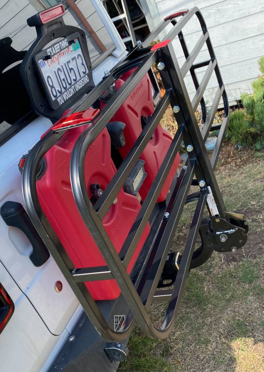

Guess nobody's stealing those gas cans.

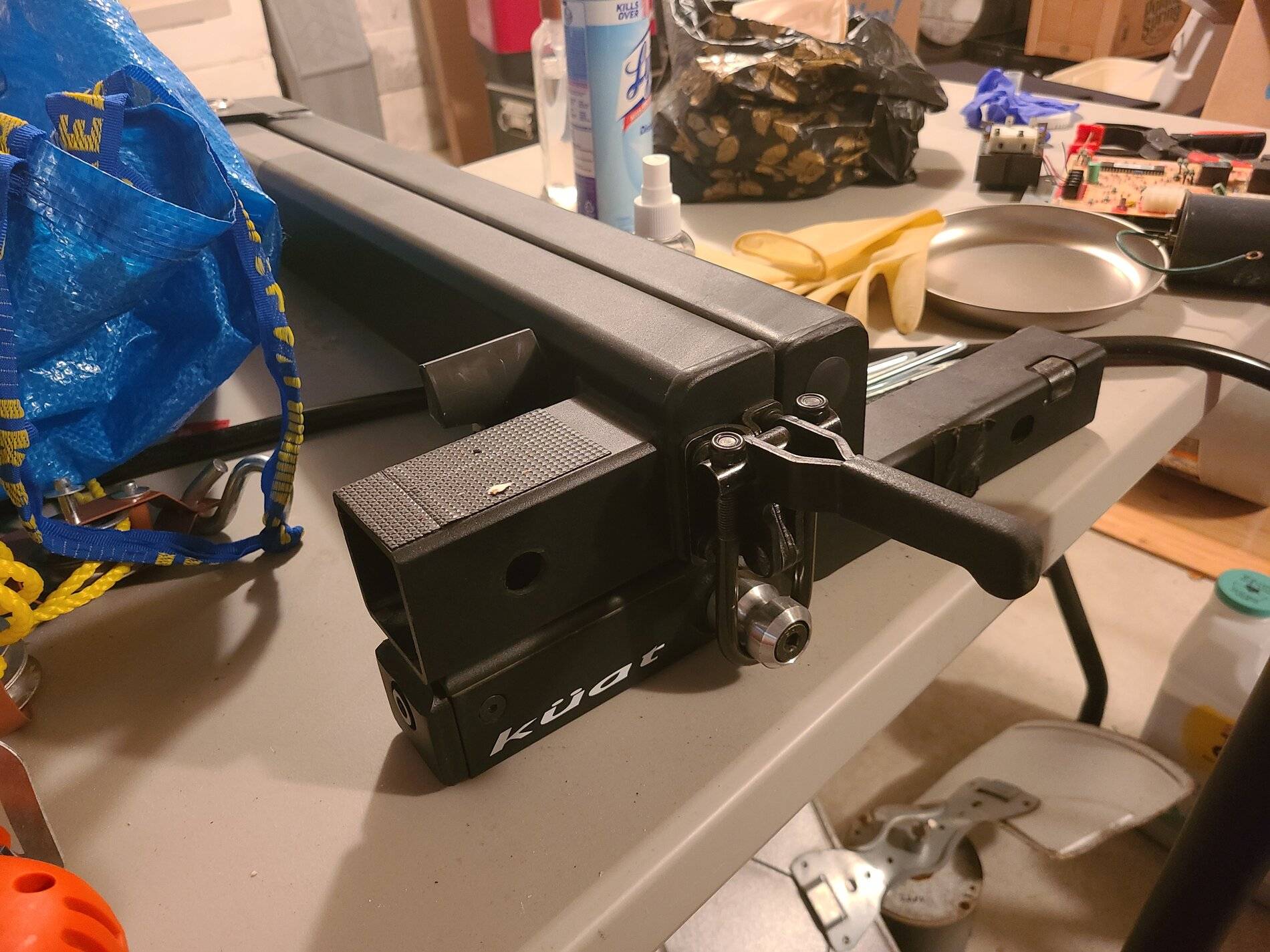

@Afishinado I'd definitely go for aluminum for light weight and rust inhibition. I've an aluminum Curt tray that weighs around 20 lbs, and it is amazing being able to easily pick it up and swing it around or overhead.
The centre post is usually still steel, but I recommend replacing nuts and bolts with stainless when you first assemble.
Hitch tighteners will fix the rattle and wobble. Get two if you use an extension.
You said you only have 60lbs of cargo or so, but just remember that a hitch extension will typically halve the load capacity. And be prepared to scare yourself when you drag the tray on steep off-exit gas staion entrances.

Tough to say, without me getting a protractor, then you getting a protractor, then both of us looking up how to use them correctly.
I use mine on a swing-away hitch, which extends the tray, but also raises it the one hitch height:
Jeep Wrangler JL Hitch cargo carriers 20210909_182139
It weighs more than the tray though.
I'd say your best bet would be to get a yardstick and tape it to the bottom of your hitch, out to the width of the tray you are planning to buy. Remember to add the length of the original tray extension and any extender you may add.
Then go down the driveway and see if it scrapes. Remember to account for the sideways length at the ends of the tray, for when you turn out of the driveway.
Good luck.
