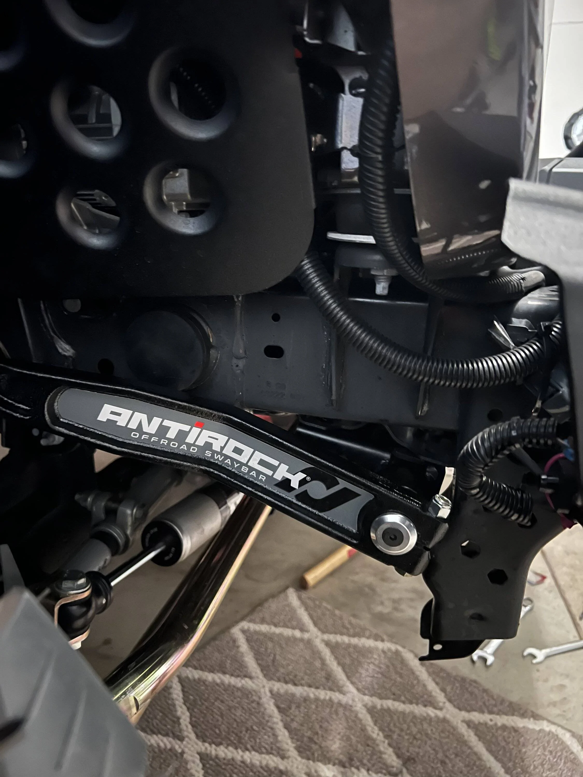

When installing the arm .. I can’t get it get it installed level… does the bar need to be installed level as possible ?? Seem mine at a huge angle … any advice or tips … do I need to have this install on a huge lift???

It’s better to have the end links too long than too short.

have you got the minimum lift Rock Jock recommends?
the adjustable links come in different lengths, too; you could contact them to see what they says about you maybe needing a different length link.

Mine sat right around there maybe a little less of an angle. You can order shorter end links but I wouldn't say to go level as you don't want it to flip around in full droop. I came across a video awhile back that showed how to measure your down and up travel to find the sweet spot.

I have a mopar lift … just all the video I see online the bar wasn’t as slanted .. but I guess it depends on the length of the end links and lift ..

The antirock arms should only be level at mid shock travel. Jeep needs to be in the middle of total shock travel then arms can be leveled. I had to trim a couple of mine. You also need to full droop it to make sure there is no chance of it flipping or reversing as mentioned above.
