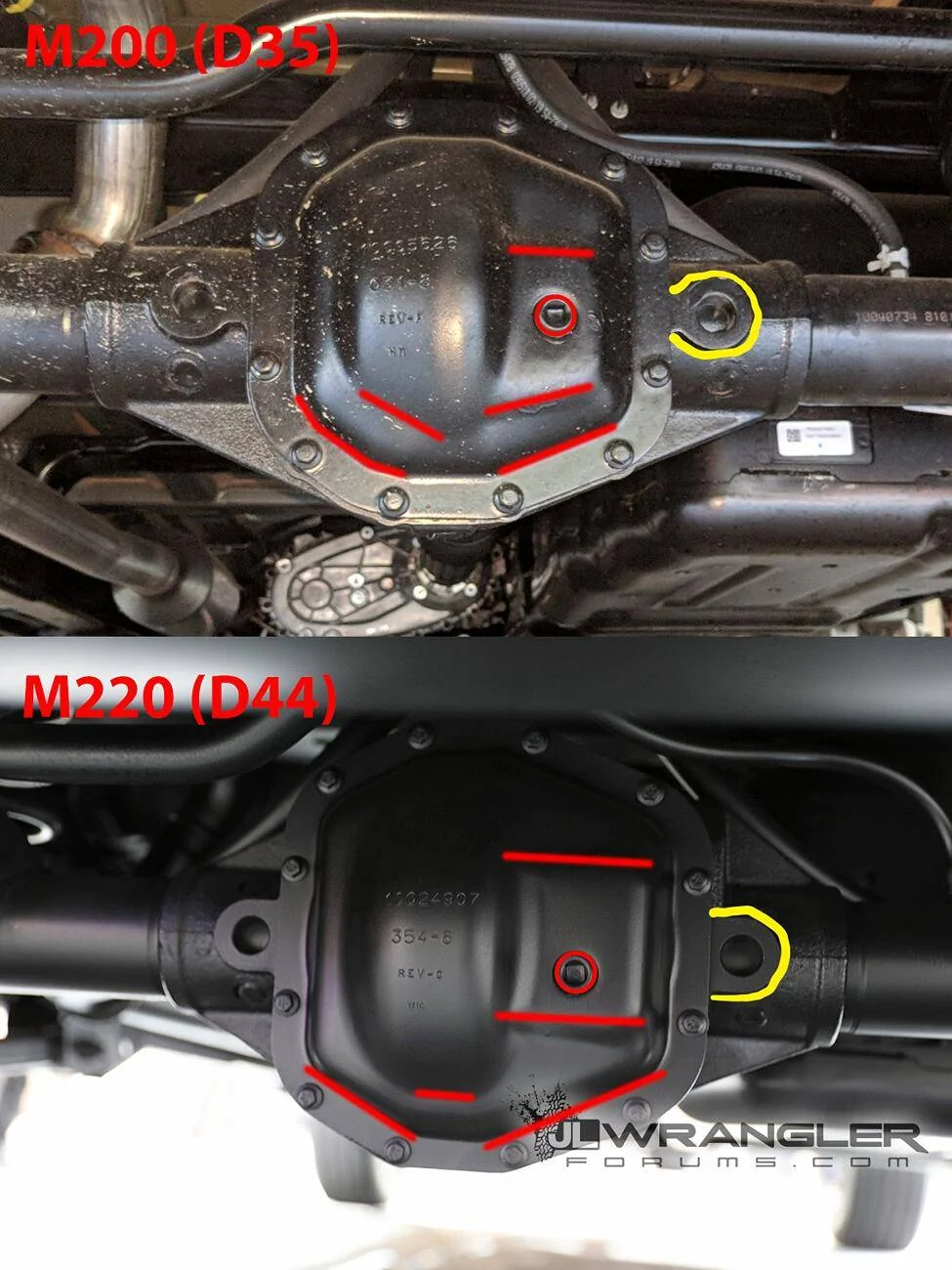

Not enough pictured in your photos for me to ID the diff, but this might help.
Thanks I'm sure it's the m220 and this is the spec off my vin build sheet.
4:1 ROCK-TRAC HD FULL TIME 4WD SYS
DANA M210 FRONT AXLE
4.10 REAR AXLE RATIO
DANA M220 REAR AXLE
TRU-LOK FRONT & REAR AXLES
