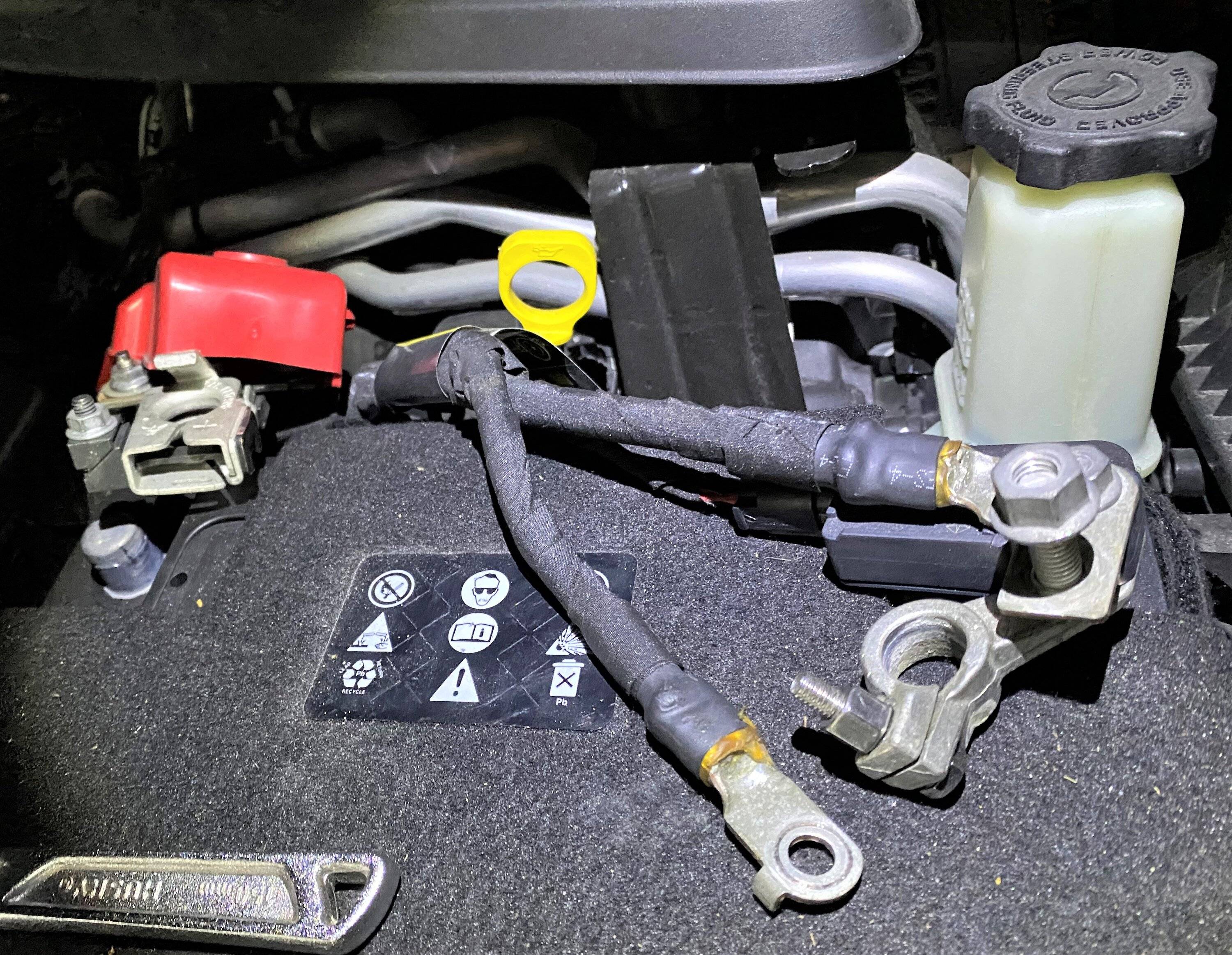

I am at my wits end with my 2019 JLU Rubicon battery and hoping that somebody here can give me some answers. The background story: I live in a condo complex in S. Florida and am here only part time (I can be gone for a few months at a time). The parking garage does not have any electrical outlets, so when I am gone, I am not able to use a battery tender. What I have done (from advice that I found on the internet, as well as asking my dealership) is to remove the positive and negative terminals from the main battery of the Jeep. Included with the negative terminal, I remove the secondary cable from the negative terminal (which I believe goes to the secondary battery). I am attaching a photo of the disconnected cables to explain what it is I am doing.
The problem is that the secondary battery continues to drain(?) while I am gone, so that when I come back, it is dead or dying. I was just gone for about 2 months after having had the battery replaced, and guess what - it is dead!!! I have had that secondary battery replaced 3 or 4 times now (I lost count) since having bought the Jeep in 2019. Since it is buried under the main battery, I have to take it to the dealership to have it replaced, which is both time consuming and expensive.
Can anyone give me suggestions on what might be going on and/or how to manage this problem while I am gone. Again, buying a battery tender is not an option and I am sick and tired of having to replace the back up battery. If I can't figure something out, I am afraid that I am going to have to sell the Jeep and get something more simple, which I don't want to do.
