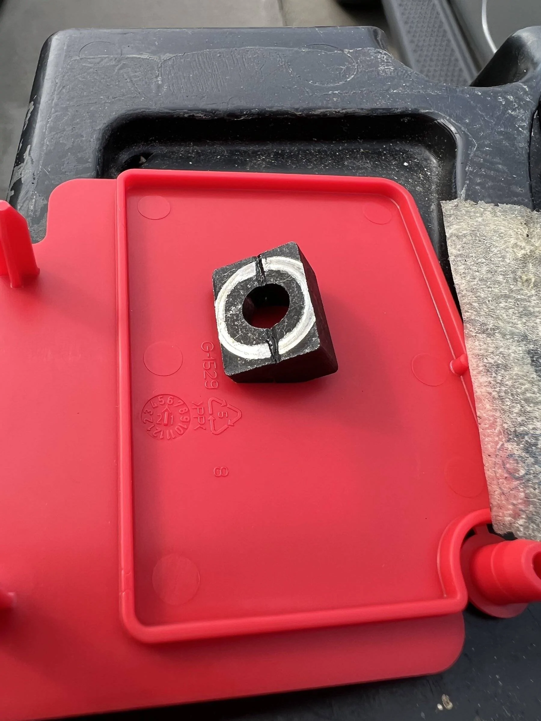

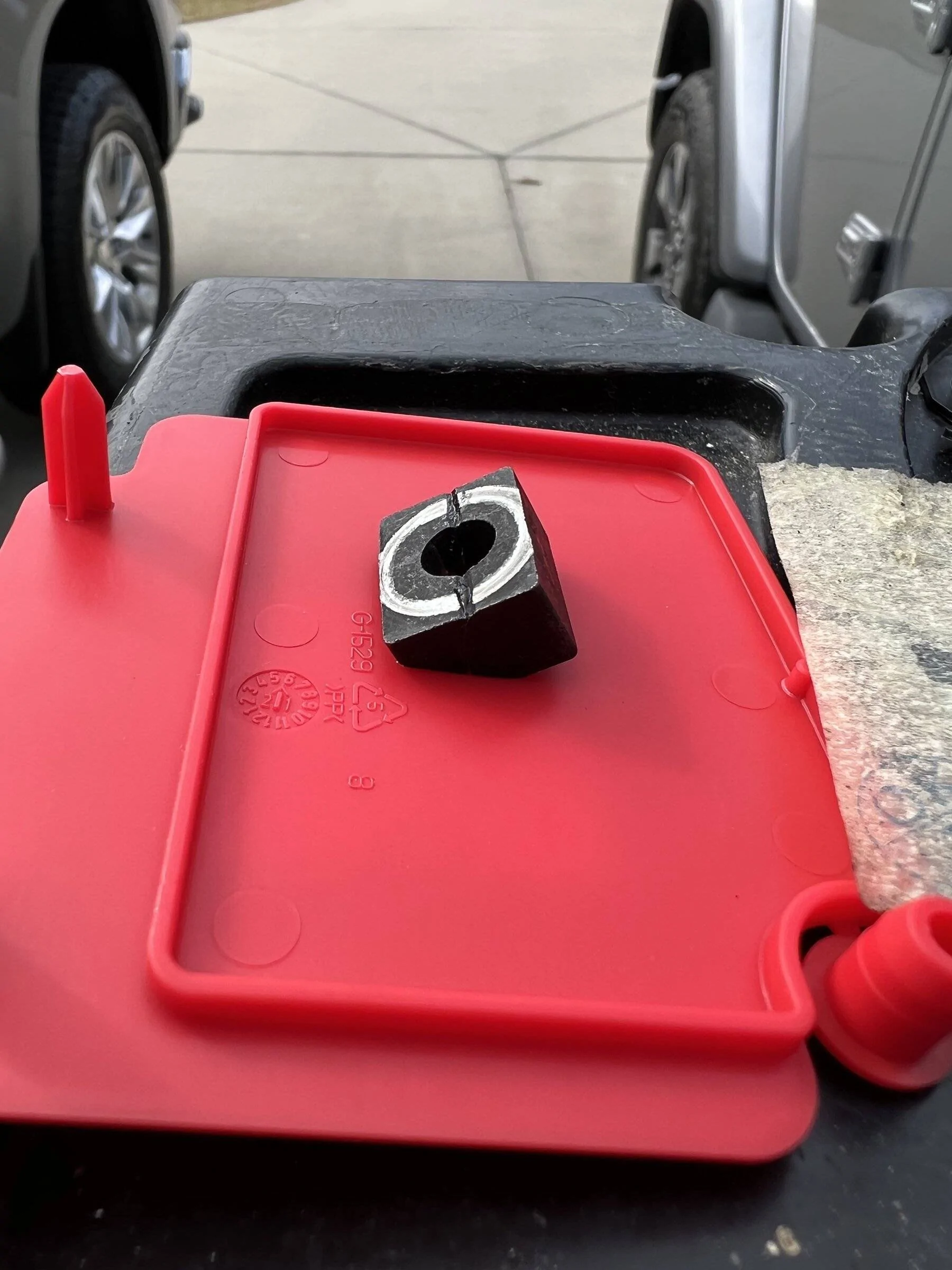

I recently had to replace the OEM battery (2018 2.0 Engine) and when I went to tighten the positive terminal clamp a piece snapped in half. I probably over-torqued it, but I was only tightening to what I felt was decently snug. I've attached images of the piece in which I am referring. I glued it back together and reused it and it seems to be holding for now. Does anyone know what this part is called and where I could possibly get a replacement in the event it doesn't hold up over time?

I am not at my rig right now. But I don't think it broke. I think its a wedge created by the two pieces. They stack and when tightened they offset to close the clamp, no?

You are correct. It is a wedge. It might be hard to tell in my pictures, but the top half of the wedge is what broke in half. You can see the line where it split and I glued back together.

did you ever figure this out? I am having the exact same issue.

grab a piece of steel and a grinder and a drill(drill press) and make a new one. take about 5-10 minutes.
