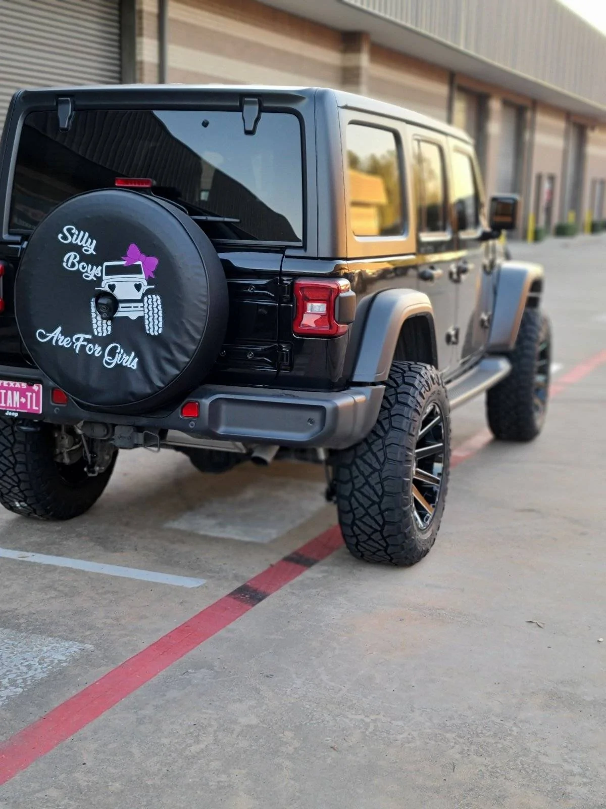

Hello! I have a 2020 Jeep Wrangler JLU Altitude and having some stiff like noise coming from the inside tailgate area. I took it to dealership and they said it was the tailgate gate that needed to be adjusted. Picked up jeep no noise for about a week then noise returned. It's loud and when you sit in back sit while truck is in motion you can hear it very loud. It seems like the bar across tailgate inside is the noise, it's like across between stiff, squeaky, rubbing noise. Has anyone else experience this? What can be done to correct?
I do have a 3.5 lift w/ 35's 20 (teraflex lift kit with fox shocks & stabilizer) but the original tire is on tailgate with no modifications to it. I noticed the noise prior to the lift but thought it was my door because of how loud the noise traveled to front of truck.
