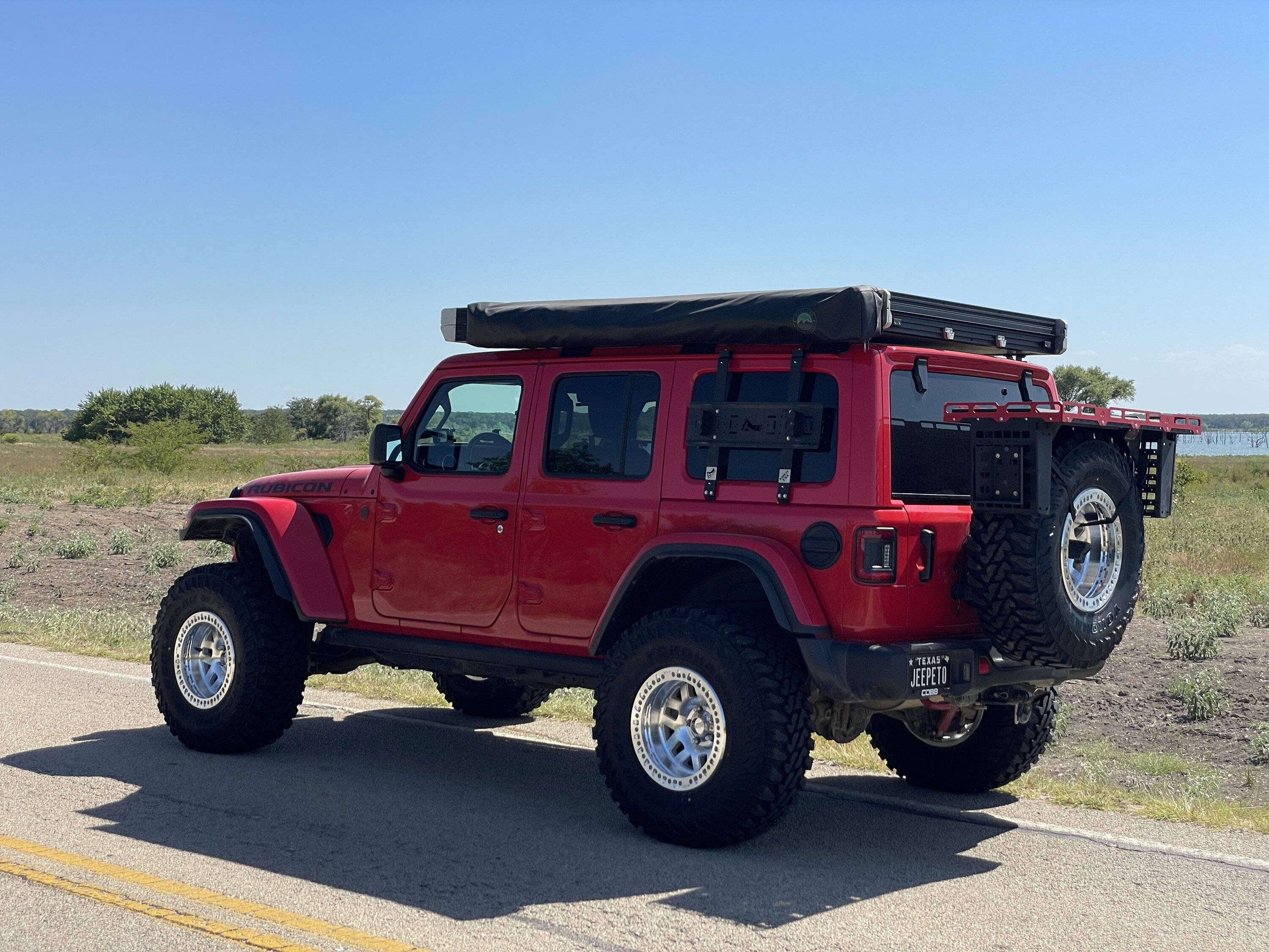

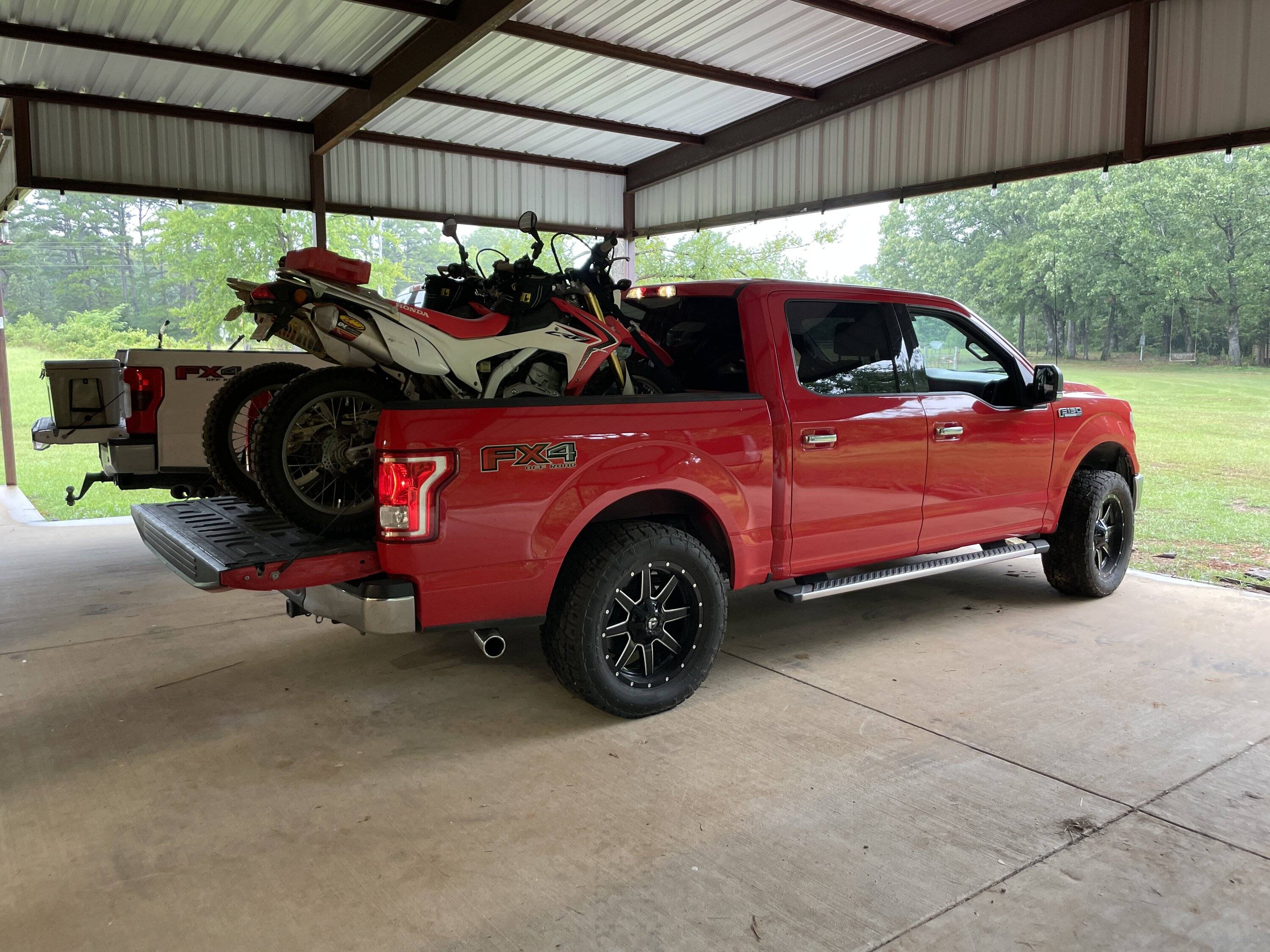

I run Fuel wheels on my F150 and KMCs on my Rubi. Both are good brands with a range of options. I’d stick with 17” wheels as the majority of off road tires are available in that size at a better cost, it will also provide more sidewall and better ride quality, both good things for a Jeep.

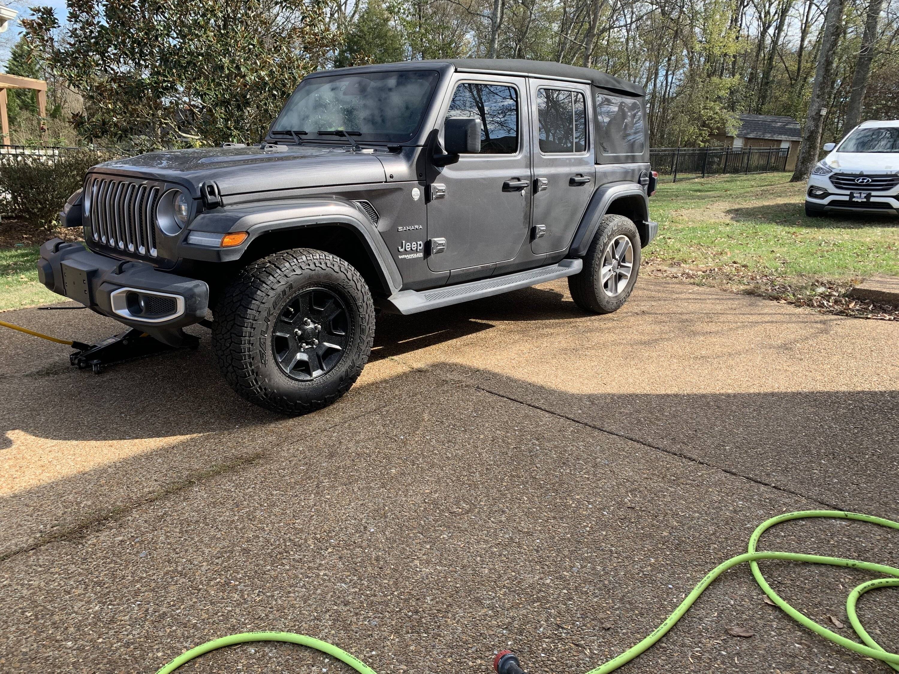

I have a '19 Sahara with the 18" wheels as well. When it came time to replace the tires, it was $2000 vs 5x17" Gladiator takeoffs I found on Facebook for $800. Gave it a shot and will never go back. The ride is absurdly improved. If you go that route though, watch out for TPMS sensors. They changed frequencies in mid 2020 so anything newer will have to be changed out for your JL to see them.
