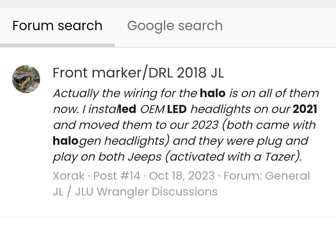

I don't understand why you're using a harness. The 21s should be able to run the LED headlights without any resistors or code.
The code is used to turn on the halo. The 18'-20' had to have the wiring kit added to run the halo. The 21s-present came with the halo wiring even if you had Halogen headlights.
