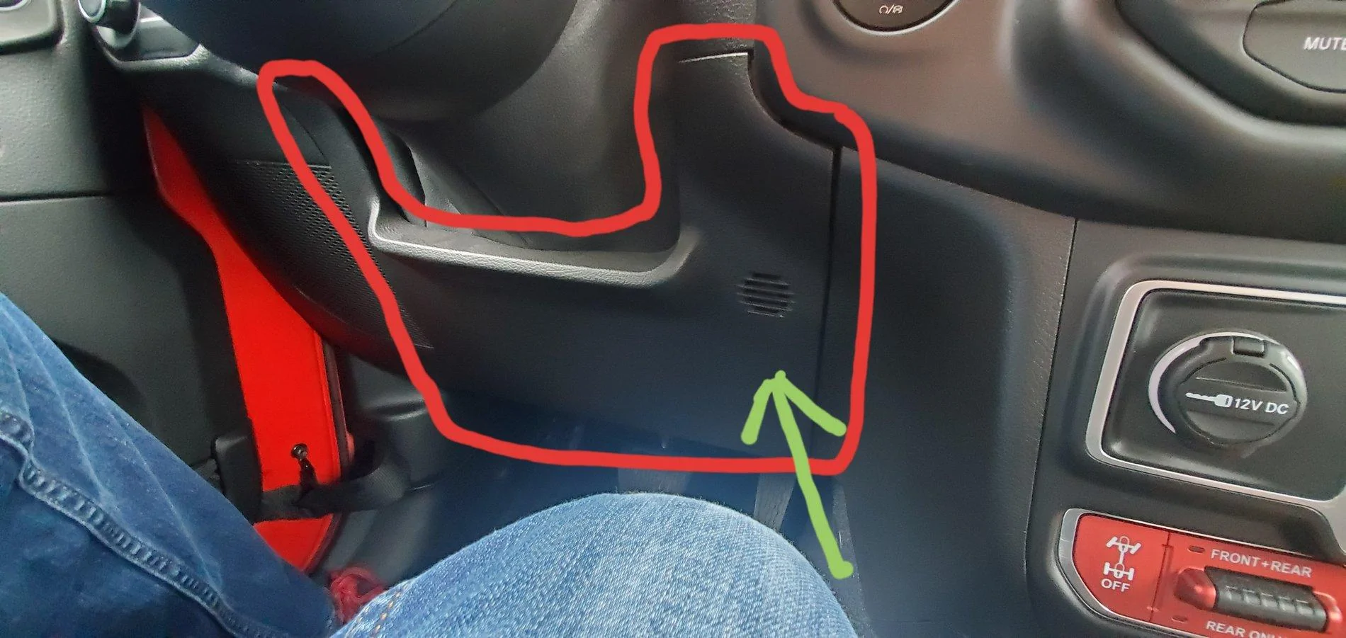

While we're on the subject: I didn't have the vibrating Charlie Brown voice until I removed that panel to install the Tazer. Now it's all I hear when I listen to Howard. That panel vibrates like crazy now when the speaker hits certain frequencies. I can't wait for the warmer weather to come so I can troubleshoot this. I'm hoping it's as simple as just putting some foam/tape in a few strategic places. No way I'm letting the dealership troubleshoot this and spray foam everywhere under there.
Holy crap!! That is the exact same problem we have...It is my wifes car. I actually took it the day Hillary was being interviewed by Howard. I was like "wtf is with the radio in this thing"...After poking around, I realized it is coming from that panel. It is going in next week, hopefully a little foam tape will shut it up! Will keep you posted...

What is behind this panel? That is the exact spot I am getting a strange "tinny" vibration when the radio is on! If I hold my fingers on the panel, it seems to damper the vibration.

For me the vibration started when I disconnected the 2 plugs from the gateway module to plug in my Tazer Mini. I bought a pack of plastic toilet shims from Home Depot and wedged one between the gateway module and the back of the driver side speaker enclosure. That fixed the problem, and the shim hasn't moved in at least 6 months.

Start at the bottom and work your way up and on both sides. Tazer users have to get into that panel to installer their Tazers (as I did).
