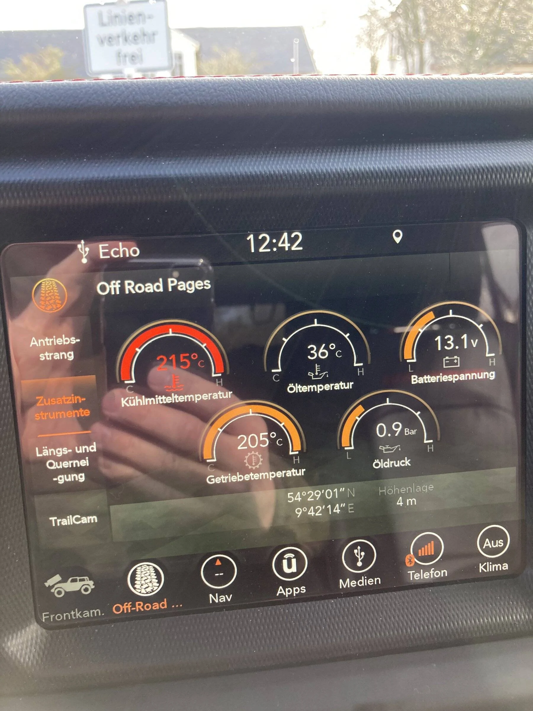

I think Jeep overlooked the fact that regular car folks would be driving the JL and not traditional Jeepers who know that temperature is not possible without an engine fire.

I’m wondering what the technical specifications of those temperature sensors are. If there is an intermittent short-circuit to supply situation happening, either at the sensor or by the ECU, then the sensor output would be interpreted as whatever the maximum output of the sensor is.
Electrical problem for sure, there is no possible way your coolant went over 400F, your radiator, coolant line would explode long before even reaching 300 F. You engine will have catastrophic failure like rod knocking holes on the blocks.. Same as for the 401 F transmission, it will have a melt down and no possible way you are driving it normally the second day...

I'm wondering if I should even bother taking it to the dealership to look at it. I'm sure if it is a "hidden egg" they probably wouldn't even say anything about that either :facepalm: And how do we explain the transmission temp?
i would take it in and get it looked at. Its under warranty so why not. This would make me nervous.

Same here, just in Celsius. Happens from time to time. All is normal until the engine is shut off, then this appears.

Not sure if the question was aimed at me or the thread starter. I have a Tazer, but have never activated the cooldown function until now.
It was actually aimed at the OP, but you apply too. That may be why some people are seeing high temperatures. It used to say somewhere on their site or documentation that certain temperatures would be unavailable while it was triggered, I expect this is because it will override the real signal to a max number to force the PCM to turn on the fans. The Tazer team should confirm this as I don't have one (I use the app-based remote start too much) but that may be the reason for the OP's or your high temp.
