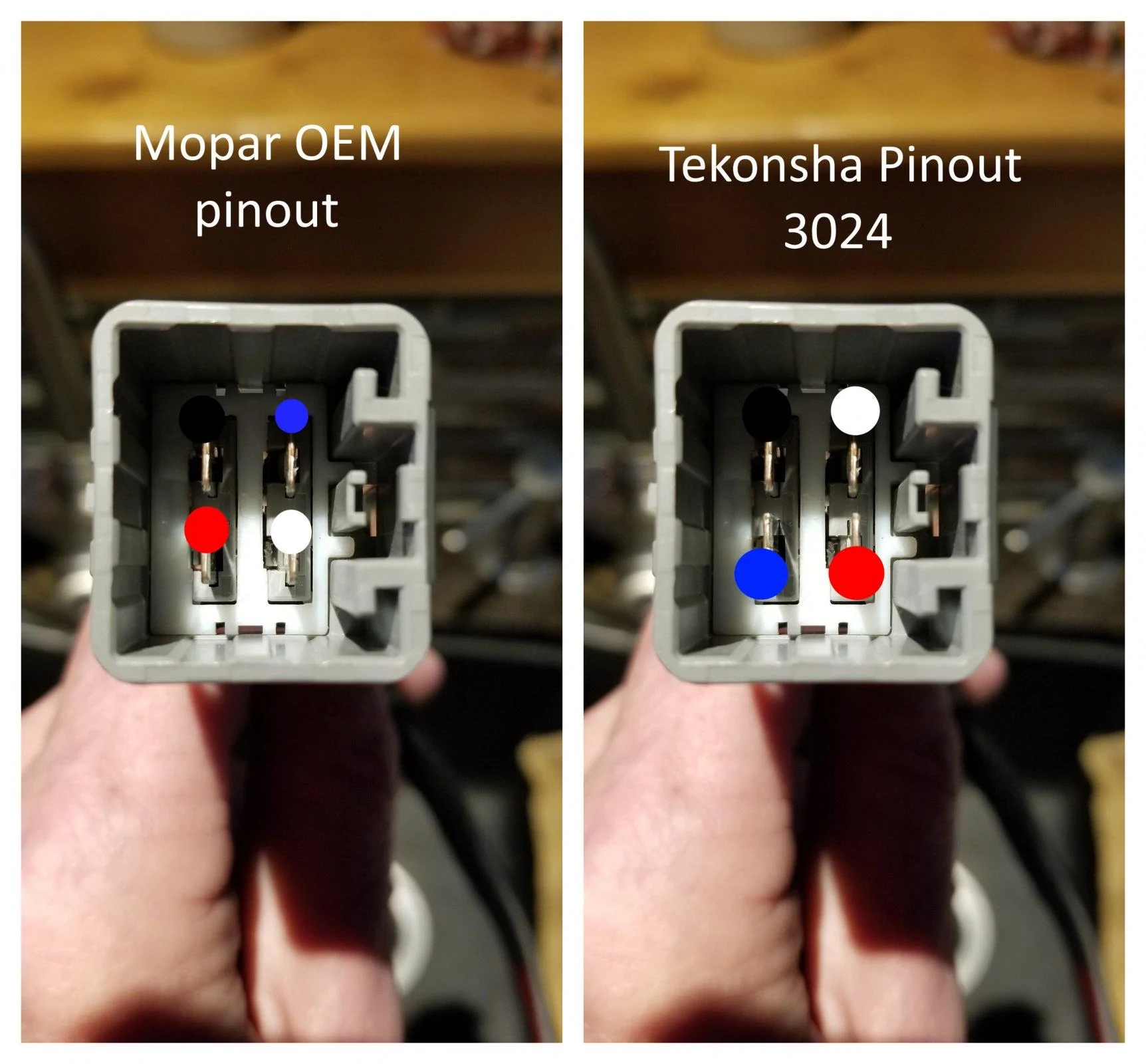

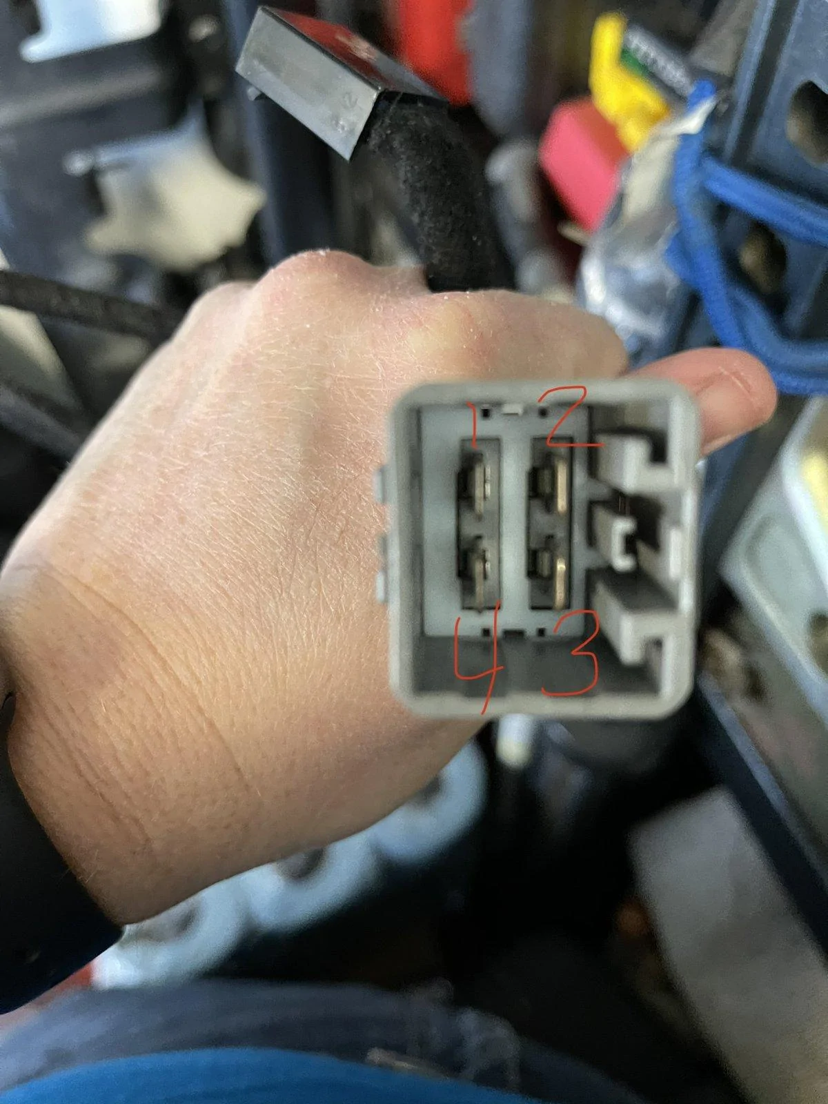

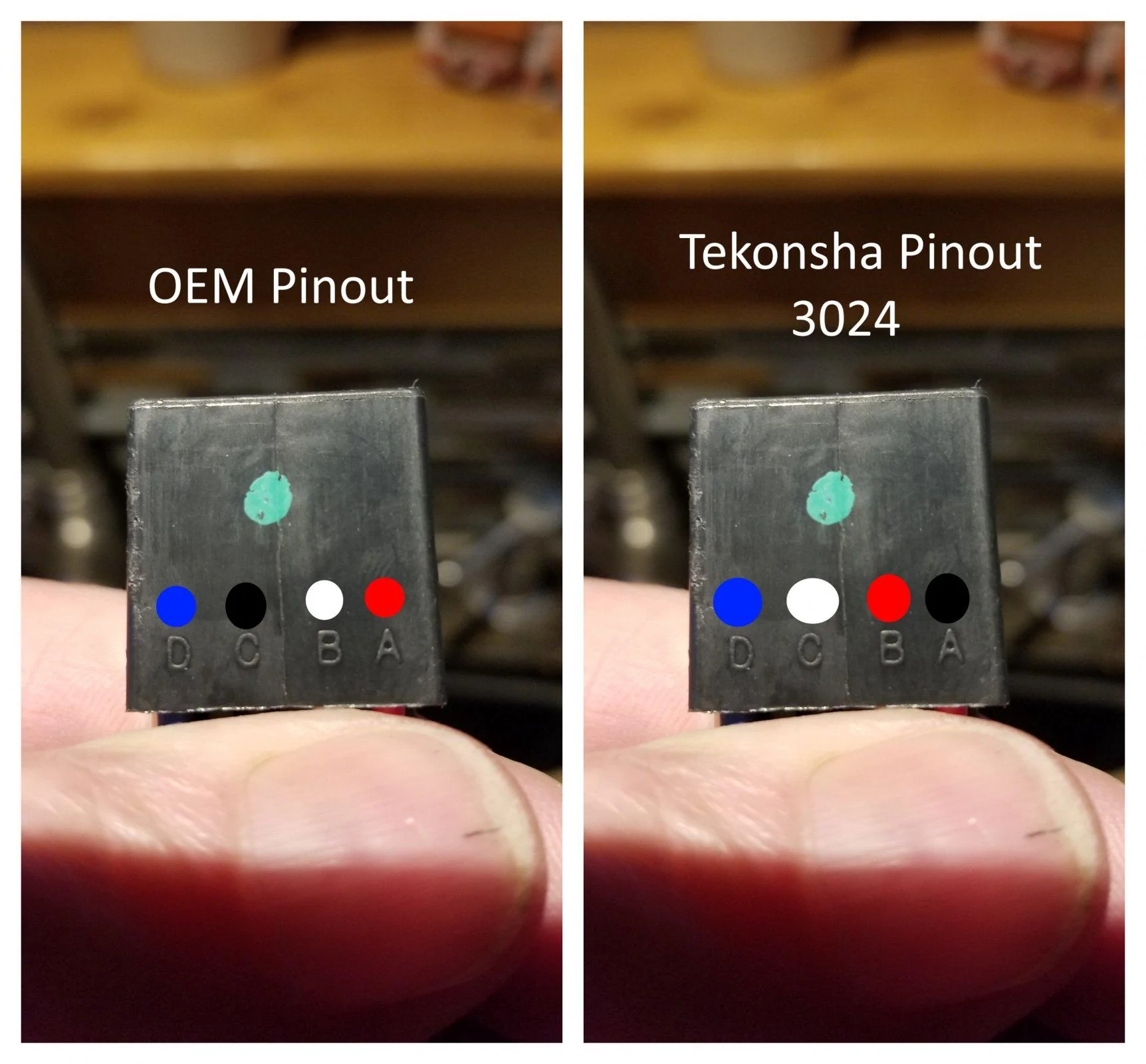

Ok, Here's the record of the pinout of the OEM controller connector and the Tekonsha 3024 connector. I think this is a easy way to illustrate the differences. As you can see, you cannot simply swap out the blue and black...the white (ground) is on a different pin on the 3024. Throwing power to a dedicated ground terminal is not a good idea and not something I'm gonna experiment with on my Jeep potentially smoking a $300 brake controller.
I don't know where my controller is different from the others but there is not much I can do about it at this point. The override works, it just throws and error but resets on the next restart...

The problem here, and I don’t know why they did this, but the OEM harness does not use the standard colors in the standard locations. Because of this, you can’t simply compare the colors as they won’t appear to match up. You have to use a multimeter and verify that pin A on the controller end goes to the same pin on the truck plug end, same for pins B, C, D.
My OEM harness has the same color pin assignments as yours does. l match on the bottom 2 pins, but on the top they are opposite of yours. I would double check and make sure you have the colors right on those. My 3073-P and factory have the following:

As you can see 3 of the wire colors don’t match, no idea why they did that. However, the important part is the pin out matches which means it will work. I’m not sure about the 3024, you’d have to double check it. It looks like it’s a Ram harness, so they Blue and black are probably backwards.
The bottom line is the 3073-P pin out matches the OEM harness, and is a 100% plug and play solution with the diode to fix the issue. It has been tested to work by multiple people and should be what people with pre 2020 build trucks use if they want a fix until Mopar develops one.

Oh MAN!! Talk about a circle jerk...lol
After paying homage to the patron saint of trailer brake controls...and sweating some bullets...IT WORKS PERFECT!
With the AMAZING feedback from JWILSON, I went back and worked on the 3024 with the diode, putting it back according to the original Tekonsha pinout BUT with the blue and black swapped. Apparently this is the SAME pinout as JWILSON's 3073-P plug'n-play.
Lemm'e tell you, swapping an (apparent) white ground lead with an (apparent) red hot lead is NOT something I would recommend to ANYONE, but in this case, whoever designed these looms must'a been on drugs. I really wish I had the full schematic to see how it's designed.
Bottom line...Tekonsha 3024 (that has the diode), swap the blue and black and your OEM Mopar brake controller will work and not throw codes. Don't overthink the rest of the pinout, just install it.

That’s awesome! Glad to hear you have it going. For anyone else looking, the 3073-P I have requires no swapping of pins, it’s plug and play. If you get the 3024-P, swap the blue and black.
