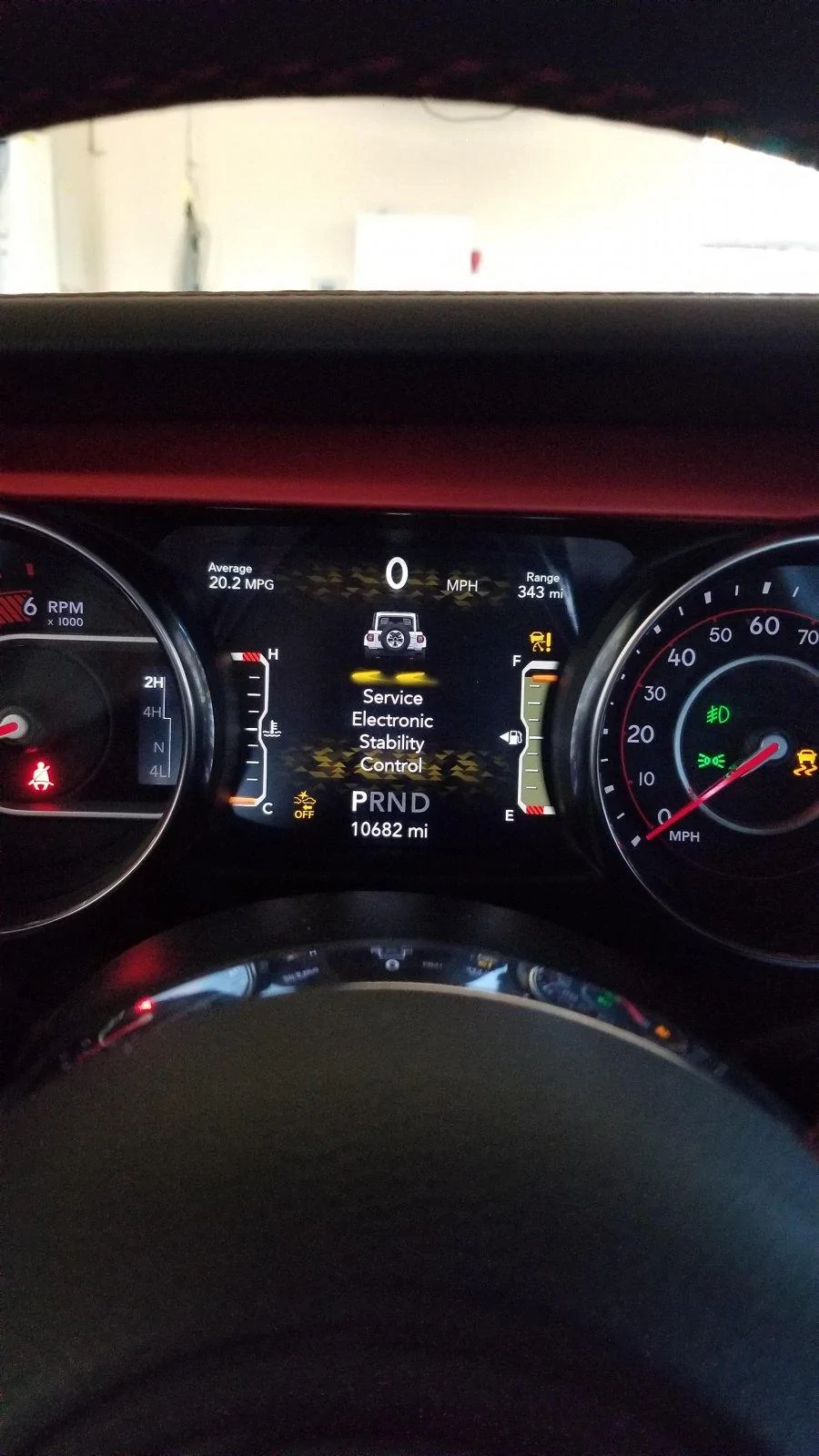

Well, I got it installed... WHEW!! What a PITA, Lots of work But here's the deal.
The Jeep built 03/20 and the controller packaged 09/11/20...the controller works fine BUT, hit the manual brake override and it throws an error "Service Electronic Stability Control". No Christmas Tree of lights on the dash, just a error and everything seems to work. Do a re-start and the code clears.
Guess Mopar still has bugs in the OEM controller. Not sure what I'll do, probably see the dealer.
Sorry to hear that you are having the same issue as others, it would be best to visit the dealer and had them open a case with Jeep. The more reports the better.
Would you please post with your options and add to the poll?

Just sent in a note to Jeep Cares about the error code "Service Electronic Stability Control"...lets see how they reply.
I'm betting the OEM harness needs a diode but WHY would these idiots release a controller that obviously does not work properly, it's just beyond be. I intentionally waited for the release of the Mopar controller just because I didn't want to be jacking around with wires and diodes. Really pisses me off.

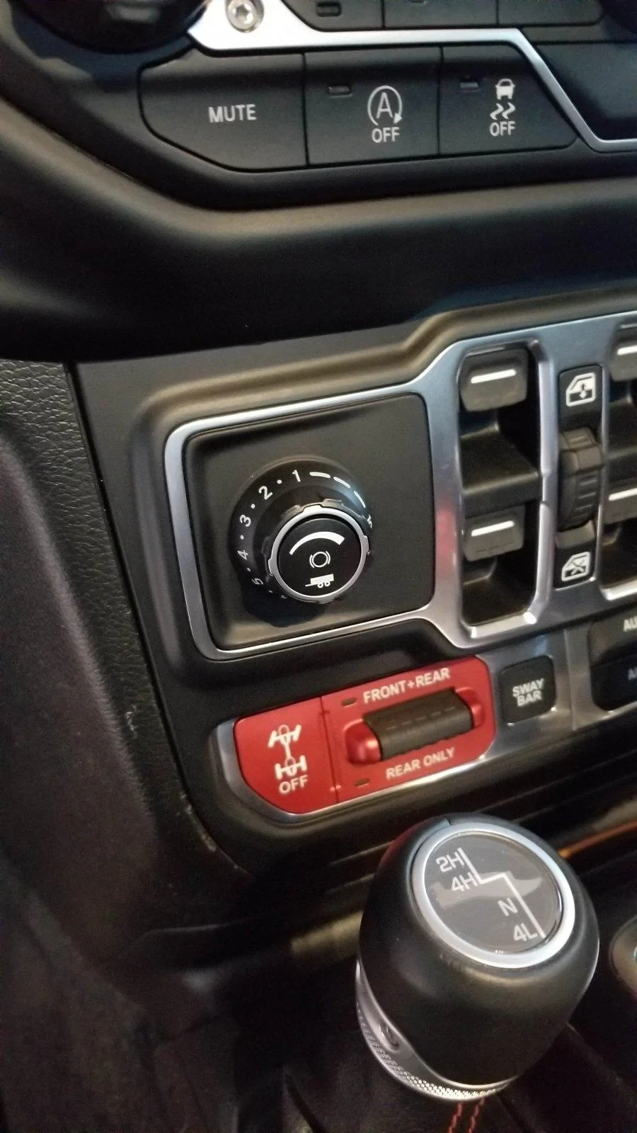

On a lighter note, I was able to move the 12v auxiliary port. After serious planing, I really found only one place that works (at least for me). Attached is a photo.
So there you have it, If you plan on installing this controller yourself, be ready to go to battle.
Nice job. Quite the PITA and I'm an auto tech. I was going to do that location for the power outlet but I have added a large harness through that spot for the one touch up window module I added.
