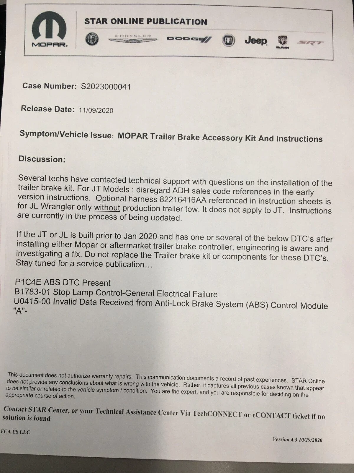

The harness from the brake controller module to the trailer wiring plug needs a diode, the Mopar harness does not have the diode which results in the dash errors and safety systems being disabled until the next key cycle. The issue is not happening on all vehicles. I am trying to figure out if there is a pattern between options and build dates.

If your Wrangler came with the trailer tow and auxiliary switch group (ADH) and they tell you that you need the harness referenced in the directions or that your Jeep needs programming they are wrong. The additional harness is not needed and there is no programming needed.

I do have the auxilary and ADH, however the bulletins from Chrysler where a bit unclear. So the Manager is going to see if it works on my Jeep and the differences. Nothing like explaining to a customer that they can't get an item to work. This will also be good to know for future purchases and orders. What ever they want to do with the information is up to them.

This is now a confirmed issue with Jeep and is based on build date.

I have a 2018. This bulletin could also be called "Mopar Trailer Tow Package". This has been happening since the JL came out. I do not have the harness with the diode and mine throws the codes and lights. I am going to order the the new harness to see if this solves the problem.
Why they sold trailer tow packages without a brake controller or the ability to add one that does not generate errors is hard to understand. State Laws require trailer brakes when towing 3500# trailers that the JL is rated for. The same engineers are going to build an electric powered Wrangler, this should work out well.
