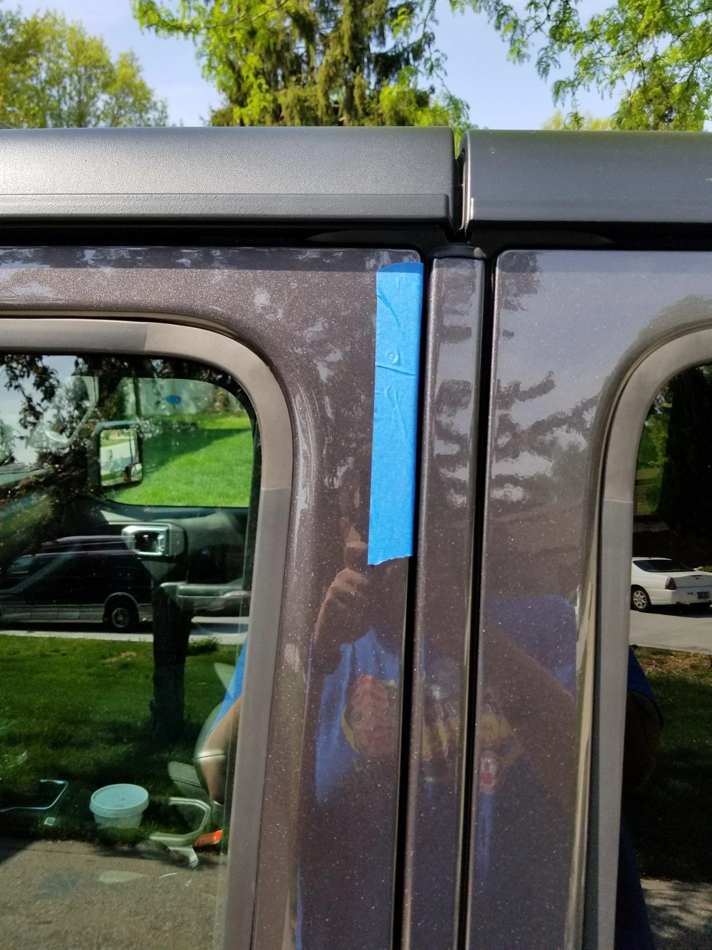

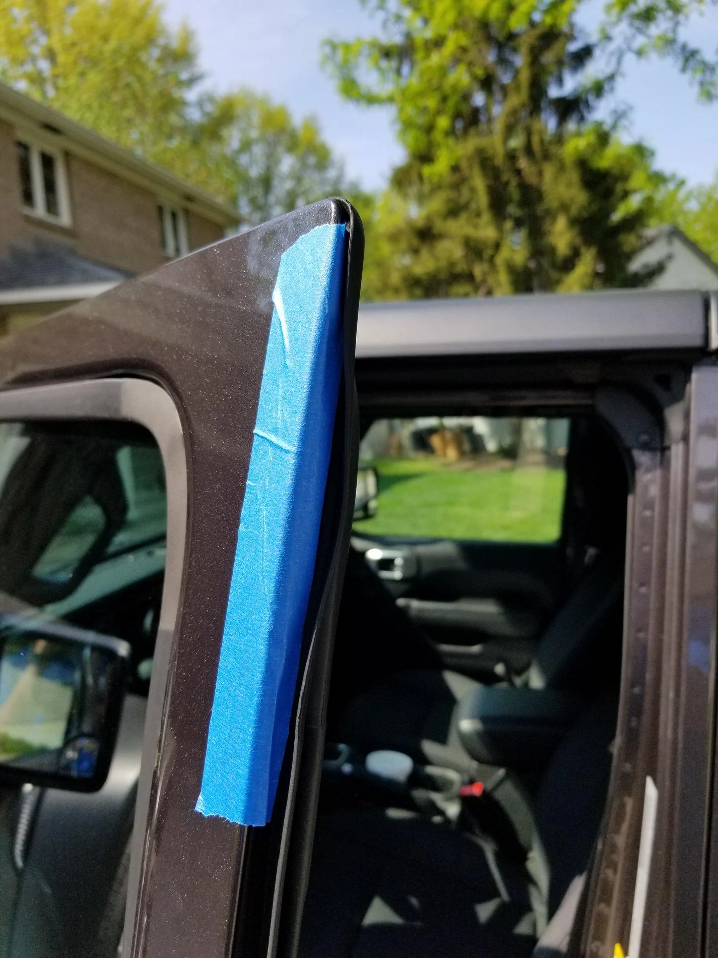

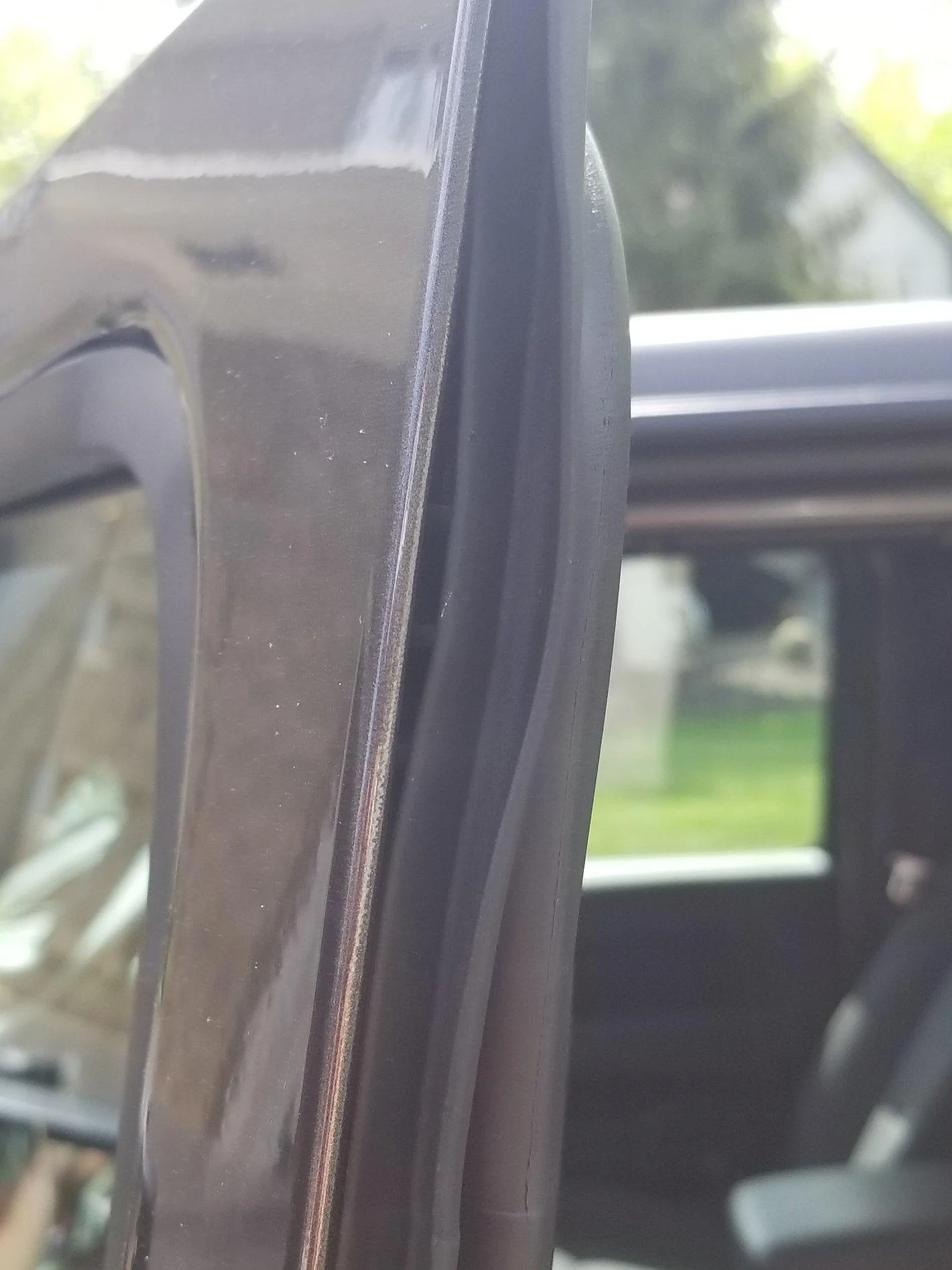

Victory is mine!! I have identified the whistle source!!! It's the driver side door seal. Below is an image of a very small section that seems slight protruded. Without tape...high pitched whistle torture....with tape...whimsical silence. I'm hoping the dealer can reset or replace my driver side door seal. @JeepCares can you help make sure that happens on thursday?
Hi kylefischbach,
We can certainly make sure the proper teams get in contact with your dealership. However, we do believe that just updating your dealer that this is where you found the noise coming from will be beneficial. We can work on notating this for you as well. Please send us a private message with your VIN, phone number, current mileage and servicing dealer - if you have not already.
Is the door seal supposed to be out like that? Cause mine is. However, I don't get a whistle sound, simply a very loud cross wind noise.
My passenger door isn't like it. Plus taping fixes the whistle....so....my assumption is no.
