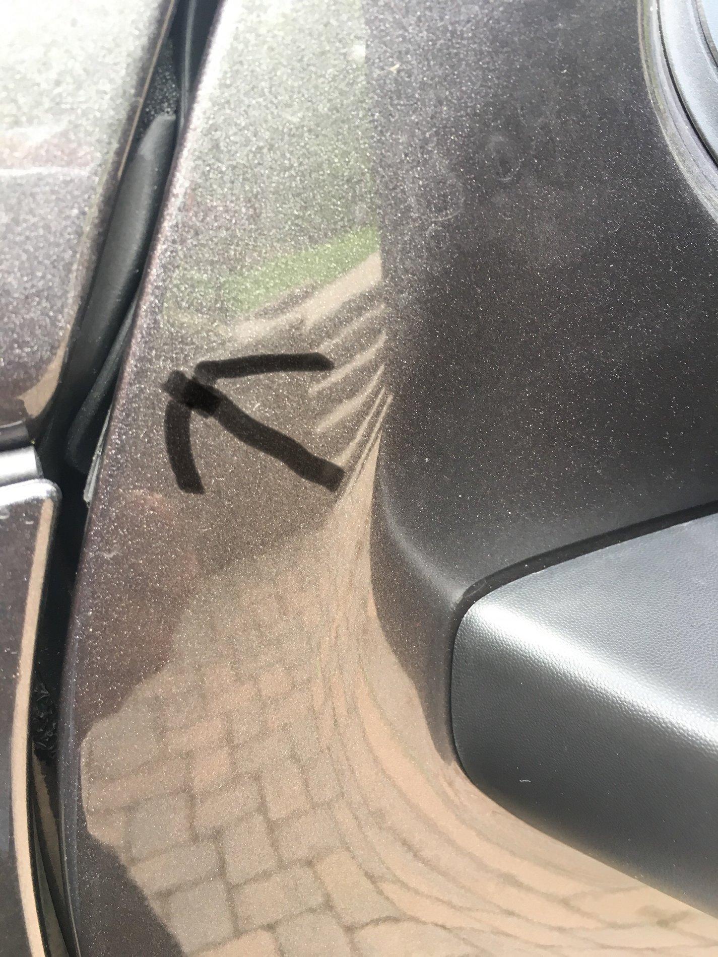

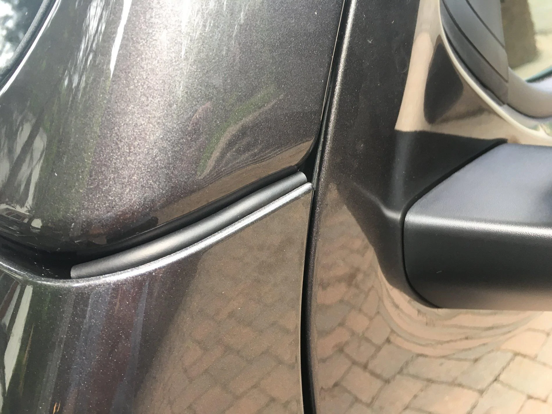

I temporarily fixed my wind noise. I never had the whistle but I did have roaring air sound above 40mph. I think the issue is from the air flowing up the narrow channel shown below in the pic with the arrow. I fixed it by inserting a rubber tube into the gap between the cowl and the A pillar until they hopefully come up with a better solution. It’s quiet now and I’m happy!!
