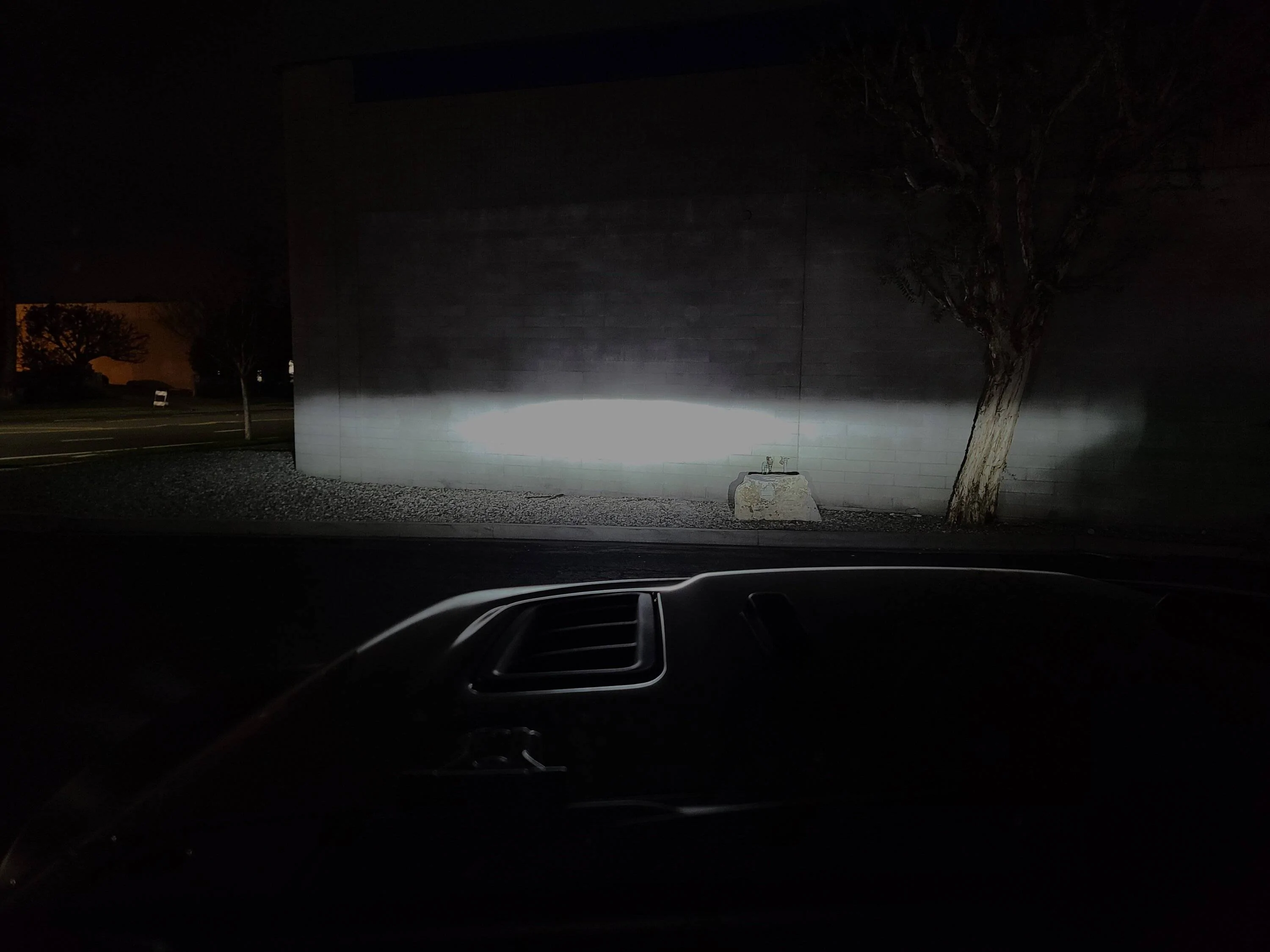

The video shows the pattern of the SV.4 and they measured the light output. Compare that against whatever information you have on the Lastfit. I haven't seen any published pattern or light output on the Lastfit.
Again, I'm running the SV.4 without the anti-flicker harness now for 3+ years on my 2018 JLUR. The beam pattern and output far exceeds even the factory LED headlights, and does it with a near perfect beam pattern that doesn't scatter light above the cutoff. I understand that everyone has a budget, but you'll really be happy with the SV.4.

Here's a picture of the SV.4 pattern from my JLUR.
Jeep Wrangler JL Halogen to LED sv4 on wall
