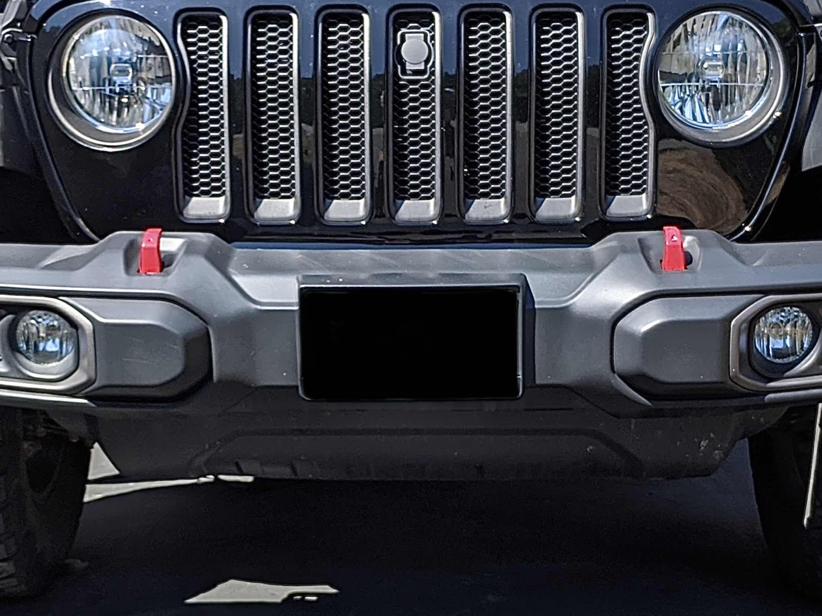

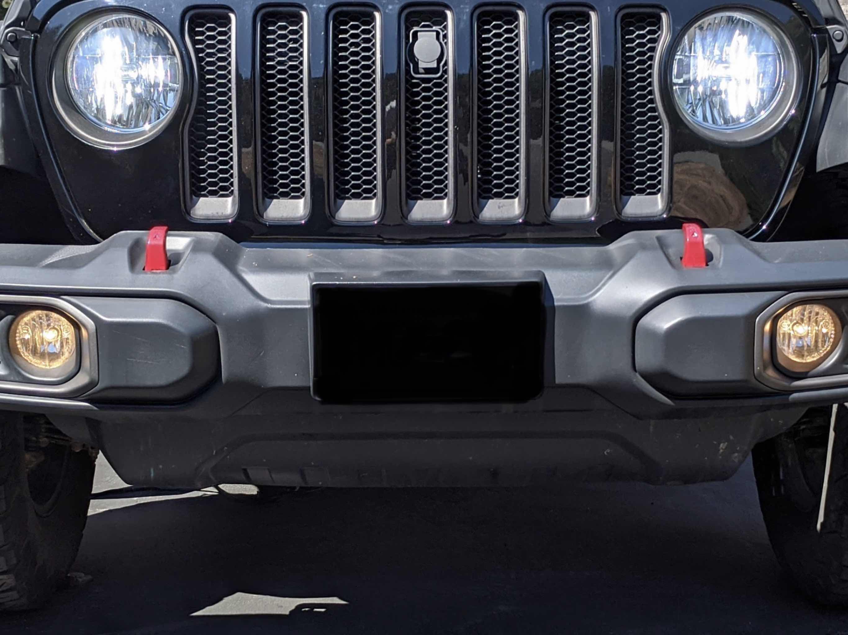

Total cost for the LED headlights, foglights, left and right turn signals in the fenders and the LED tail lights are $3600 after taxes (without dealer installation and $650 for installation)
Jeep Wrangler JL Halogen to LED upgrade 1692113217593

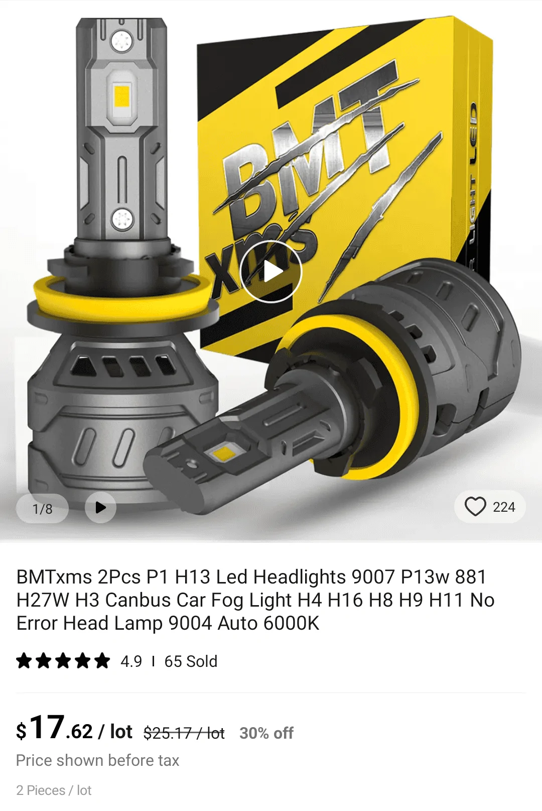

BEAMTECH H13 LED Headlight Bulb, S1 Series 10000LM 50W Quiet No Fan CSP Chips Conversion Kit Fanless Cool White All in One Plug N Play Halogen Replacement
Also it should be noted that installing these bulbs allow you to still keep your watertight headlight assembly.
I bought these ones a while back for my work van, and they are extremely bright. I don't think they're actually 30,000 lumens, but they are definitely brighter than my current headlights on the Wrangler. I actually have them in my garage still. I remove them from the work van when they changed my route.
$17.62 30%OFF | BMTxms 2Pcs P1 H13 Led Headlights 9007 P13w 881 H27W H3 Canbus Car Fog Light H4 H16 H8 H9 H11 No Error Head Lamp 9004 Auto 6000K

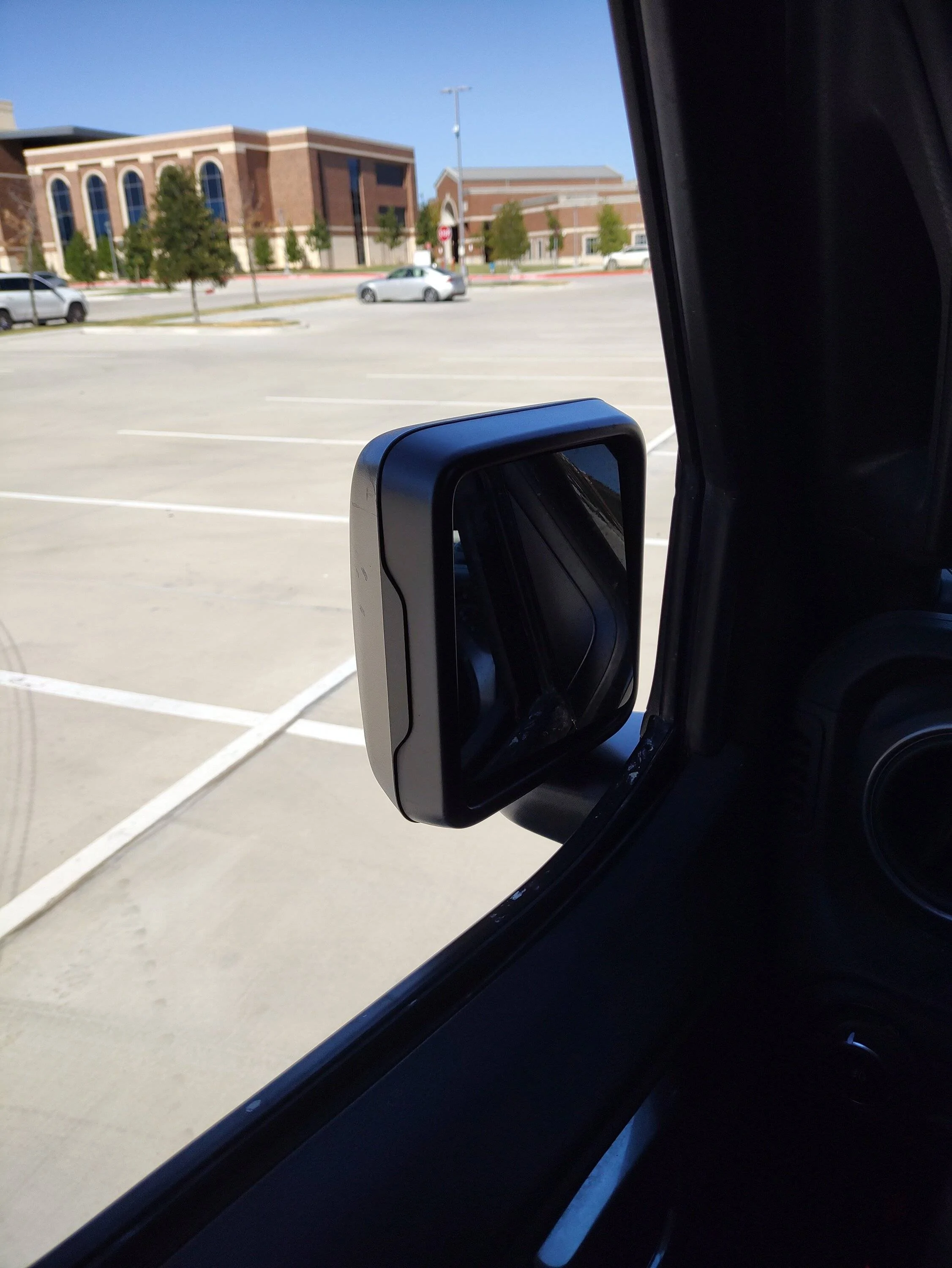

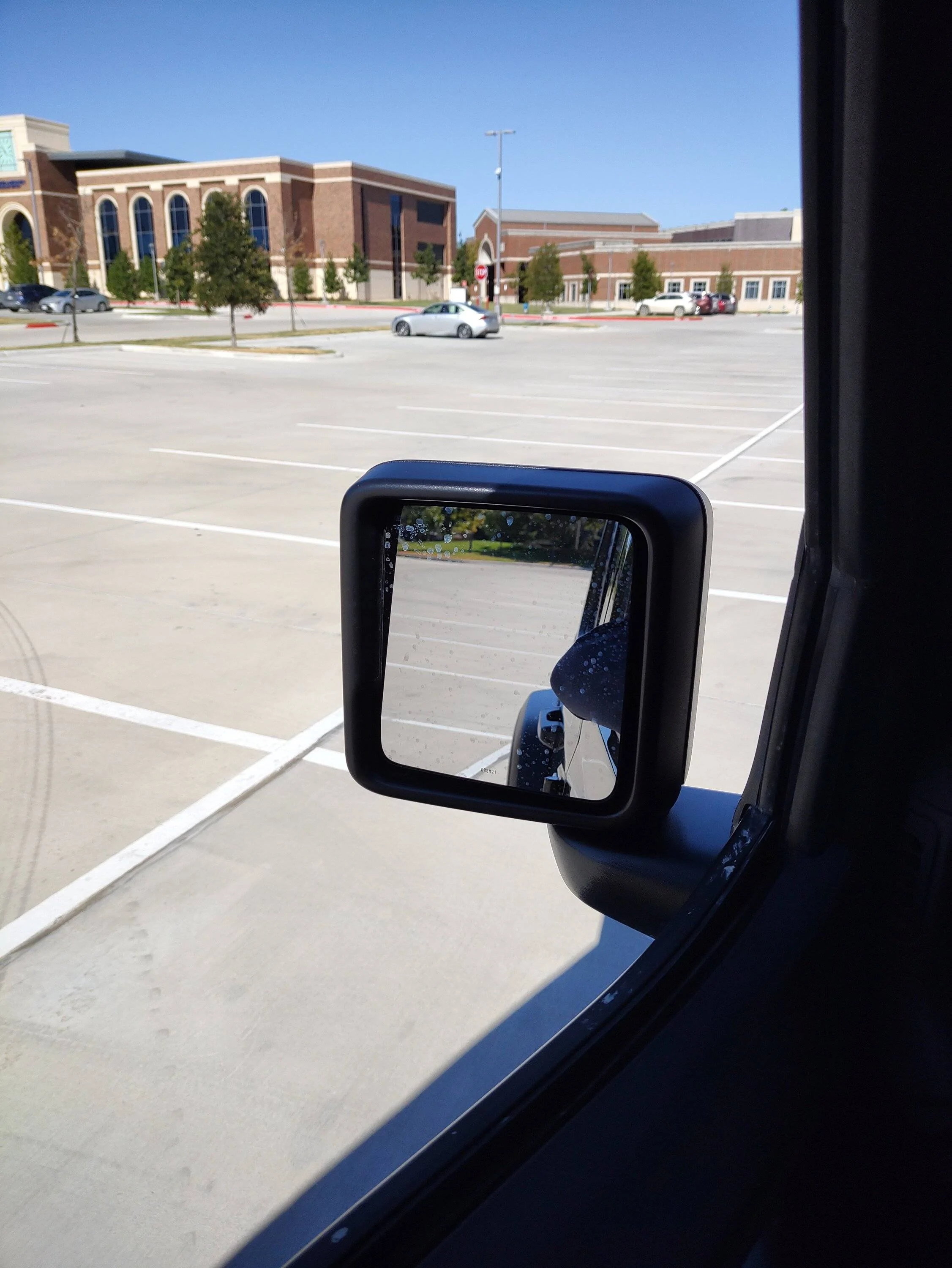

On a slightly related note, a great way to stop yourself from being blinded by the person behind you while driving at night...
Jeep Wrangler JL Halogen to LED upgrade IMG_20230815_165555937
Remove your passenger side and rear view mirrors.
Jeep Wrangler JL Halogen to LED upgrade IMG_20230815_165634903
When someone's blinding you...
Jeep Wrangler JL Halogen to LED upgrade IMG_20230815_165639029
Close your driver side mirror.
Problem solved, just make sure not to change lanes while driving like this. Also probably good idea to make sure it's legal in your state. Gotta love Texas!
