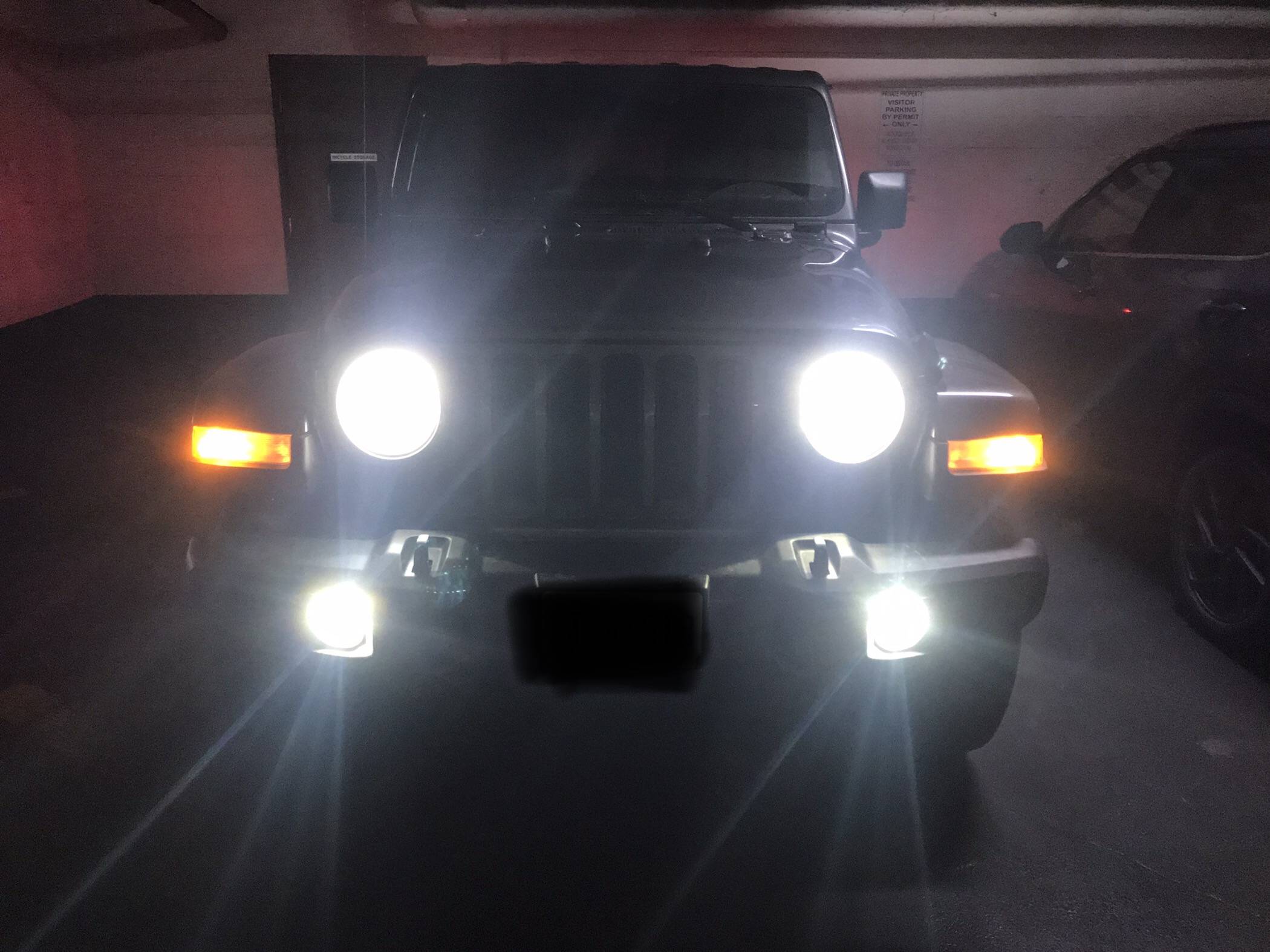

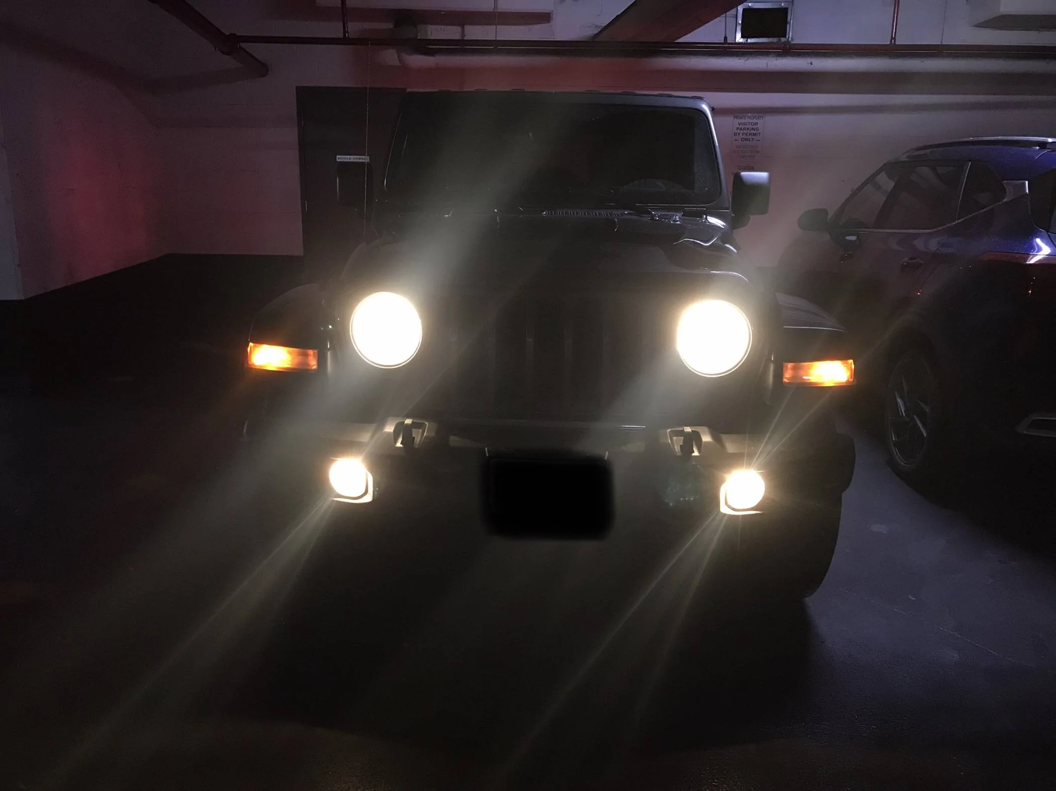

I went with the Amazon LED bulb replacements for headlights, turn signals, side marker DRL's and fog lights. I'm happy with it so far. Had them in for a month now with no complaints. See before and after pictures.
All I see is a ton more glare. Don’t be one of those people.
