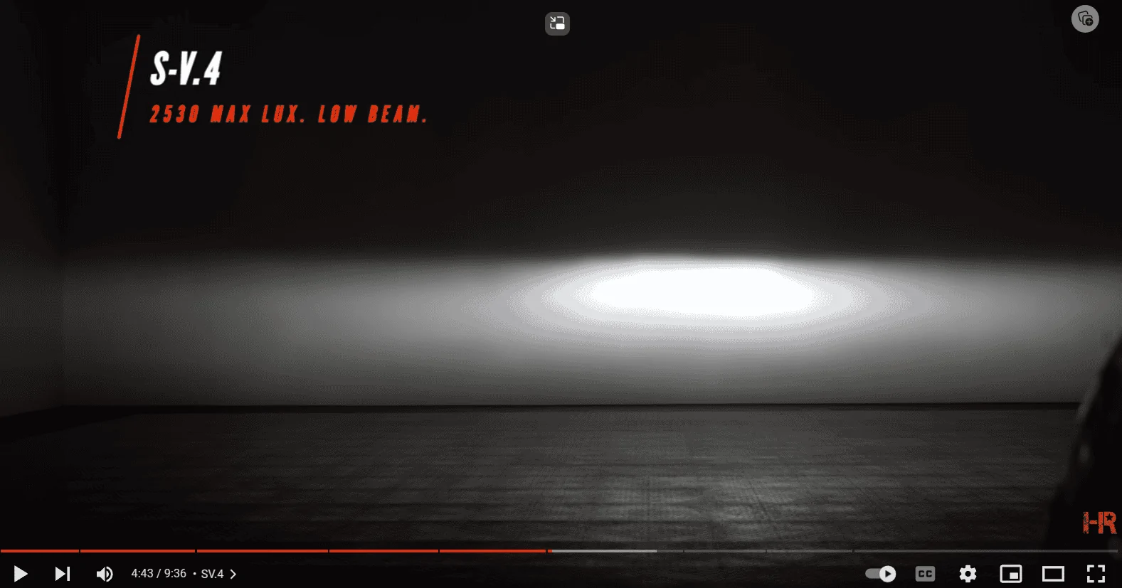

From what I've seen on these video tests, the scatter of the factory LED, above the cutoff, is more than the SV.4 in the halogen housing. The SV.4 also has a more smooth pattern with less streaking. And, of course, the SV.4 has much more light output. I was using the SV.4 bulbs as an interim step until factory LED housings became available after covid, but I just can't get myself to give up the performance and pay $1000 to do it. If the SV.4 in factory halogen housings showed some kind of issue, any issue, I'd probably jump right to the factory LED housings. But 3 years later, I'm still blown away with how good this combination is.

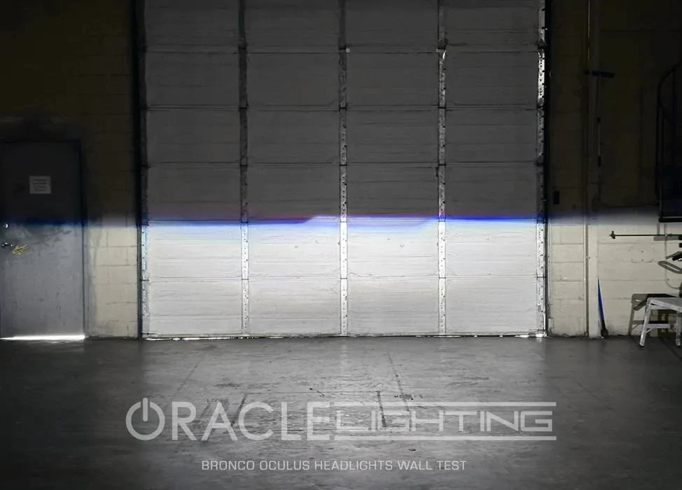

I would be willing to bet money that this isn't true. I haven't been able to find a pic of the cutoff on the Mopar factory LEDs...but if they are worse than the SV.4 bulb...that's downright embarrassing. Again, there are some pretty impressive retrofit bulbs out there but they are still miles behind purpose-built systems. For reference here's Oracle's Oculus:
Jeep Wrangler JL Halogen to LED Bronculus_Wall_Test_2_975x700
The Mopar LED should be very similar - a completely different league.

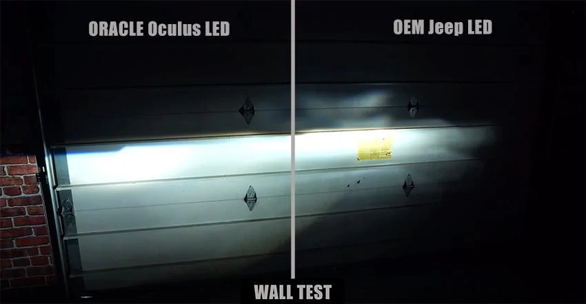

Here you go. I don't know what that artifact above the cutoff is from. But it is probably one reason people often flash Jeeps with factory LEDs.

I'll add the picture of the Oracle vs OEM LED here to keep the thread concise.
Jeep Wrangler JL Halogen to LED wall_test_1_1024x1024-2
And here's the SV.4 again, from the HR video.
Jeep Wrangler JL Halogen to LED SV4 in jeep jl hsg

Yeah see...both those projectors are in a different league than the bulb. Both have a much better cutoff with minimal bleed above - the Mopar has a little more than the Oculus - but your own picture of the SV.4 cutoff that you posted further up shows more light above than either of those projectors. And that's only a small part of the overall equation...the projectors will throw light much further and fill out the area under the cutoff much better than the retrofitted reflectors will.
