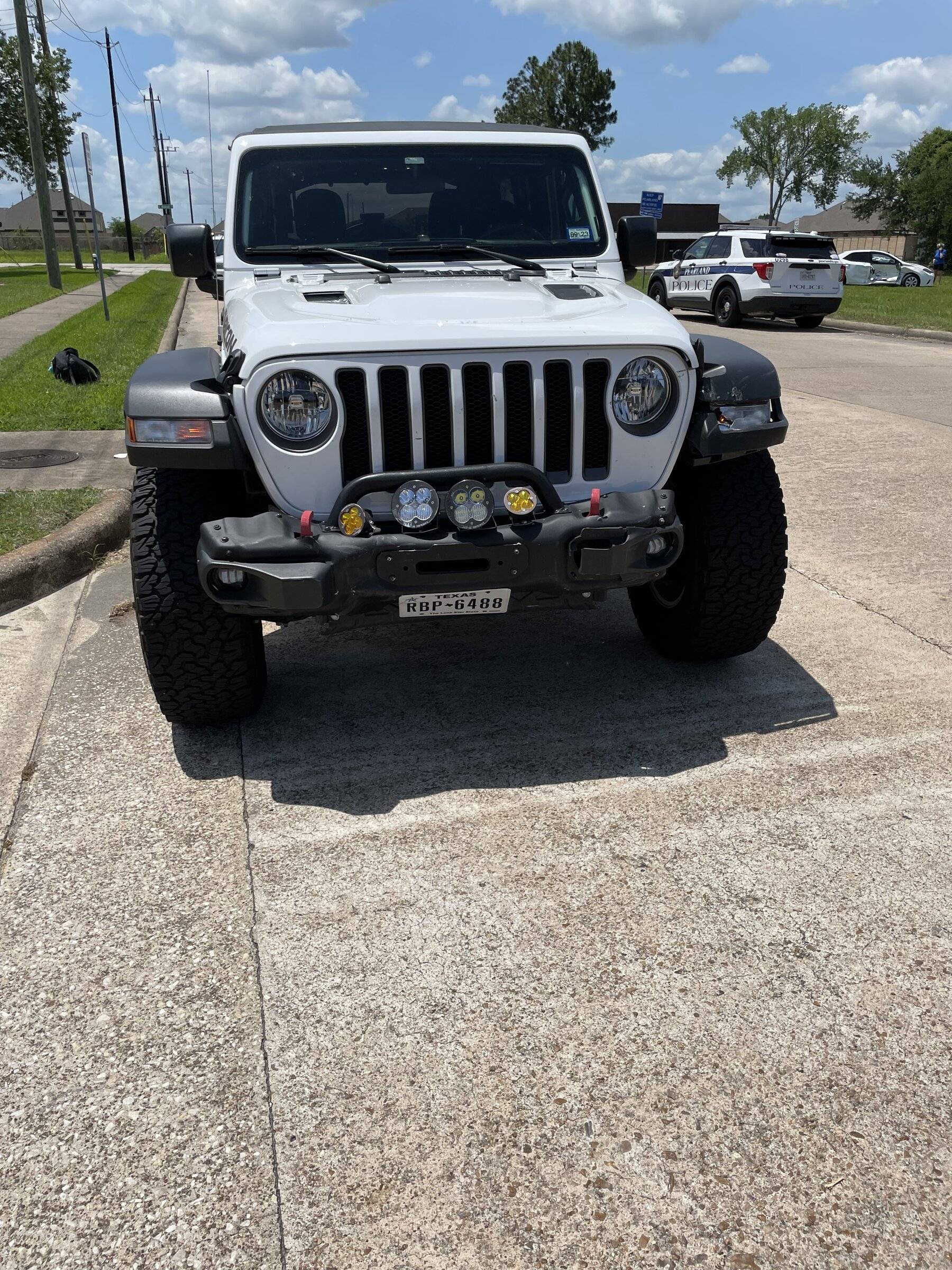

Dealer said frame replacement is likely, book time is 43 hrs so it’s well within the $35-37k number so looks like it’s fixable. Will know more tomorrow or Friday.

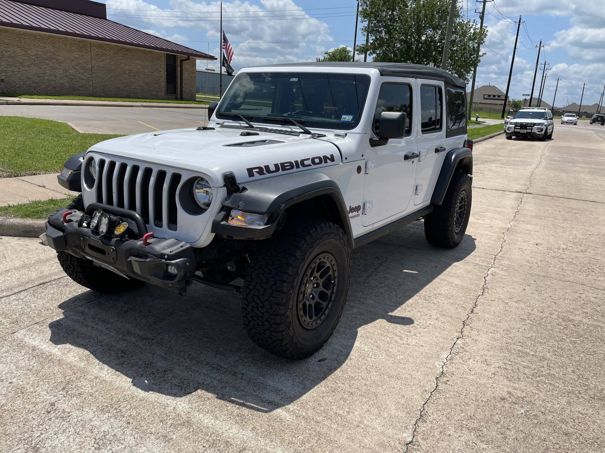

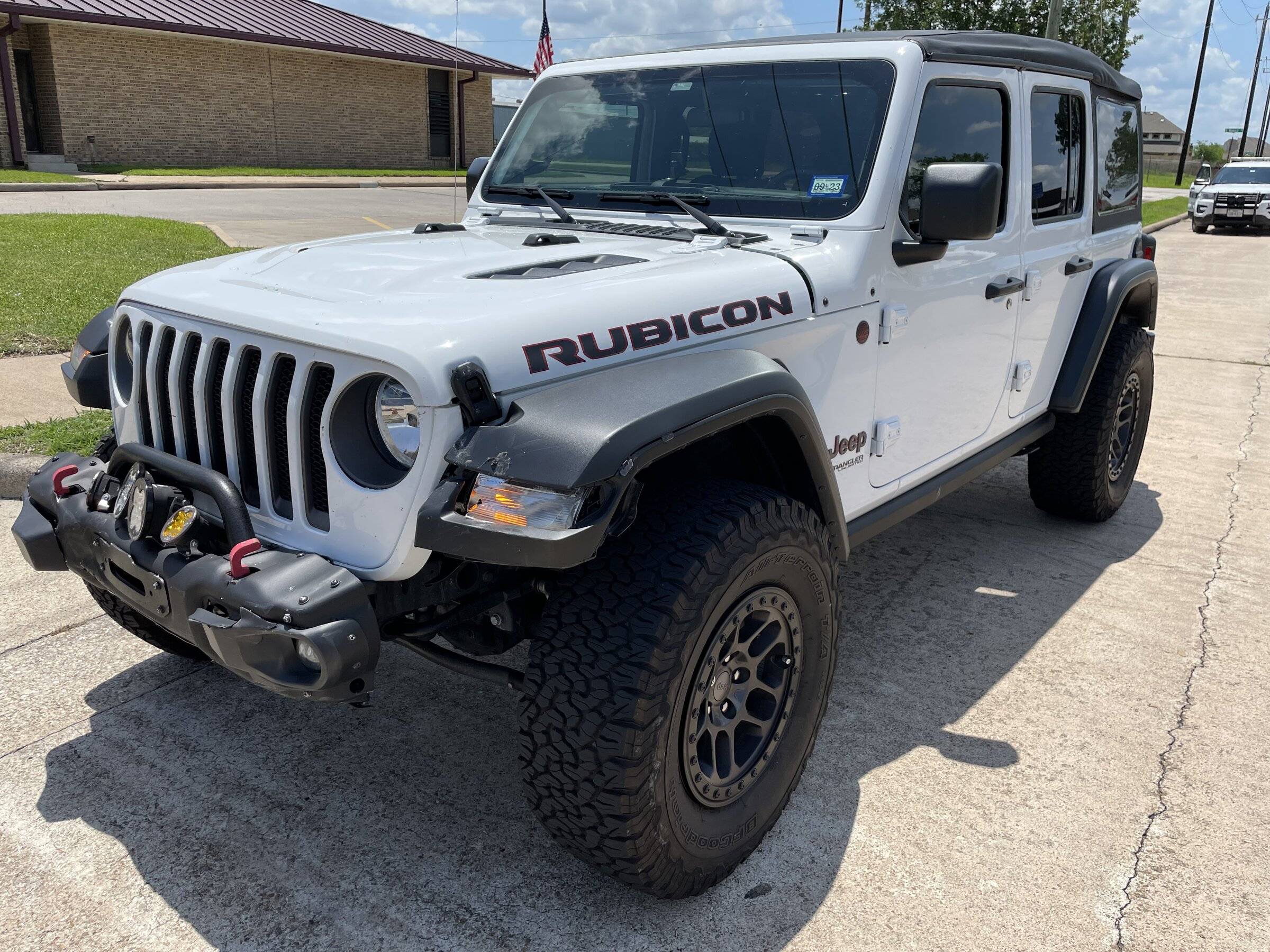

Had a 16 yr old girl run a stop sign yesterday and l T-boned her. Fairly slow at 25-30 mph but still a decent accident. Her fault and she had insurance and everyone is ok - I was perfectly fine after - she had a panic attack but other than that was fine.
Since I’m impatient waiting on insurance to get moving - do we think this is totalled? Front frame horns bent from very front to grill only. All else is fine. 2021 JLUR XR with 9500 miles so I sure hope not!
It’s going to Jeep dealer in the next day or two, but figured I’d ask here so maybe I have an idea of what to expect.
Thanks!

I’m a previous body shop owner, from what I can see I don’t think the insurance company will total it. If the estimated cost of repairs approaches 75% of the vehicles‘ value they generally total it here in Florida. Walk around your Jeep and carefully inspect all of the body seams for a uniform gap, particularly the doors, hood, fenders etc. open and close the doors, do they operate as smoothly as before? If the gaps aren’t even then it is likely that there is frame damage further into the vehicle. Make sure the shop you bring it to has state of the art frame measuring( lazer ) and straightening equipment and SAE certified technicians. If only the frame horns are bent, I don’t think you have anything to worry about.

So it’s official - I now hate Farmers. Despite the quote coming in well under the $35-37k they told me to total it out - they said their policy is not to replace frame therefore they are going to total it out ?????
