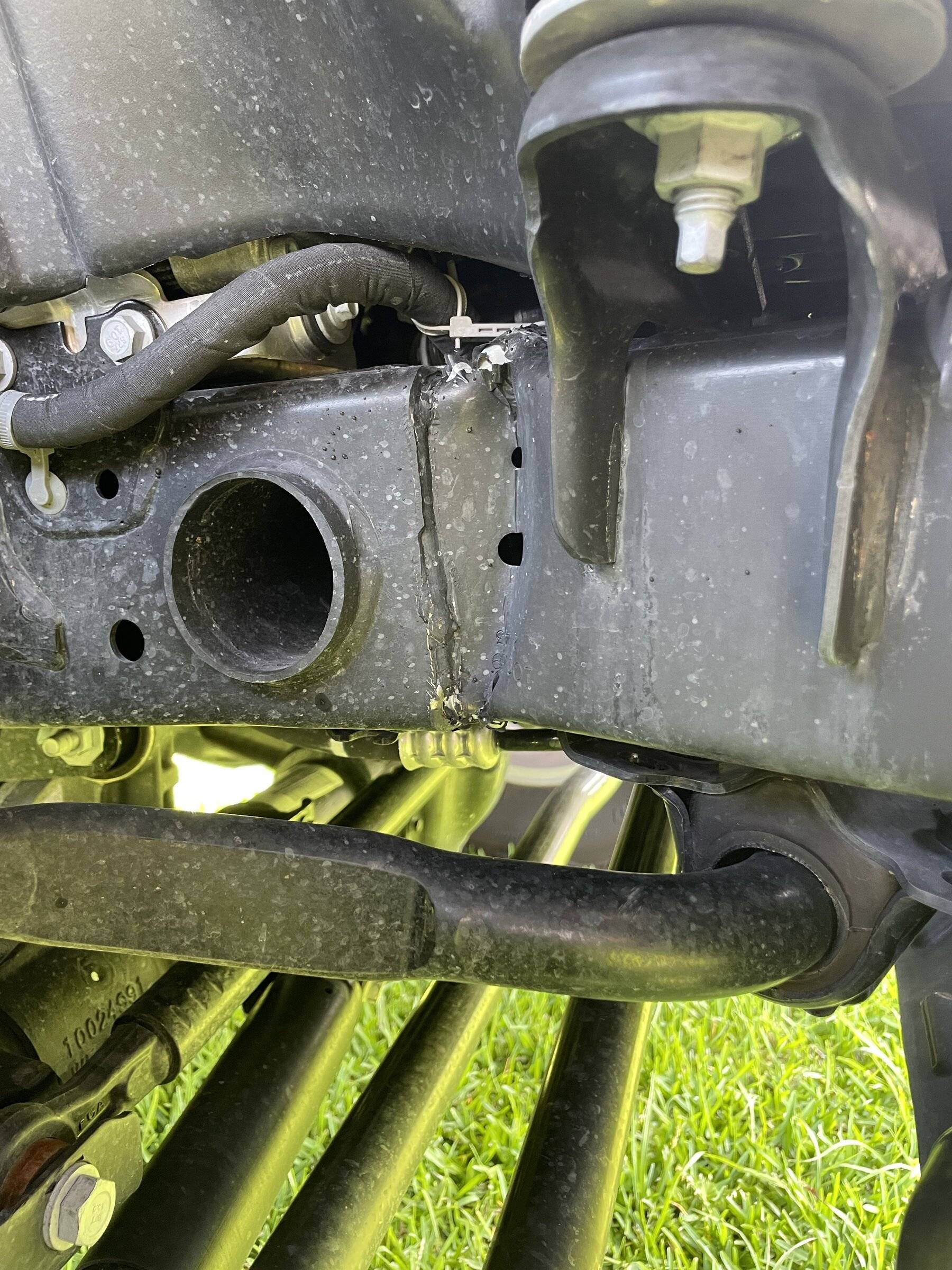

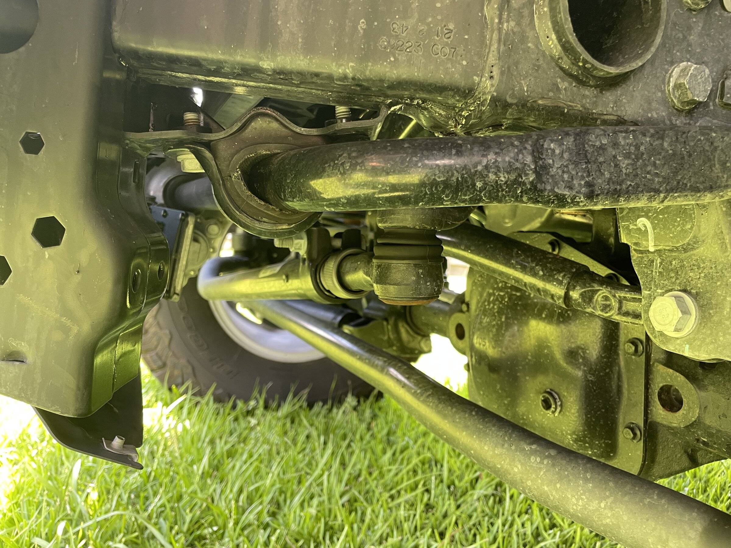

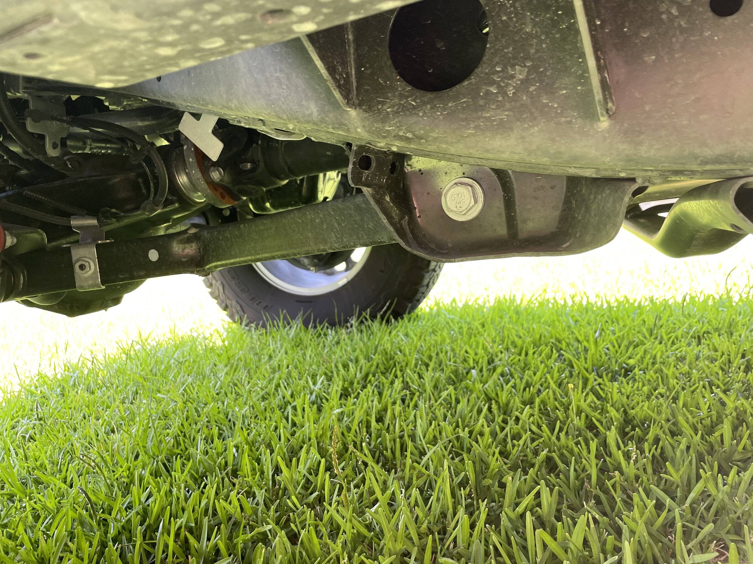

More pics. Confirmed it is just that front section of frame that is bent where it locks into main part of frame, rest all looks great. Front LCA is also buckled, so my only fear there is t-case and driveshaft. But still to get to $48-50k I think we are good.

In Texas, the decision to total a vehicle is if the cost to repair exceeds like 70-75% of the "total" value.
And you will be waiting months for parts, most likely, either way.
Frame damage, even just those front pieces, is a MASSIVE pain in the ass, and not worth the hassle to most, if any, insurance companies.
If you buy it from the Insurance company, rather than auction, expect to pay that full 75% of value...so about $37,500. You'll never sell it for that amount, as a branded title vehicle is almost worthless to 99% of the population. Needless to say, you'll never get a lender to give you the $ to buy it.

I doubt they'll total your Jeep over the damages shown. I was an adjuster for a long time and saw a lot worse get repaired. The only real concern is going to be parts availability, and the wait time for said parts as rentals cost money too. Frame horns can be straightened unless they're kinked and twisted. Pushed to 1 side is easily fixable.

I'd check w/ Benny @AllMoparParts.com for that front frame section, he's really good about digging around to source parts for us. I'd also get those longer Mopar lift LCAs too since you're going to need a new pair and will get your caster to a better place :)

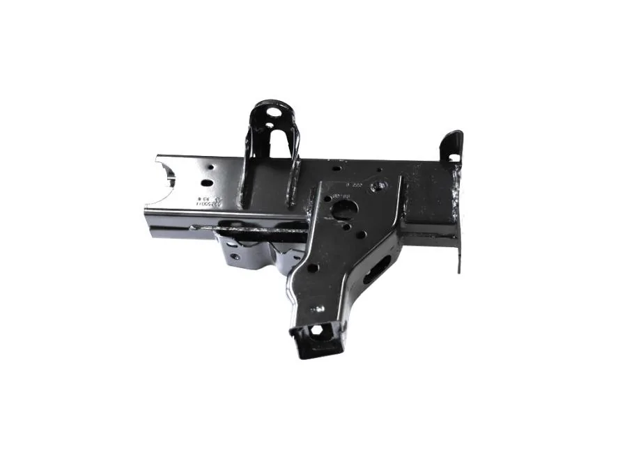

Apparently Jeep has planned for this and actually built a way to fix it at a reasonable cost. The end of the framerail is 100% replaceable - this is a part straight from their catalog - PN 68383650AA - found this morning and realized its pretty cool how they do that! Will know more when it gets transported to shop, but this is looking better for it to be fixable.
It's been common practice for decades, but everyone freaks out because they don't know enough not to freak out. Frame damage is very often repairable.

I used to be a welder by trade. Removing that and welding a replacement in looks pretty straightforward. Didn’t realize that the front frame horns were modular.
