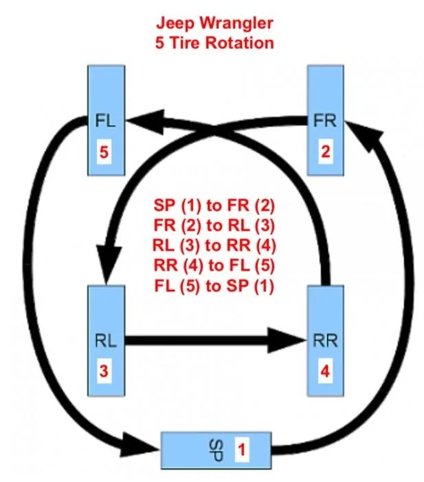

This is the five-tire rotation that I use (every 8,000 km / 5,000 miles). To make it easier for the technician at the dealer I chalk the position that the tire is to be rotated to on the sidewall. For example, on the spare tire I will chalk on FR, etc. This seems to work well. It also lets you check that the rotation was done correctly.
Jeep Wrangler JL Growing Up Five-Tire Rotation
Thank you for this! What makes this pattern of rotation ideal?
This rotation assures that the spare stays on all four locations before it goes back to the spare location.......:)
To further what Roky said - each tire gets equal time at each position before ending up at the Spare position. Because my tires are non-directional (BFG KO2s) half the time they are rotating clockwise and then on the other side of the Jeep half the time counter-clockwise, thus equalizing wear, even if your alignment is slightly out.
