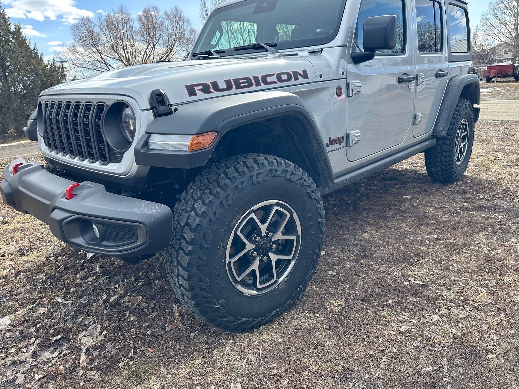

Mickey Thompson baja boss at in 255/85-17 is a 35x10 and fits perfectly on a stock wheel. some don't like skinny tires but they do really well in the real world if you can get past the looks. this was before the lift.
I’ve been a pizza cutter guy for a couple of years now, before this video came out confirming my results. No loss in performance. Fat tires are a mostly aesthetic mod now.
