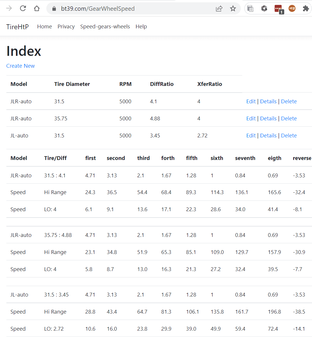

I know you don't want a calculator, buy my bt39.com/GearWheelSpeed makes it easy to compare. For example, my stock JLR gears with 37's is lower than a stock non-Ruby with stock tires.
I'm very happy with 4.88
My bt39.com/GearWheelSpeed agrees with you:
