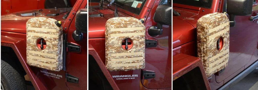

One solution to bulging is an insulated cover that prevents the sun from directly hitting the container...
Jeep Wrangler JL gas can InsulPaxTG1_zpsougeth

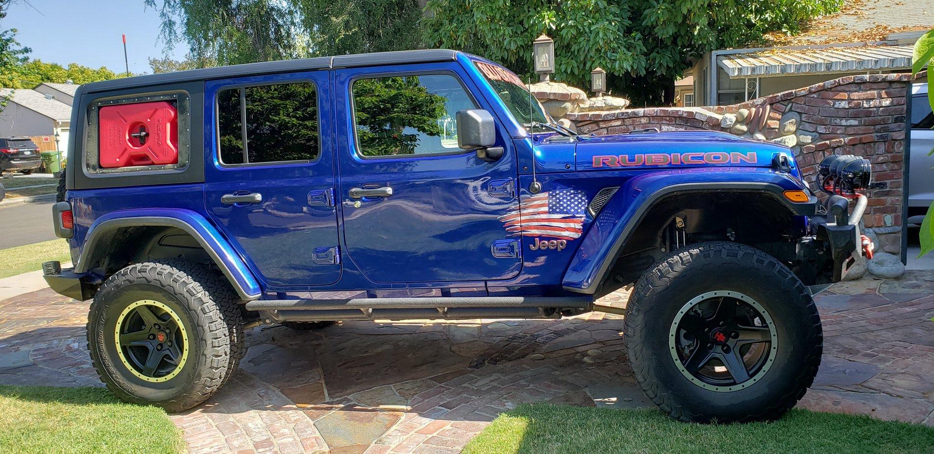

I made vented caps for the set I put in rear windows. A simple aluminum disc in place of the yellow plastic insert and put a fuel grade right angle schrader valve in. I can either bleed off pressure or quickly pull out core and reinstall it.
In town I roll with them empty and the lids loose enough to breathe. So far so good
Jeep Wrangler JL gas can jeep with flags
Vic...do you know of a Schrader (one way) like valve as you described that might automatically open for a second to vent gasoline should a certain pressure threshold be reached?
I really like the install but have 3 questions.
What became of the window that was there, could you reinstall it without too much work if you wanted to, and why no do the install on the driver's side to less effect visibility while providing proximity to the rig's gas cap?
I'm sure you had your reasons on the latter. Nice job!
Have not looked into a preset Schrader valve. It takes 2 seconds to vent them. No visibility issues, I can't look out those windows anyway. I blacked them out with template for a month before removing glass. I'm running them on both sides. Glass can simply reinstall if desired.
Did I cover everything?

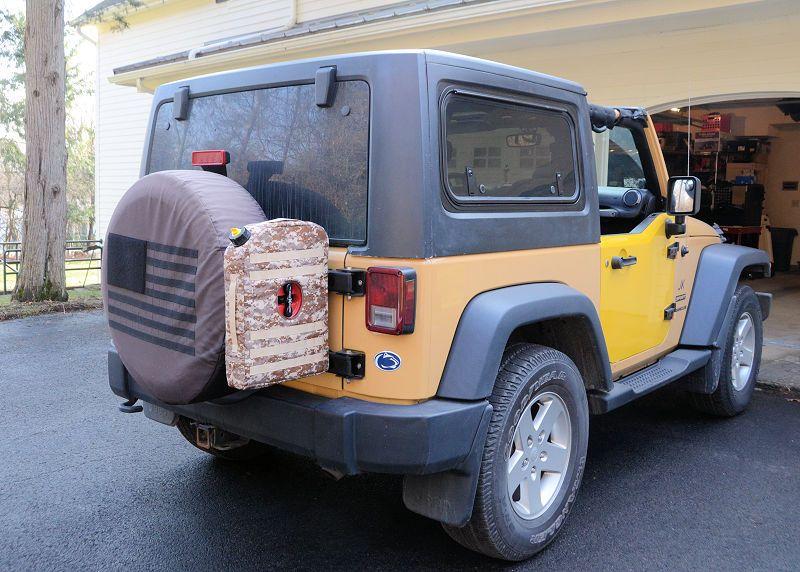

I agree, mostly I carry fuel in either NATO or US jerry cans. I do like the many mounting options for Rotopax but like you I don't like how they bloat and how they have to be manually vented regularly. That's why I'm testing these Insulpax insulated Rotopax covers.
Jeep Wrangler JL gas can InsulPaxPrototype1b_zps6fl8w54
Problem is, it's winter here so I can't really give them a good test until I head south or southwest.
