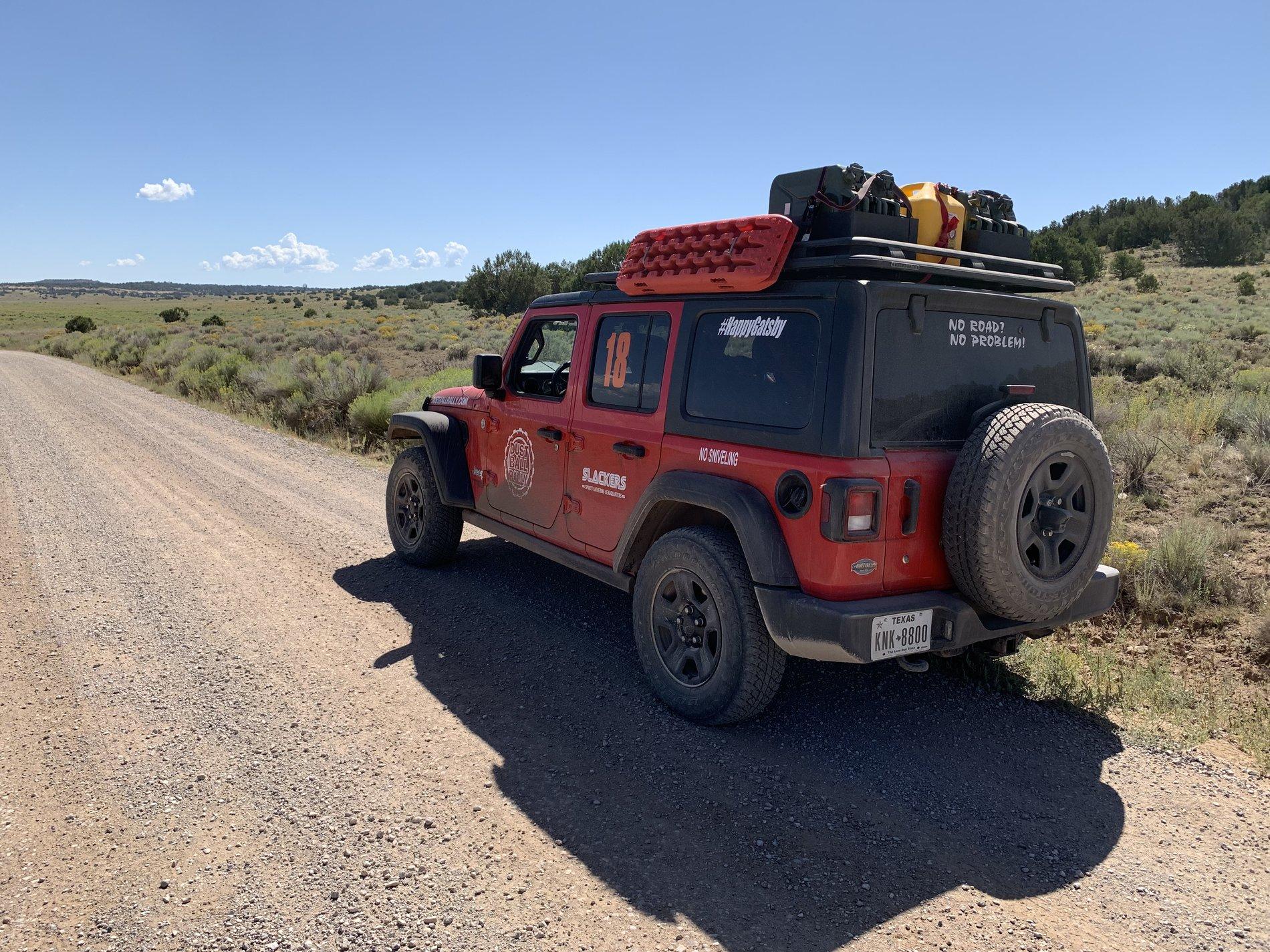

What does the "Slackers" decal say?
I looked for another pic but couldn’t find one. I’m not sure lol. It was just a part of the sticker pack the dust bowl rally made us put on.

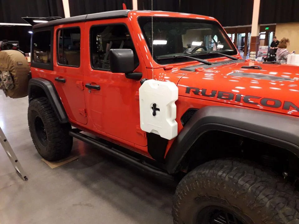

MORryde was showing this side mount at a show a few months ago. No drilling. A Rotopax is in the photo but will also support a jerry can.

I was wondering if they were going to do a JL version. I like the look of the can on the side (and prefer metal cans to plastic ones), but I'm not sure how compatible it would be with a roof cage/rack if it needs the cowl bolt holes too.

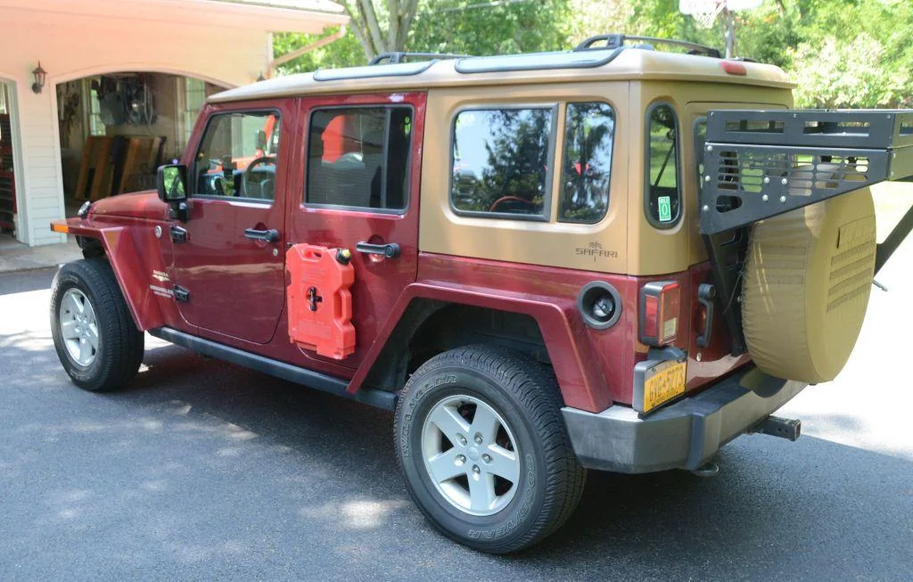

Another option coming soon from Retrofit Offroad is a door-hinge mount for Rotopax. Shown in this photo being tested on a JKU, it also fits the front and rear door hinges of the JLU/JL.
I think that putting fuel in this proximity to the passengers is probably a bad idea. Maybe best to stick to water in these areas.

There probably isn't a 100% safe place to carry gasoline on the outside of a vehicle, but best practice would be:
1. Only carry the cans when on a trip where extra fuel may be necessary. In almost all places on the road in the USA, extra fuel is rarely necessary with proper attention paid to the gas gauge, fuel range of the vehicle and gas stations along the way.
2. Cans should empty be until the "last mile". For example, if I'm making a trip from upstate NY where I live to Colorado to do some off-road exploring, the cans will be empty until the last fuel stop in Colorado before going off-road. And if the day's off-road plan won't require more than maybe half a tank, I don't carry extra fuel in the cans.
3. Cans should be emptied into the tank at the first opportunity when there's no longer a need for extra fuel.At the end of the trail before starting for home, empty the cans into the tank.
BTW if I'm using plastic containers like Rotopax, I don't like to keep them on the Jeep all the time anyway because they're susceptible to UV damage. They're in the garage until I depart on an expedition where I'll need them. I don't need to carry them "for show" :).
