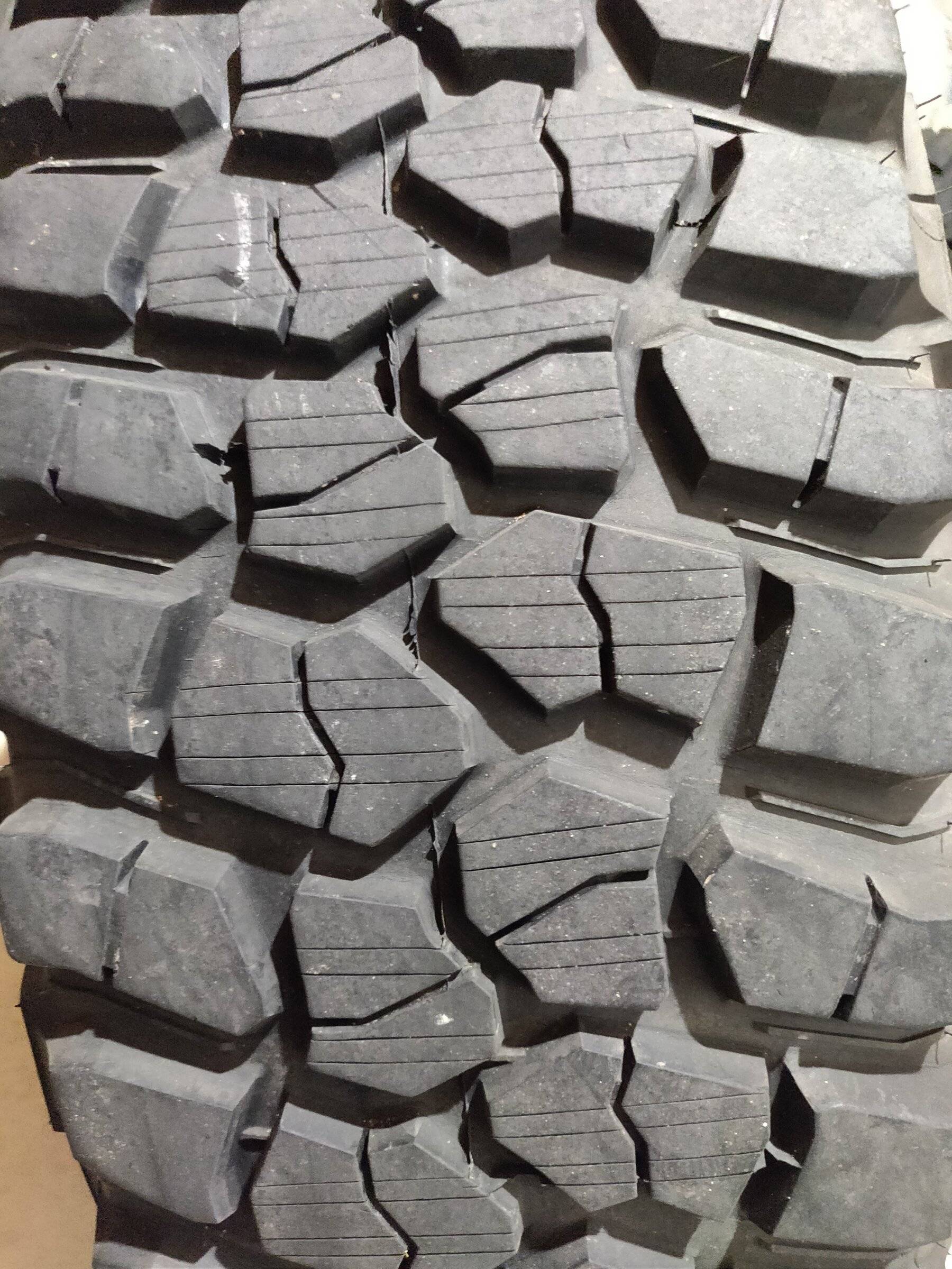

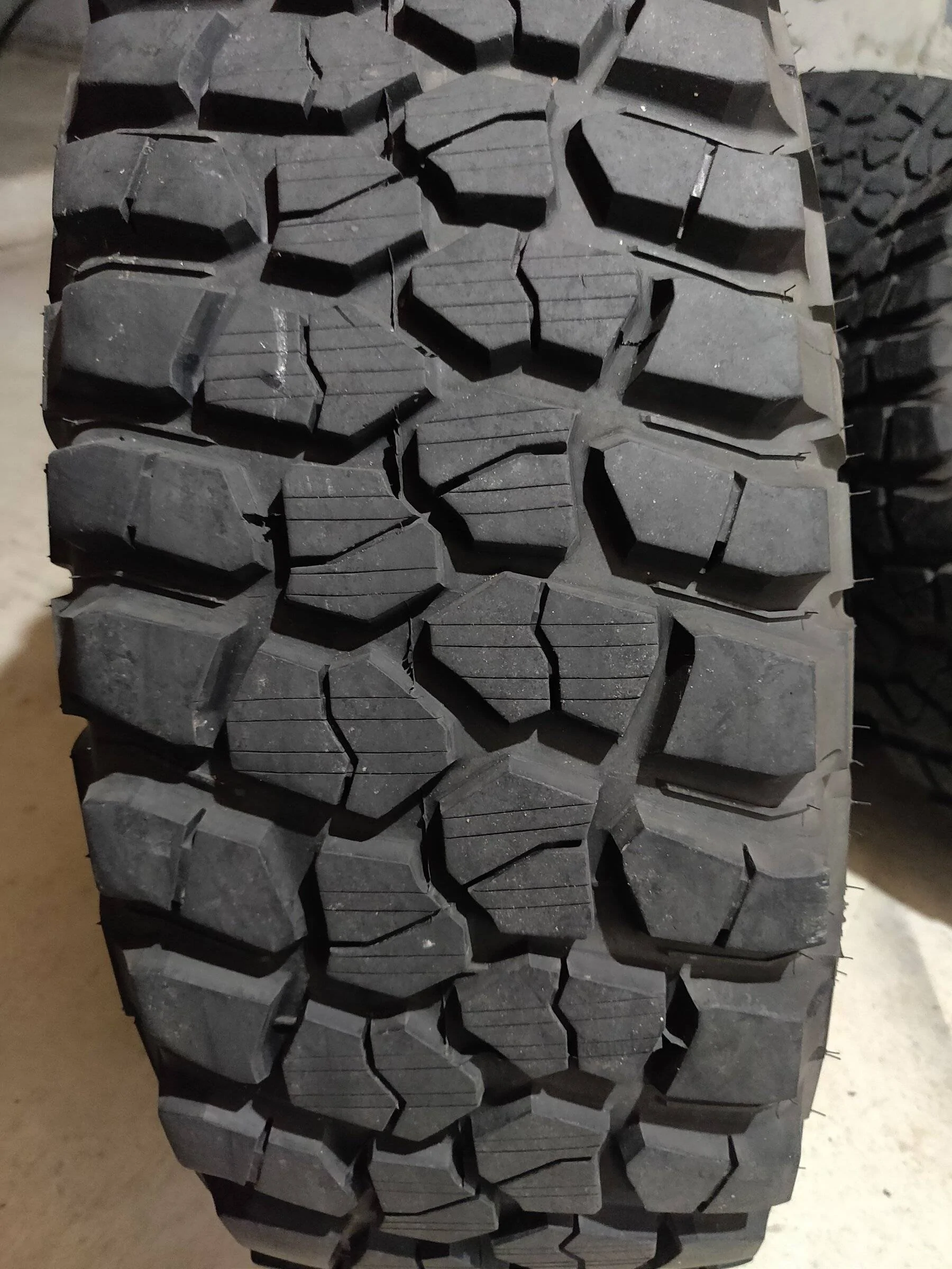

I ran a 285/70/17 KM2 on my 2012 JK Rubicon for a few winters and wasn't overly impressed with them. They did handle deep snow pretty well, but they were a real handful when the roads were covered in just a light dusting of snow.
I ended up siping the center tread blocks and that did help improve traction, but in the end I just went back to using the stock 255/75/17 BFG KM's during the winter and then switched back to the KM2's in the spring/summer.
