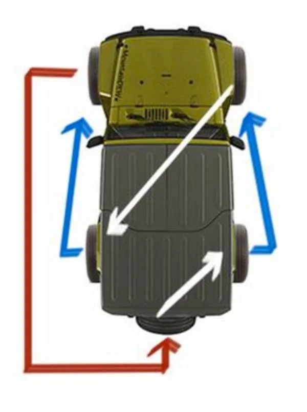

All 5 tires are exactly the same and that is why when you go in for an oil change at the Dealer...They ask...4 or 5 tire rotation( if you are having that done which you should every oil change). So it includes the 5th which helps to keep all tires evenly worn and there is a specific rotation to include the 5th.
I'm either over thinking this or under thinking this. So since I don't care about looking stupid, when I start spending more than 5 minutes over or under thinking something, figure it's best to just ask. Where does front passenger side go in this graphic? Driver side rear correct??
Yes, that's correct.
It goes in the corner in your garage. After 5 tire rotations you will have a full set to fall back on in the future.
