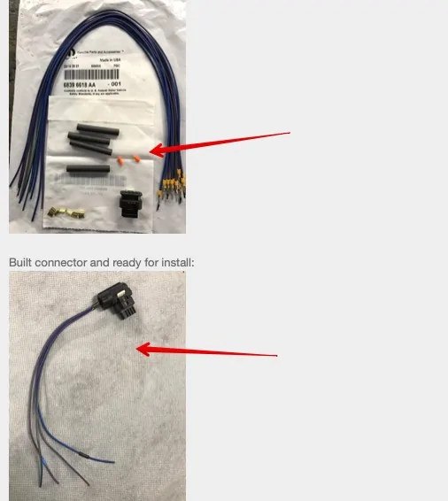

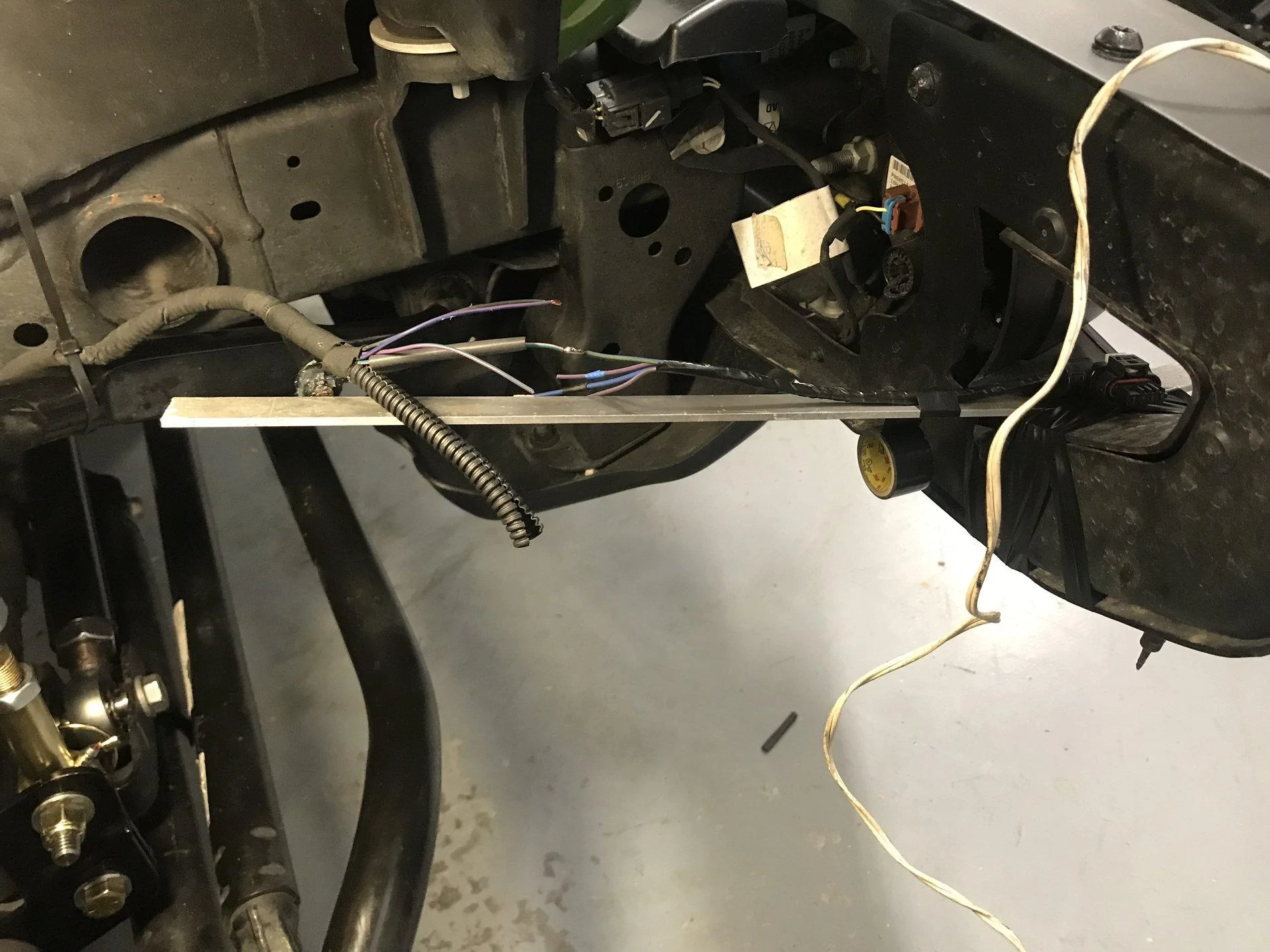

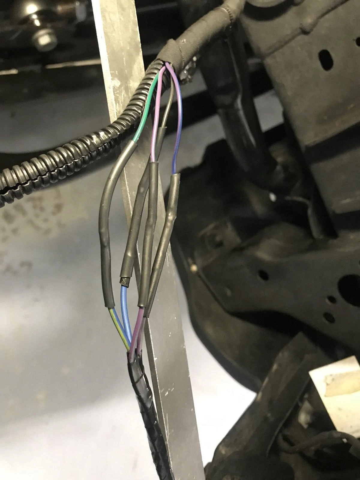

Fixed! The part number and package of parts worked great. The only thing I had to do is go with a little smaller heat shrink tubing. I think it will be a rock solid fix with soldered connections.

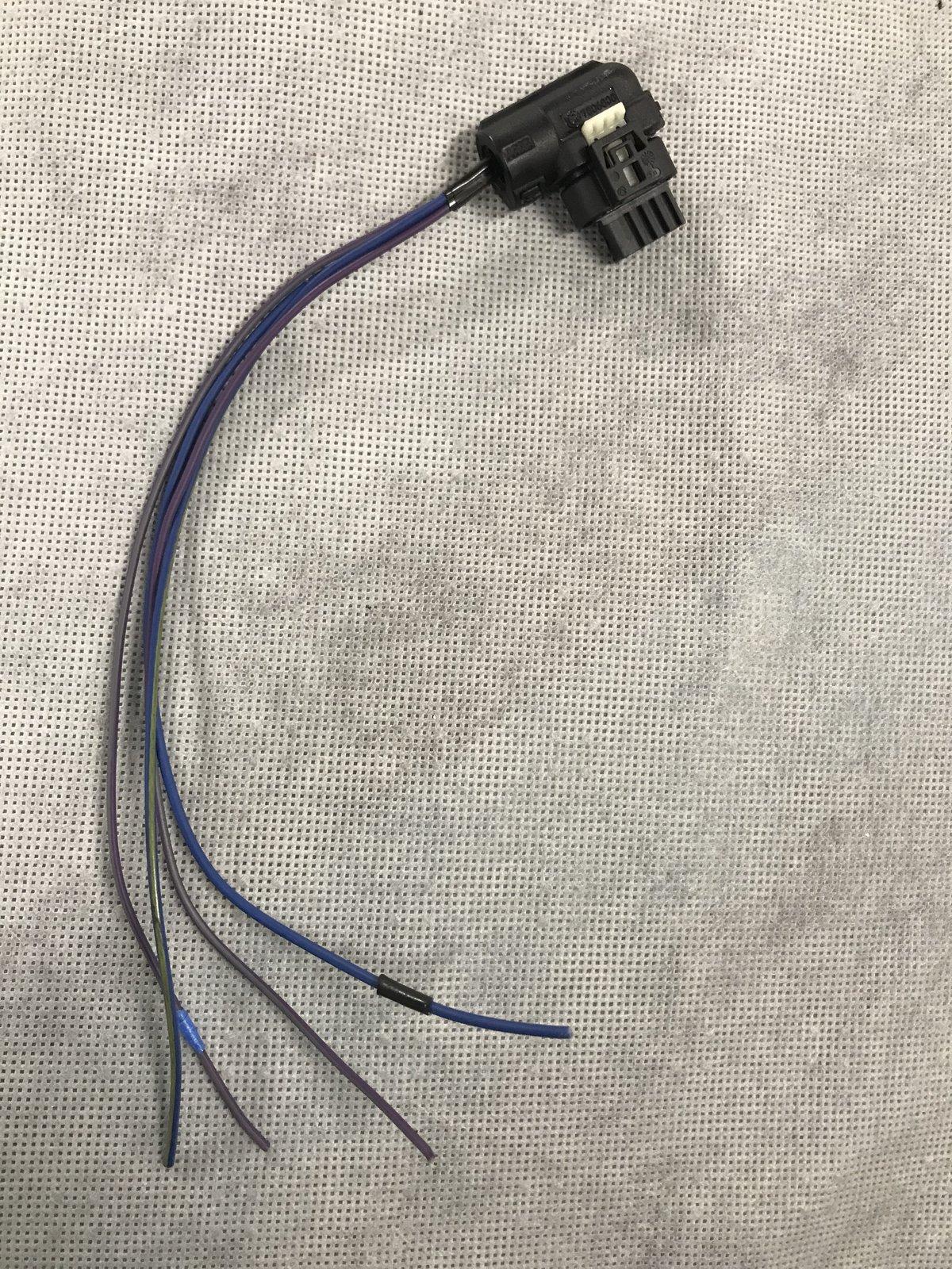

Built connector and ready for install:
I used a small piece of strap to ease the soldering process.
Soldered wires with heat shrink
Properly wrapped the wiring and installed the connector. Started it up and the code cleared right out. Issue solved!
Does the connector shown in your second photo (the one with the wires coming out at a right angle) come in the repair kit? I broke the white locking key on the connector for the FAD, which looks the same as the connector in your photo, while installing a lift kit. Thanks.
Yes it is included in the kit. Everything shown in photo #1 is within the kit.

Which one is the new connector?

Oh really? the bottom seems angle connector.
But that's great!

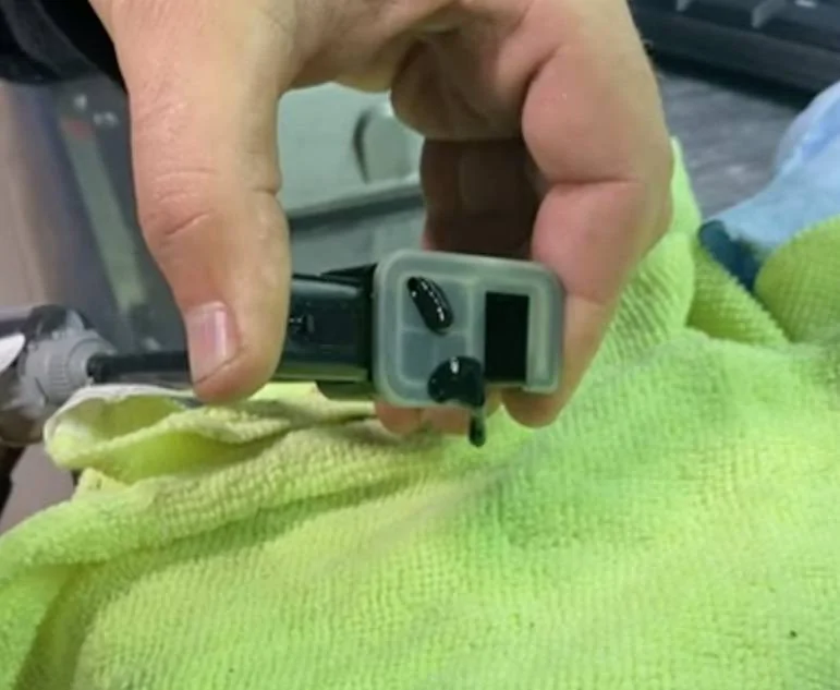

I'm getting crazy or this is a good idea? - Disable with Tazer + Wiring :CWL:
Or, should I fill the sensor with 832HD Potting Compound :devil:
https://www.jlwranglerforums.com/forum/threads/locker-position-sensor-potting-dana-44.59581/
Those fixes above are for the locker position sensor.
The ZAutomotive harness fix is for when the sensor has already failed and you get the “service locker” error and you can’t use your lockers.
The potting fix is a preventative measure before the sensor has failed, to prevent differential oil from getting inside it and short circuiting the chip.
The issue the OP had was he no longer had connection at all because of the pins being pulled out.
