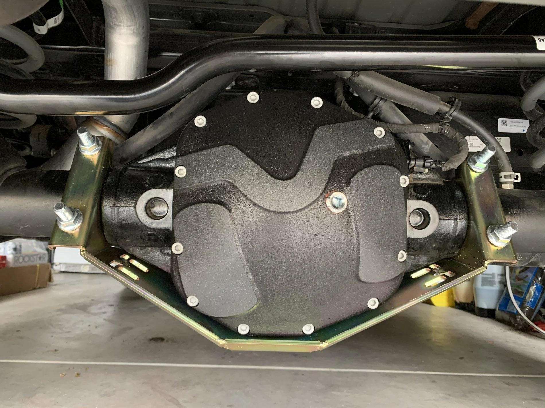

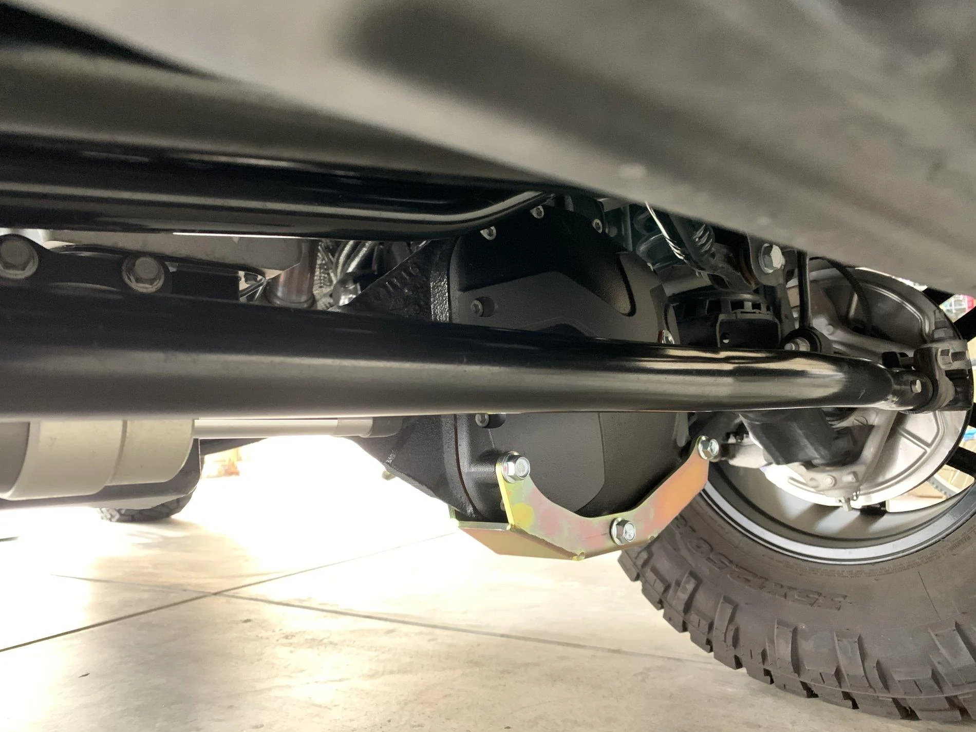

Anybody else have a slight rub on the Metalcloak front diff cover? Mine has a little paint spot rubbed off at the 1:30 position as you look at it.
Not noticed anything rubbing. Got a picture? Can you find traces of paint on anything that may rub it - track bar perhaps?
