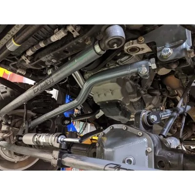

Our front track bar clears with the Motobilt diff covers and we are running all adjustable control arms on a 3" lift with 37's for the vehicle in the installed photos here.
https://www.synergymfg.com/synergy-jeep-jl-hd-adjustable-front-track-bar.html
Does it clear on an un-lifted Jeep? I'd love to believe that it will, but you can tell right away that a lifted Jeep has way more clearance between the two.

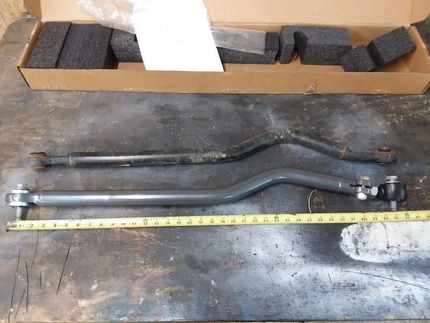

Can we get a side by side shot of your track bar with the factory track bar to see how the curvature changes?

It may not be obvious from our picture, but that Jeep is on a lift with the suspension drooped out to better show the track bar.
The video on the product page I linked does a pretty good job comparing our track bar to the stock one.

On the Synergy track bar the frame mount rod end has an angled exit and goes right into the double adjuster and a straight section of tube and then bends back to clear the pumpkin. So the end result is the bend starts closer into the pivot point and may get you more clearance.
You can see that in the picture above.
I flipped the pinch bolt around to have the nut facing forward, and not back, as that was the only area that would come close to contact with the pumpkin with springs removed doing a clearance check on the lift I'm installing.
