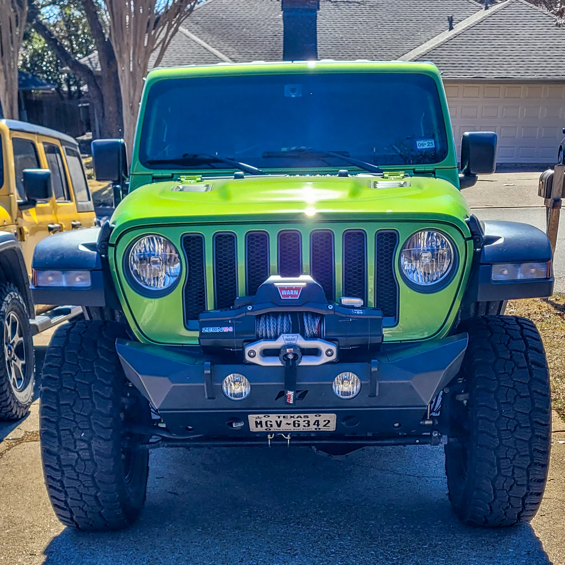

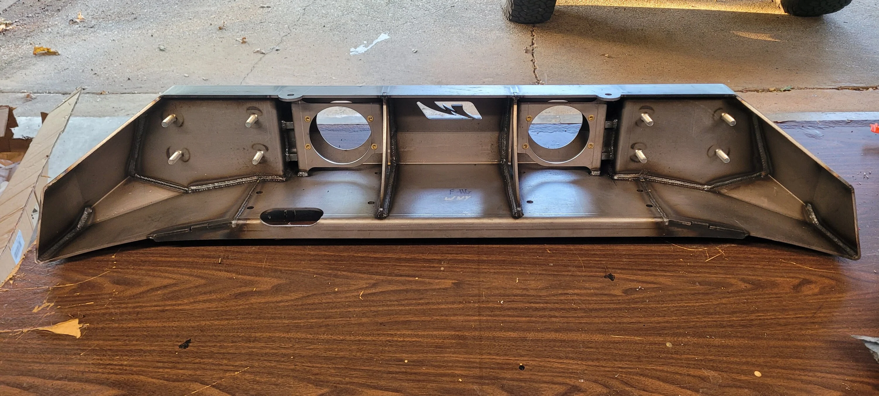

I have a Motobilt Hammer front bumper on my JLUR. I am looking for solutions to tie the front bumper mount back into the frame in such a way that the bumper D-ring mounts would be my tow bar mounting points. D-ring mounts are 3/4" steel welded front and back in the bumper. I understand the need for a true frame attachment point rather than just the frame horns for the flat tow.

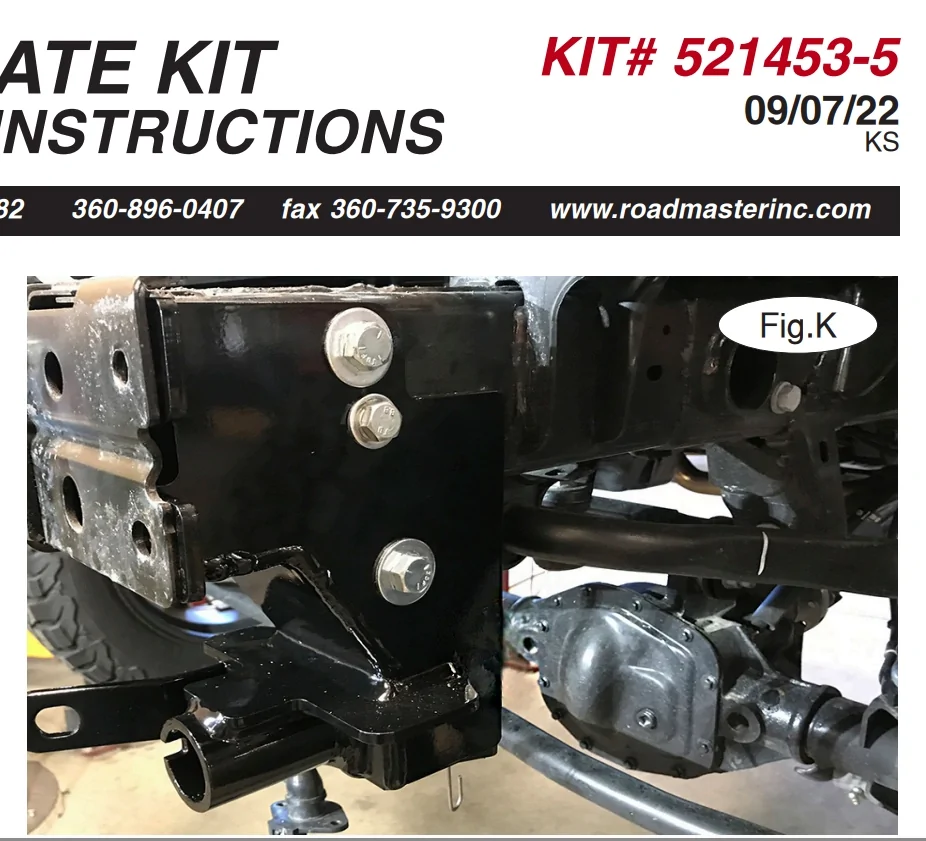

The Roadmaster Baseplate Kit 521453-5 comes with two brackets that look like they attach directly to the frame of the Jeep and provide support for the 4 hole front bumper attachment. See installation guide here.
Jeep Wrangler JL Front Bumper Horn to Frame Bracket for Flat Tow ROADMASTER FRONT BUMPER FRAME HORN TO FRAME BRACKET SET
These brackets allow for two bolts thru the actual frame, and then two through the frame horn and back up the stock front bumper attachment point.
Has anyone seen brackets like this that do NOT have the direct connect attachments below the bumper attachment plate? Brackets that just tie the bumper attachment points back into the frame? I am trying to not have to cut into the bumper/skid plate to allow for the lower Roadmaster bracket connection points. May just end up cutting holes in the skid to allow for the connections.
Bumper and skid:

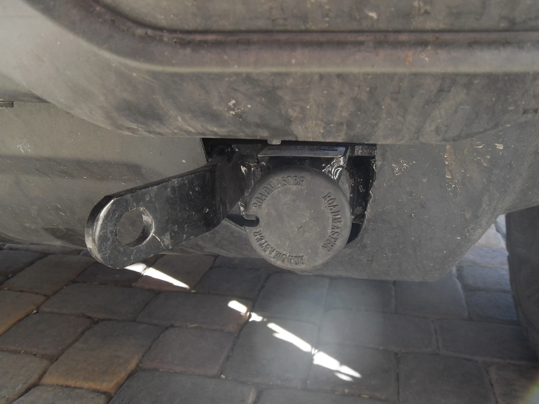

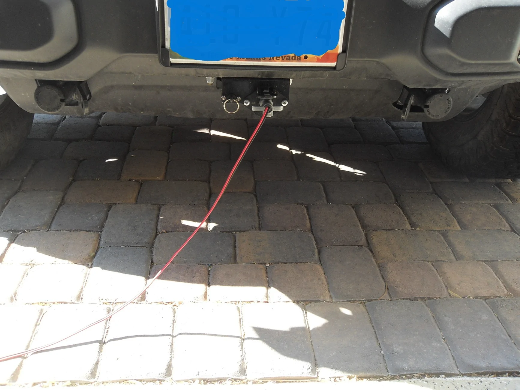

2024 2dr Willys...I installed the the roadmaster kit
1) Don't know of any other "kit" that doesn't require cutting of the "skid pan"
2) Rockhard builds a bumper that appears to be the choice of jeep owners that flat tow
https://www.rockhard4x4.com/Jeep_Wrangler_JL_Bumpers_s/483.htm
3) The roadmaster instructions come with sketches as to where and how big the holes should be made
4) On the OEM plastic skid pan: a) laid out the holes on painters tape (drew them a little smaller), b) used a hole saw and a jig saw for removal of material, c) used a die grinder with rotary file to finish the size and shape
